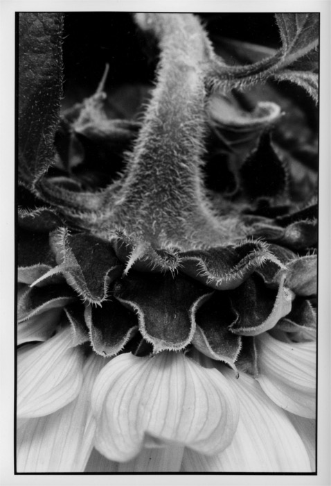

This is a scan of a print on the Bergger VCNG, developer Neutol Neutral, selenium toned afterwards.
From what I can tell over the internet that print looks really good and similar in tonality to the few examples Bergger show.
