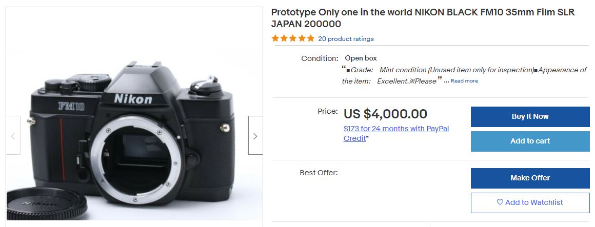

Why don't you get the FM10? It's made by Cosina but should be pretty dependable since it's mechanical. And if you paint it black you are the 2nd only person who have it :D:D
