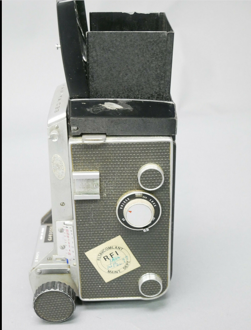

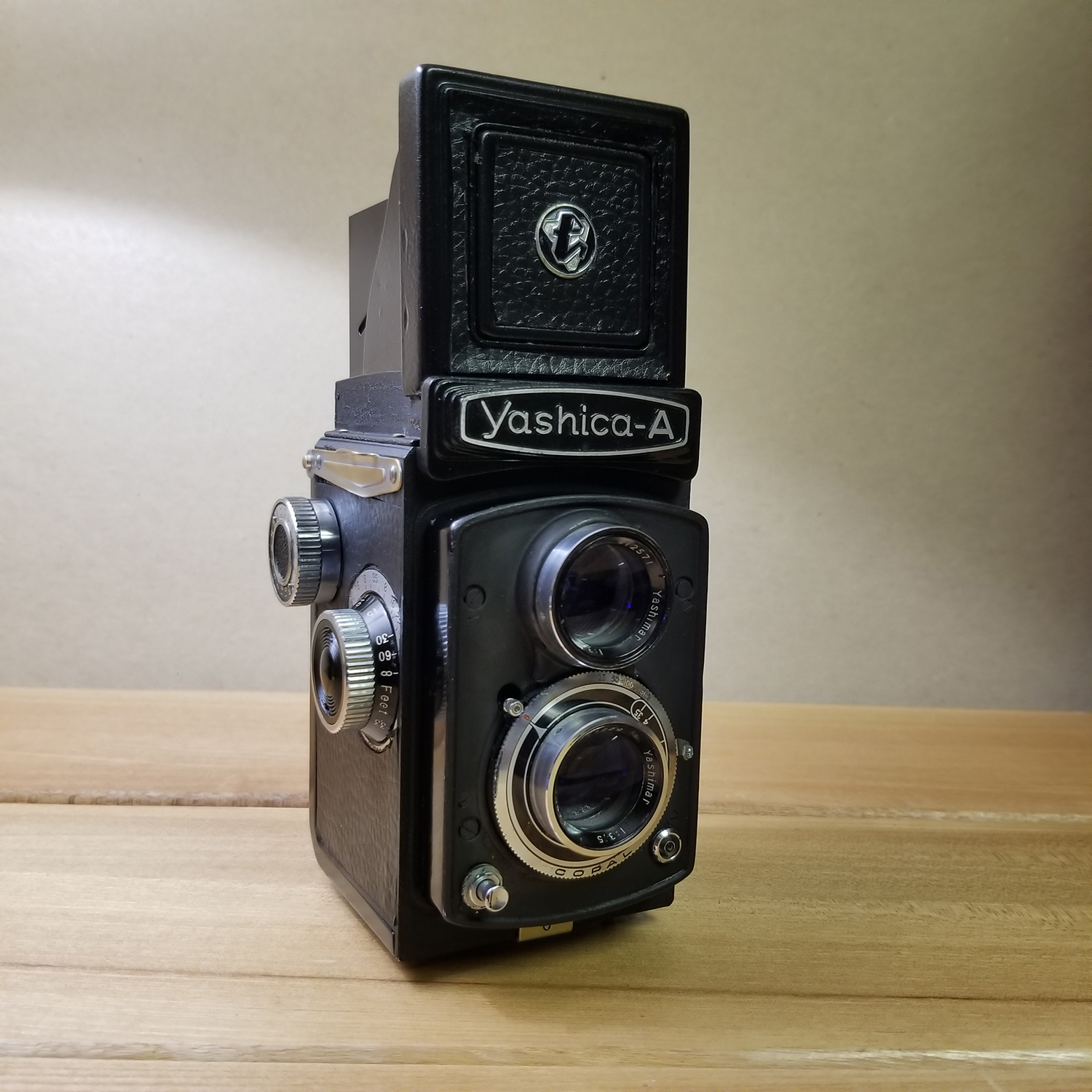

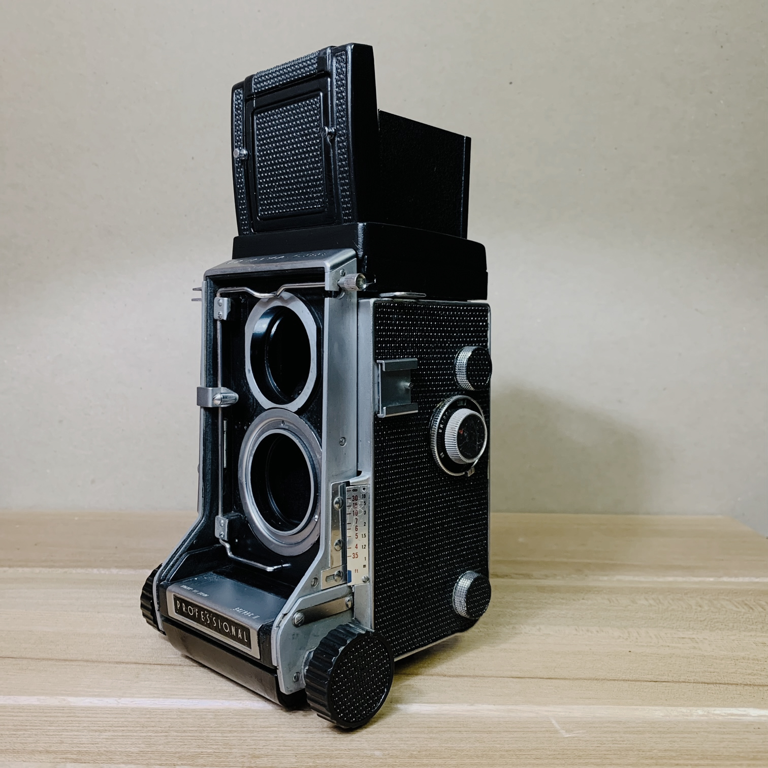

Ive restored many cameras. Painted and also redid the leatherette. I mainly use Acrylic paint. It works great, esp on faded Leatherette.
But If the leatherette is cracked or pealed half off . I usually just strip it all off the camera and redo it. You can buy faux leatherette with
an adhesive back. I get mine on Amazon. I just posted these pics in another thread.. Here's a Mamiya C33 I just painted the other
night. The third pic is Yashica I stripped all the leatherette off and applied new.
Before and After
