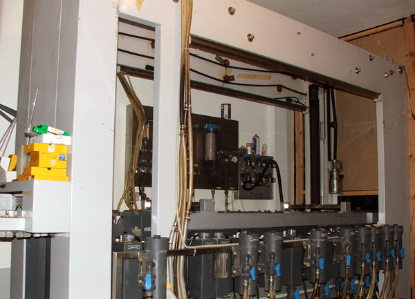

..for Ian & those other tech heads interested
..the attached is a snapshot of the dr5 processor [bad as it my be].
It is one of a kind made to my spec's. It is computer driven and able to be completely controlled by the front panel once the film is loaded. ..it's basically a manual automatic. The average roll [example = scala, FP4] is 2.75 hrs dry to dry. The processor is 18 tanks long. It has 4 lifts and 2 transports.
Though I don't process film as it comes in anymore [since last year], I can run 80-100 rolls a day if I had to. My colleagues call me crazy but the image quality is well worth the sacrifice. ..most of my clients would also agree.
dw
Ian Grant
Aug 2, 2004
23,256
West Midland
Thanks David, I'd seen similar photos before but it shows why it's unrealistic for any one to think about competing at a similar level. It just wouldn't be viable.
Ian
