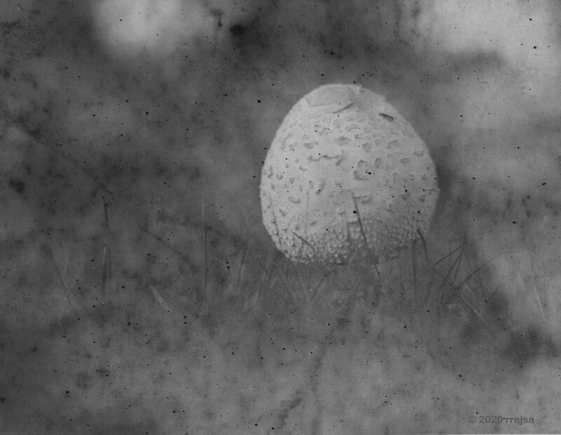

@Zathras I tried using film that expired in late 70s, but before loading a roll into my camera, I decided to waste one and opened it up. As I was inspecting it I noticed that the emulsion was chipping with tiny particles falling off. I decided that I don't want this dust inside my camera and threw it away. This was some kind of a soviet film, and I'm sure its quality was worse than Kodak's, but still...
Fortunately, @Bormental experience isn't the norm; usually, even 50-60+ year old film is physically okay, though it's very likely to have significant fog if it wasn't stored frozen for at least most of the time.

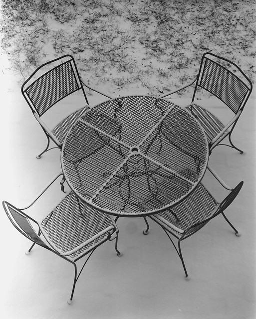

Snow on Wrought Iron by Nokton48, on Flickr
Sinar Norma 4x5 210mm f5.6 Nikkor-W Tri-x expired filmpack D76 1:1 8x10 Arista #2 RC Omega DII 180mm Componon Multigrade dev
