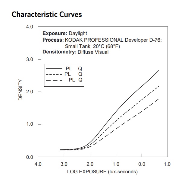

Please let me tell a trick... I don't know if you use arbitrary exposure units... we may make the necessary calculations to have real H Lux·second units to get the ISO rating...
We may measure our Lux·second exposure easily by measuring light power with a cheap ($10) lux meter, then we make the exposure with the (digital) exposure timer in the enlarger to nail a second... later we can compare with the TMX datasheet graph that has ISO 100, by overlapping the curves you have a good estimation of the real ISO.
0.0H is 1 lux·second (10), the bar over the number says that is a negative number, 2.0 with the bar over it means 10-2.0, this is near 0.01 Lux·second...
