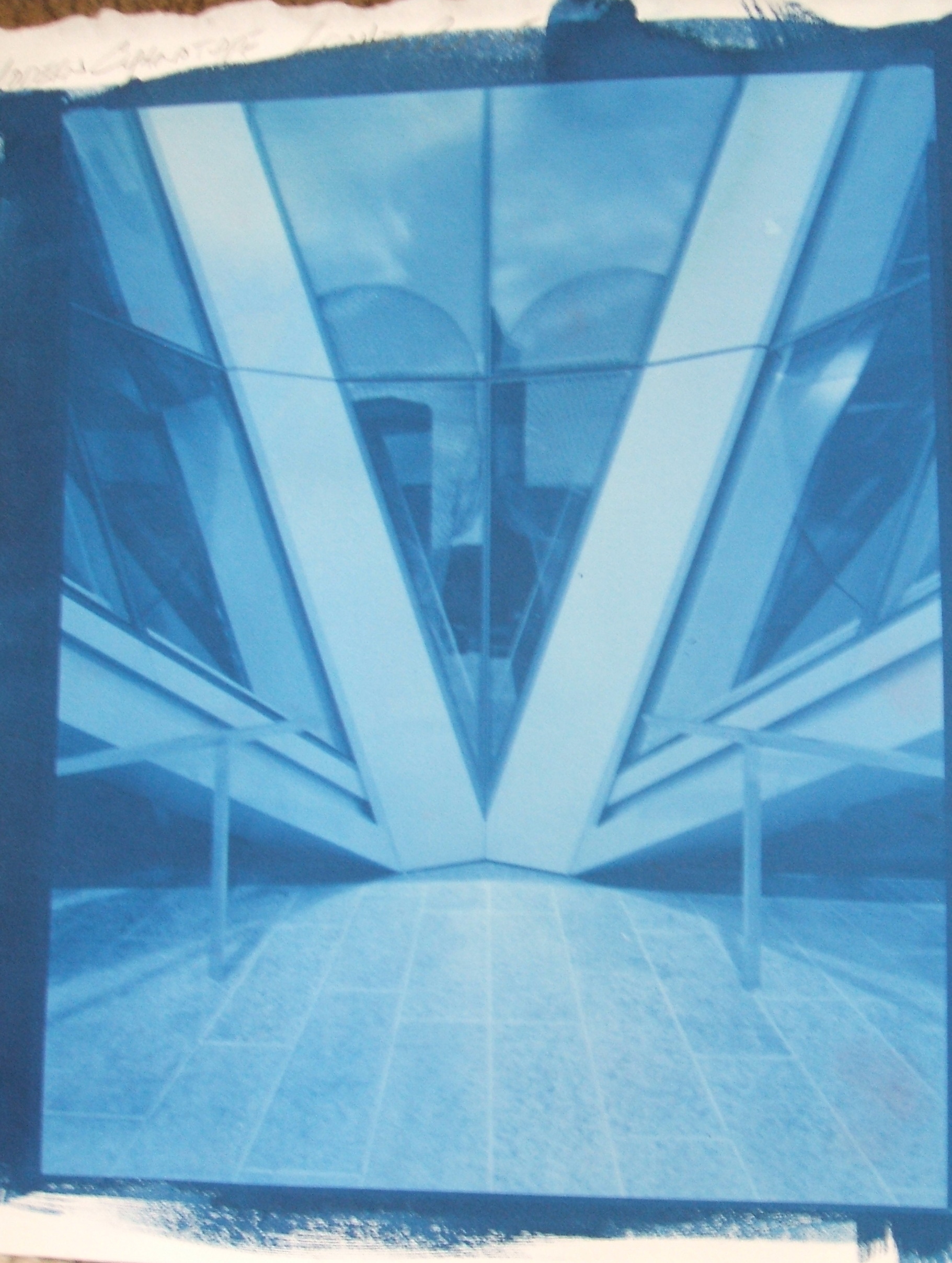

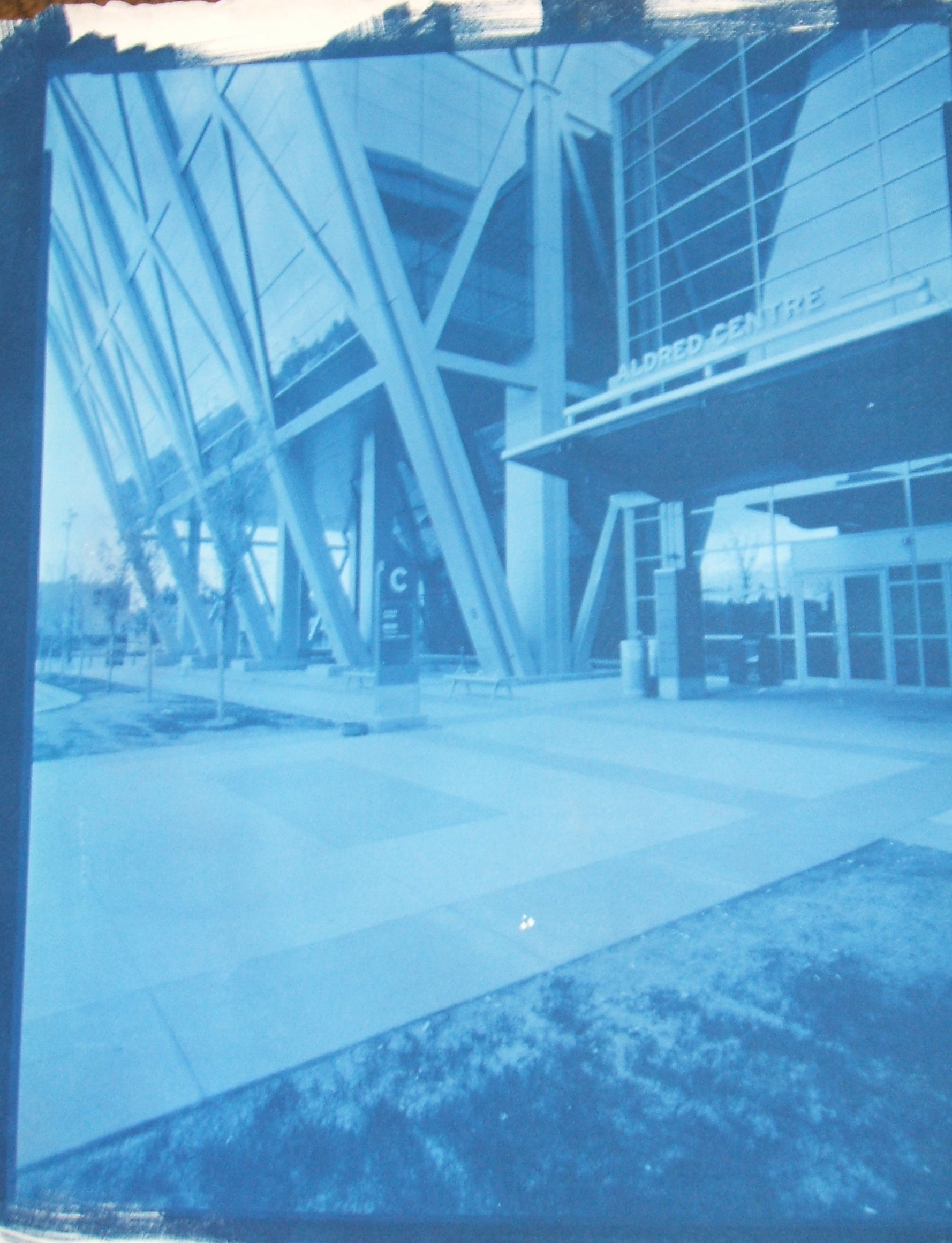

a couple of cyanotypes from negatives, which I have made using the 8x10 Titan. Film was FP4+, exposures in the 30-45s range.

Especially like the first one, Fred!
Not using mine right now. Will get back to it when my cast comes off in September.

thanks, I also like it myself, I thought it was a need trick, in that there is no trace if the tripod and camera itself in the picture, though its a glass and steel building façade.

Nice work with the 8x10 camera, I just wanted to say something about your cyanotype negatives: I think your negatives are a little thin for cyanotype, because the contrast is somehow lower than what you should normally get. What film / developer / development time combination was that? Cyanotype usually needs something like 1.5-2x the development time compared standard silver gelatin...

Thanks Loris, yes they are probably a little thin for cyanotypes, I generally do platinum/palladium prints, and the negatives should be fine.
The film was Ilford FP4+, tray processed in Pyrocat HD 2:2:100 dilution for 14 minutes @20C. I would probably go with 16 minutes, next time I am thinking of cyanotypes, or salt prints, but they then get a little thick for palladium.
