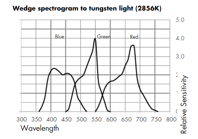

To beging to answer my own question, and quoting the datasheet:
HARMAN Phoenix 200 is an experimental C41 colour film and the first ever made by HARMAN Photo. As such it has characteristics that make this very different to the more traditional, established C41 colour negatives films. In addition to the risk of occasional coating anomalies, this film does not have masking dyes and limited antihalation incorporated in the base layer. This means that striking halation effects around bright light sources and reflections are possible. In addition to its atypical colour rendering, this film has a distinctly analogue look when shooting certain scenes and colour palettes
We'll have to wait for some samples, but unless spec sheet is intentionally selling this film short, this is not even Orwo NC500 level.

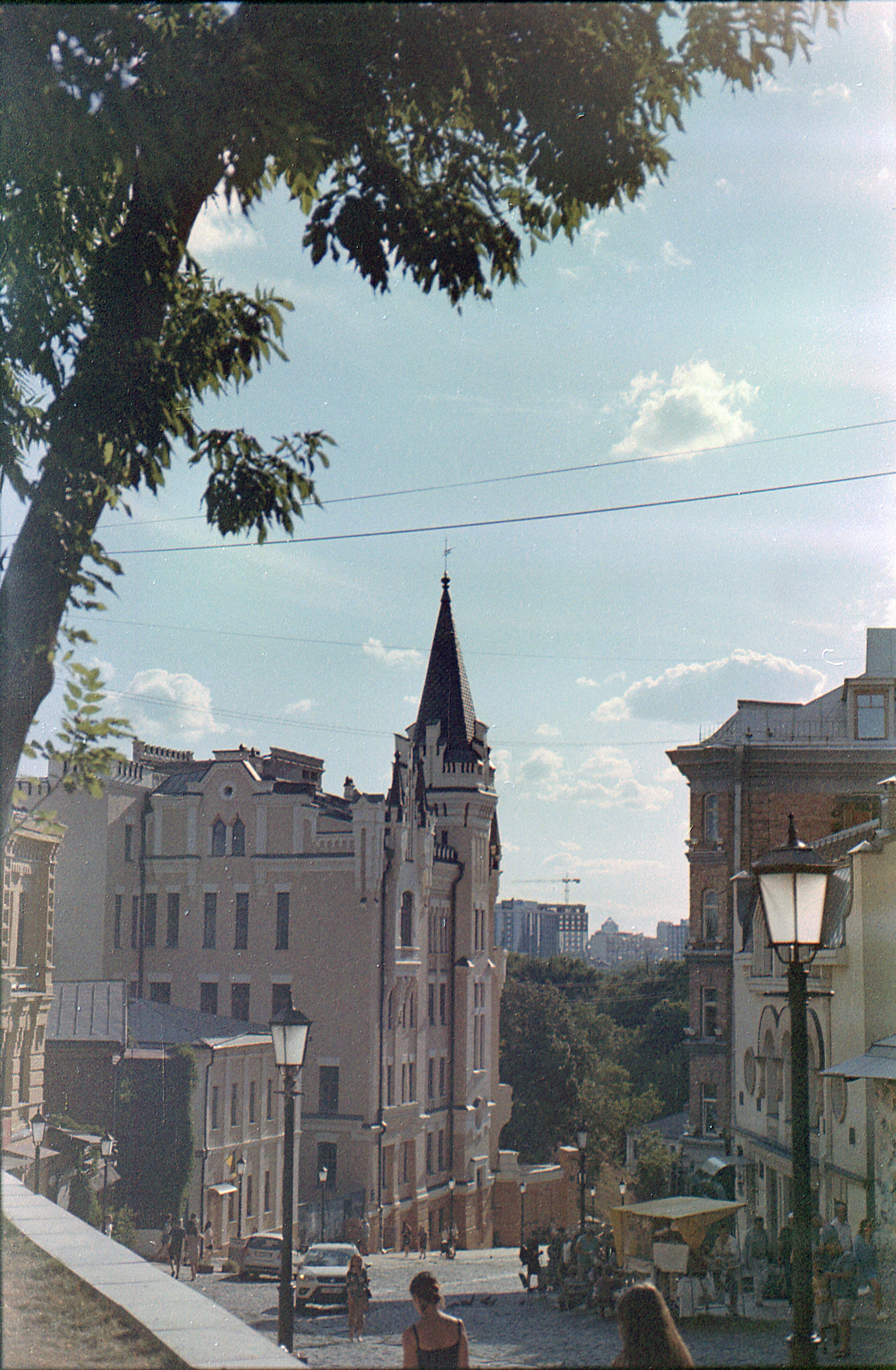

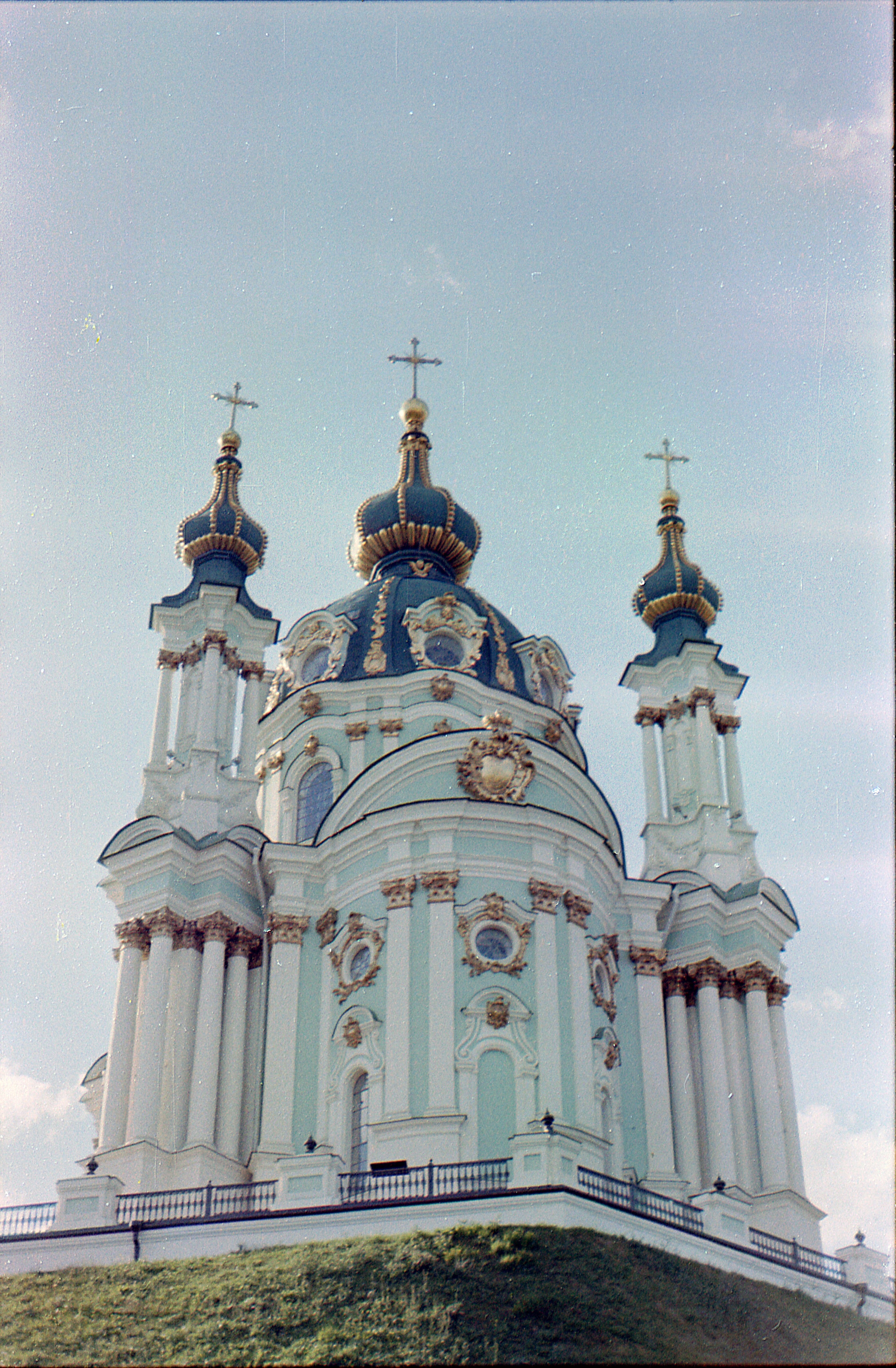

Curious if anyone has any good quality samples images of DS-4? All I can seem to find is badly expired Lomo type shots.
I have several, but I butchered it in dev., so please disregard the streaks. I was just starting back then. The film is still very expired (40 years at the time of shooting), but stored in a fridge. Phoenix will most likely look different due to different dye couplers(in resin vs non-diffusing hydrophilic in Agfacolor derivatives+it's not like Harman just straight up opened copied DS-4, although it's fairly easy to get the complete original recipes), but close
