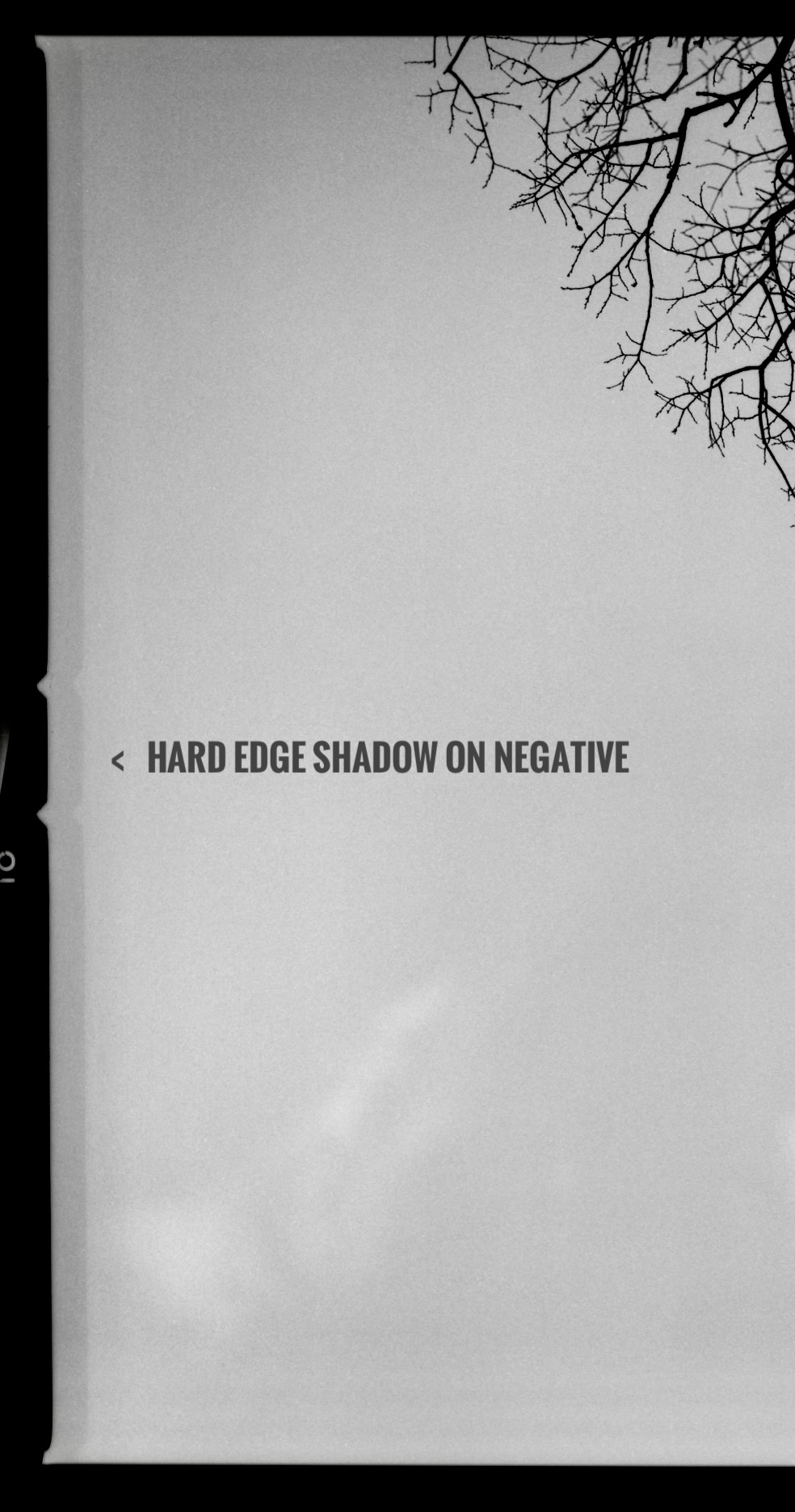

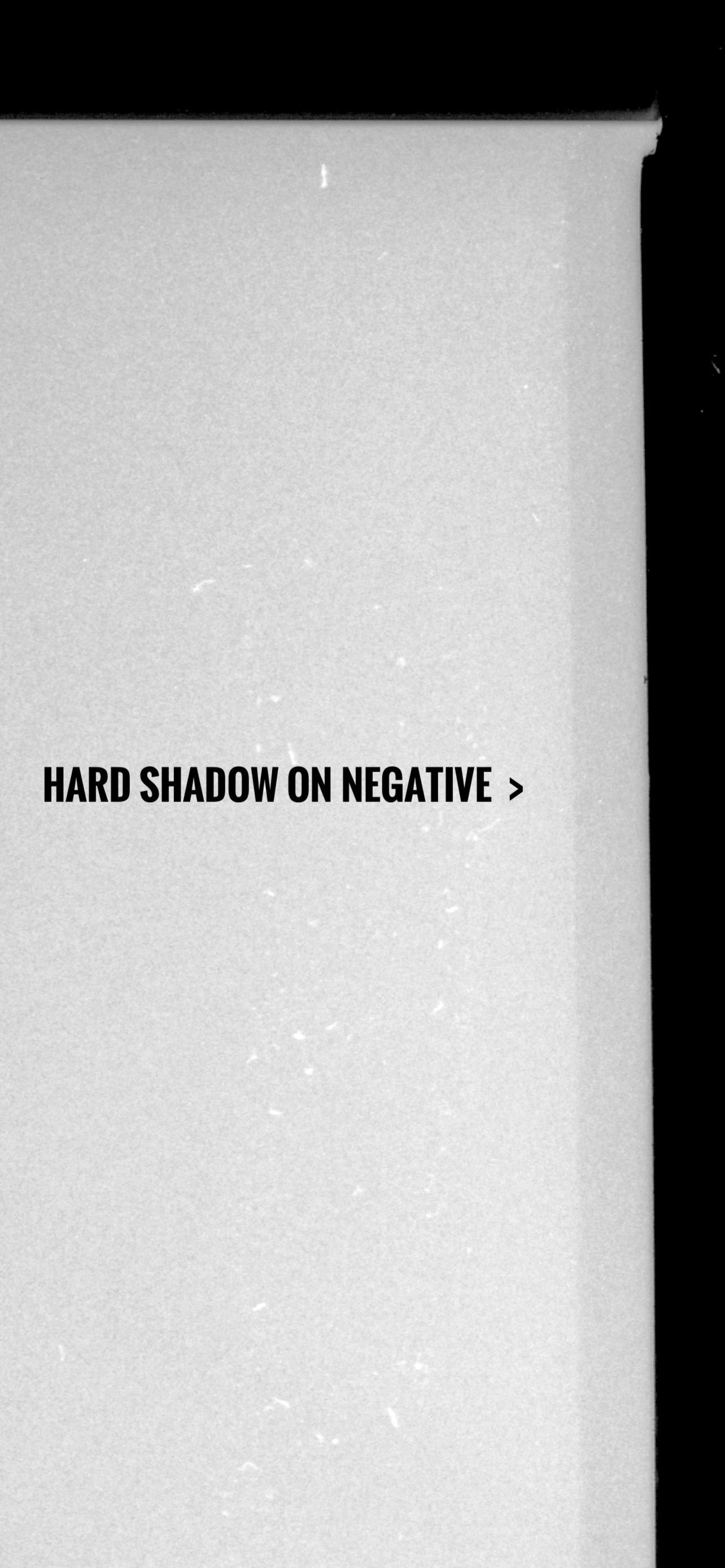

I’ve seen this with my SWC and 501 cameras with two different backs. Anybody seen this issue? David Odess, HB in New Jersey and a friend who uses the same rigs have not. I can’t see anything in the cameras that’s casting a shadow. Thanks.

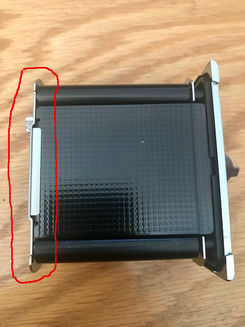

That is the image from the film clamp on the edge of the film back. Nothing to be concerned about and nothing that you can eliminate. Just crop the edge of the negative when you print it in an enlarger. A slide holder will cover this area anyway.

I’ve never seen this from either of my Hasselblad backs. You’re getting this problem on two different cameras with two different backs?
The darker area in both of your pictures is sky. if there were branches there would we see them or would they be completely hidden?

The OP's darker edge appears to be in the negative area and not the rebate. Have I got this right? If I have then if there were negative details there it would mean cropping out part of the negative that you might want to retain, wouldn't it?
See the tab circled in RED

Good theory but the thing is, this shadow can appear on both sides of the negative and extends beyond where the film clamp grips the film. Very irritating.

What’s “ the OP”? The shadow would darken anything underneath and it’s often difficult to see unless it’s on a smooth tone. I had to tweak curves to exaggerate it for better illustration.

Yes, different cameras, different backs. I sent one A12 for service at HB and it still does it. The shadow will darken anything underneath.

Notice that the shadow repeats the shape of the edge perfectly, including the "v" notches.

Exactly Steven. I’ve been processing 120 film since 1975 from more than a dozen different cameras and have never seen any processing problem like this. Very irritating.

BRBO, It’s visible on the negative with a loupe. I’ve had weirdness with scanning but this is definitely on the film.

No theory, real world fact. Your image only shows the clamp image on one side of the photograph.

The clamp covers the end of the film to keep the film flat on the film plane.

The clamp is cropped out with printing as stated in my earlier post.
