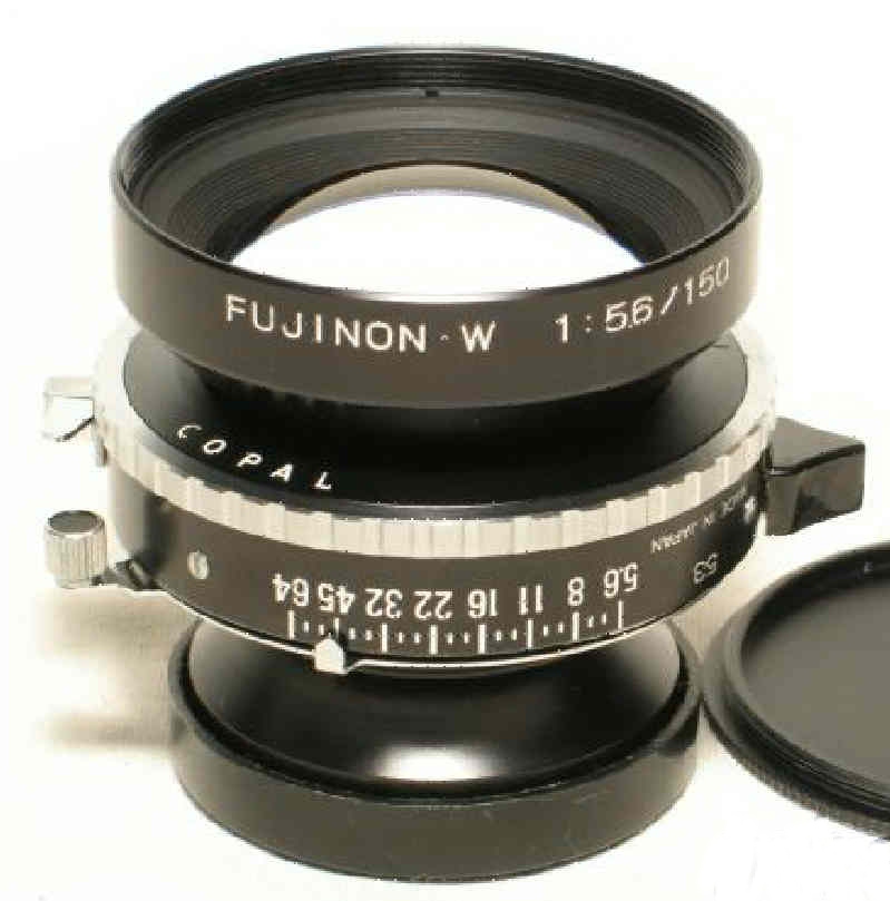

Notice how those little metal plates that have the f-numbers engraved in them are easily interchangeable
for some reason the ƒ numbers on copals sold with Nikkor and Fuji actually aren't removable. but other than that nitpick 👍

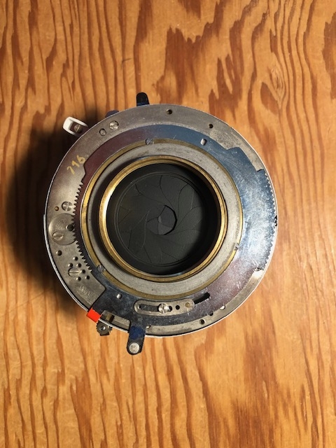

all of my later Compur shutters have clicks on the aperture--00, 0, 1, & 3. One of these days I'll take them apart remove the clicky thing.
Edit: here is a Compur #0 with click stops--in the photos you can see on the rear of the shutter the click stop mechanism:
I'll try to post a picture of the click stop mechanism on one of my No. 1 Compurs. The Compurs with click stops have linear diaphragms, of course. None of my click-stopped Compurs have the intermediate stops marked. I have some literature from Prontor/Zeiss Gruppe with a date code of 1988 showing what I think is probably the last of the line of the Compur shutters. The No. 3 Compur now has a top speed of 1/250. The No. 1 and No. 3 have intermediate marks corresponding to 1/3 stops; the No. 0 has a half stop marked between each full stop. Descriptive text says "They have a diaphragm with marked click-stops in 1/3 steps (size 0: 1/2 steps)." Wonder what the actual production numbers of these were.

Here's the click stop thingy on one of my No. 1 Compurs, one more piece of evidence that such things actually exist. 😄 The detent engages in the toothed sector to the right. Not sure of the function of the toothed sector to the left.
Wild guess, but some Compur shutter were equipped with a vertical shaft that stuck up above the front standard that you could use to view and change the aperture. I wonder if those teeth were used to engage that.

I don't think that's a wild guess at all. Looking at the back of my shutter, the device you show and the "Aperture setting devices" for the Compur shutters shown in the literature I referenced above, I'll bet you've nailed it. My literature doesn't show the details but says one of these devices could be added later by the end user.
They are removable on all of mine -- you can see the two screws that hold it in place. Each Fuji has a small number pertaining to exact lens that it is designed for. Here's a #53 for a 150mm f5.6 on a Copal #0
If you change the lens, and not the scale, exposures will be messed up.
