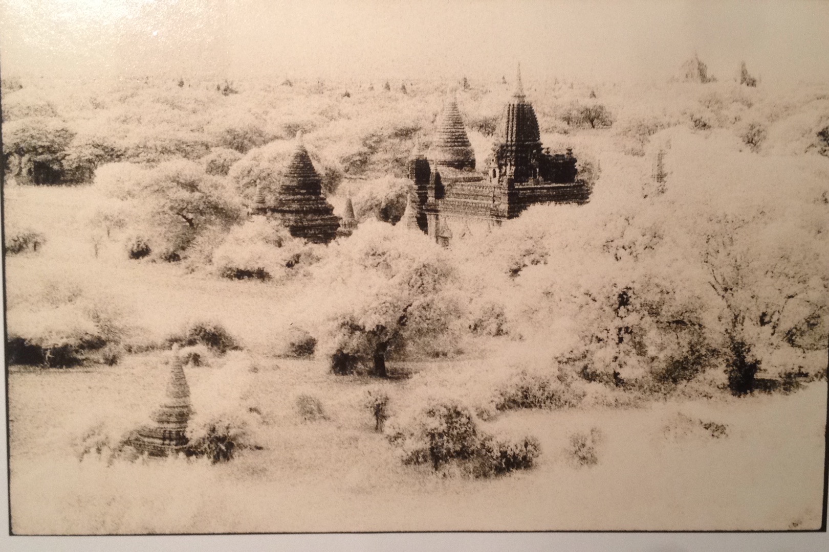

As you said, handle in total darkness, although I have come away with loading HIE outside on a bright day, under cover of a coat. Now I always bring a changing bag when I travel with HIE. When flying with it I insist on hand inspection at security. The attached photo is taken in Birma on HIE that had to be negotiated out of frying by multiple airport security officers, and was Lith printed on return. The Woods effect is still very convincing. The film was over 10 years old ad the time.
