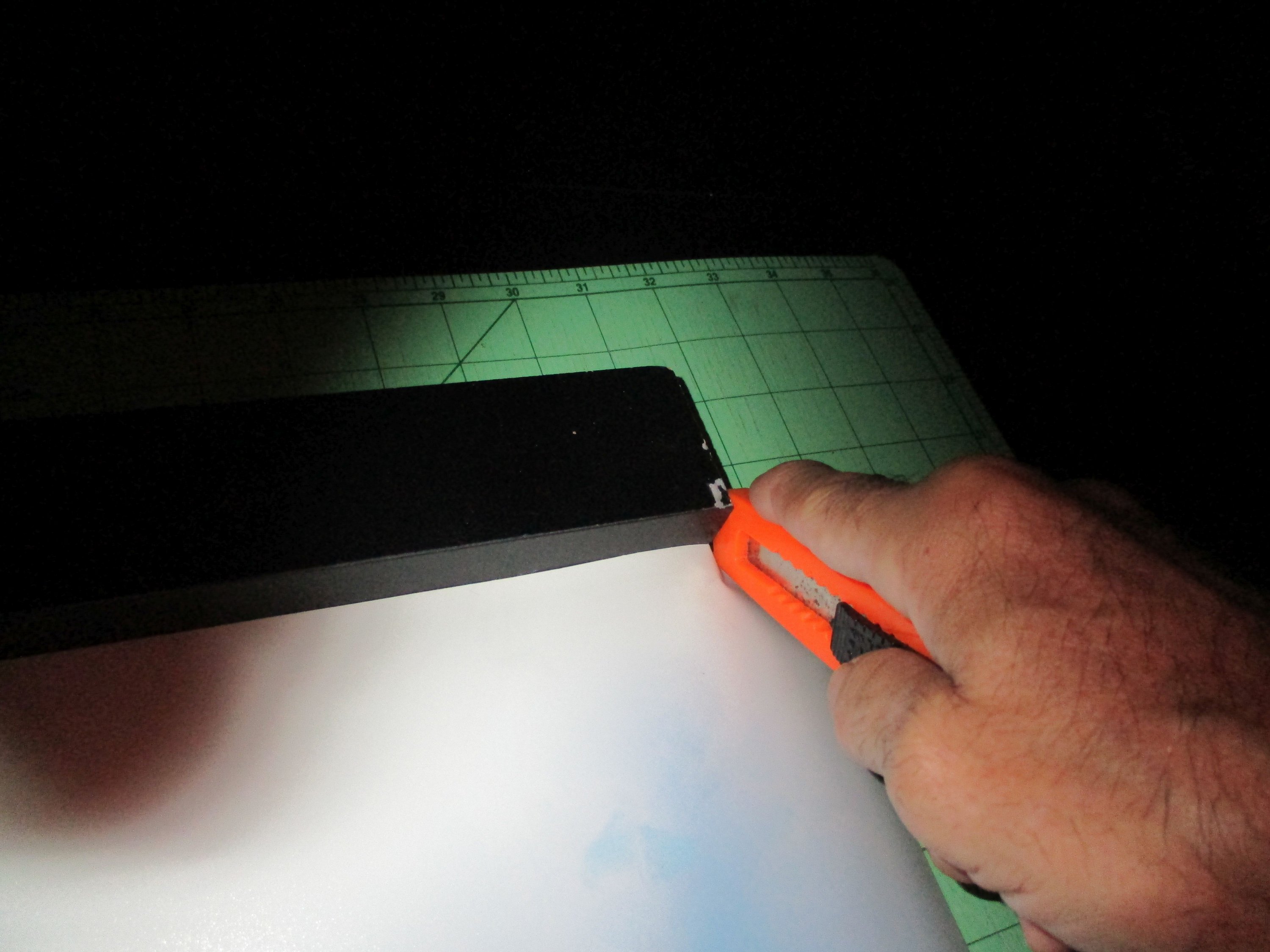

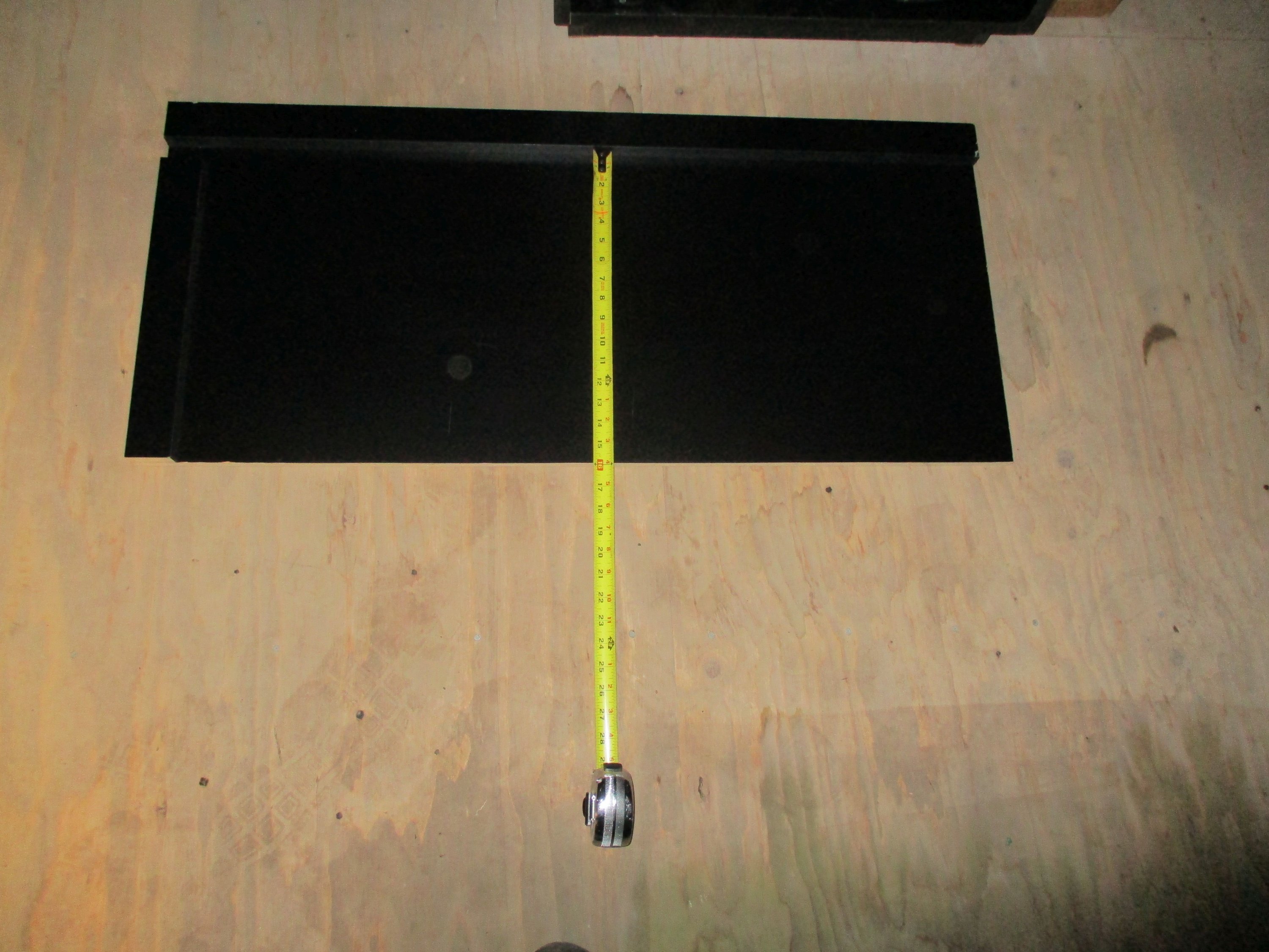

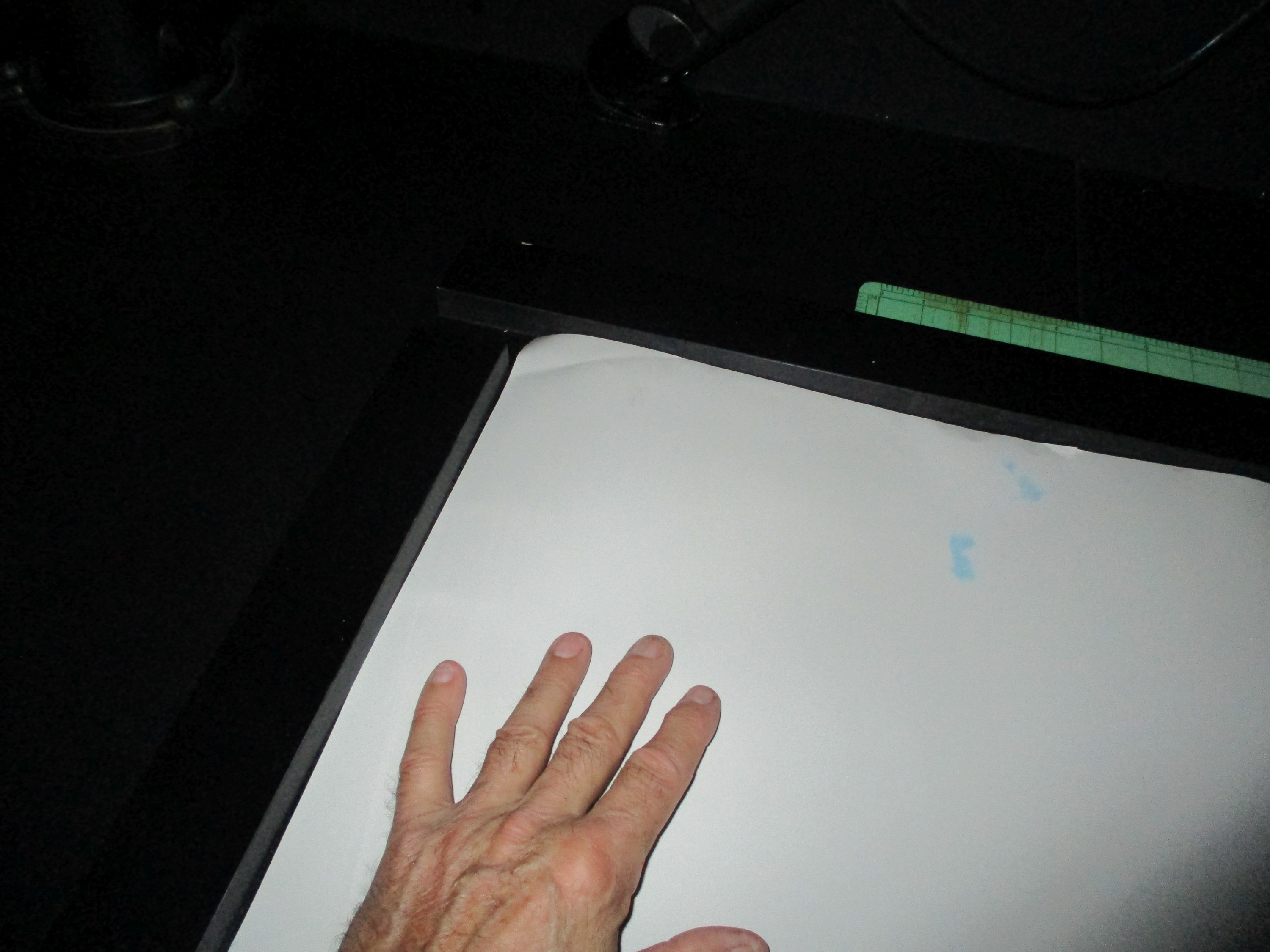

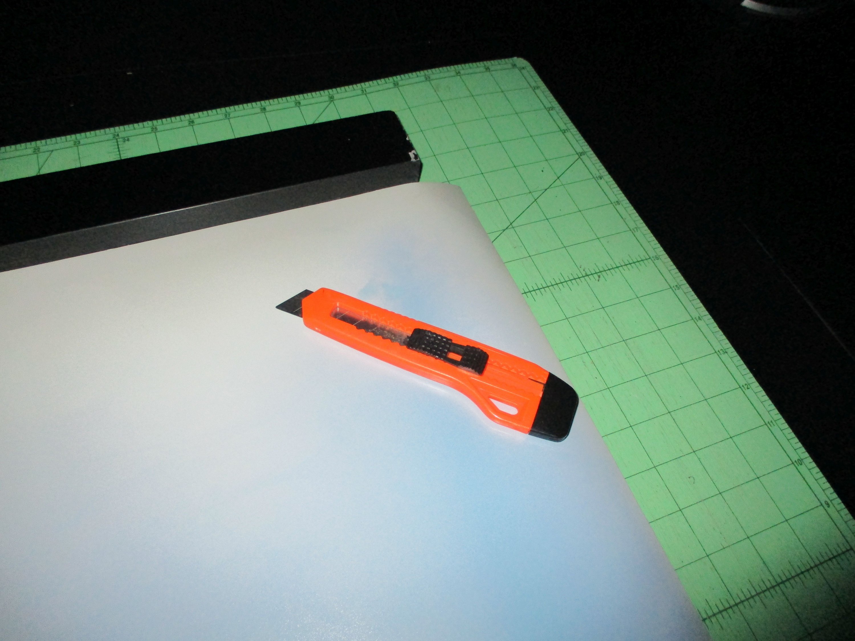

More rolled paper cutting techniques - My processor only accepts paper 16" or narrower, so while cutting 20" paper rolls to whatever length is easy enough with a standard rotary cutter, ripping to width is a little trickier. I made this 16x38" borderless easel from black melamine (available in 1/2" and 3/4" from any cabinet sheet goods supply house).
It works great to cut paper to length and width too. I set it up with the back fence perpendicular to the roll of paper, pull paper out until it bumps the end fence,
then use a sharp snap blade knife to slide along the end of the easel to cut the sheet to length, and across the front to cut the sheet to width.
And of course, when you cut a 20" wide sheet down to 16" wide you get a 4" test strip however long you sheet is. I generally cut these 38" test strips into 3 or 4 short pieces, but you could leave them long if that's the way you work.
