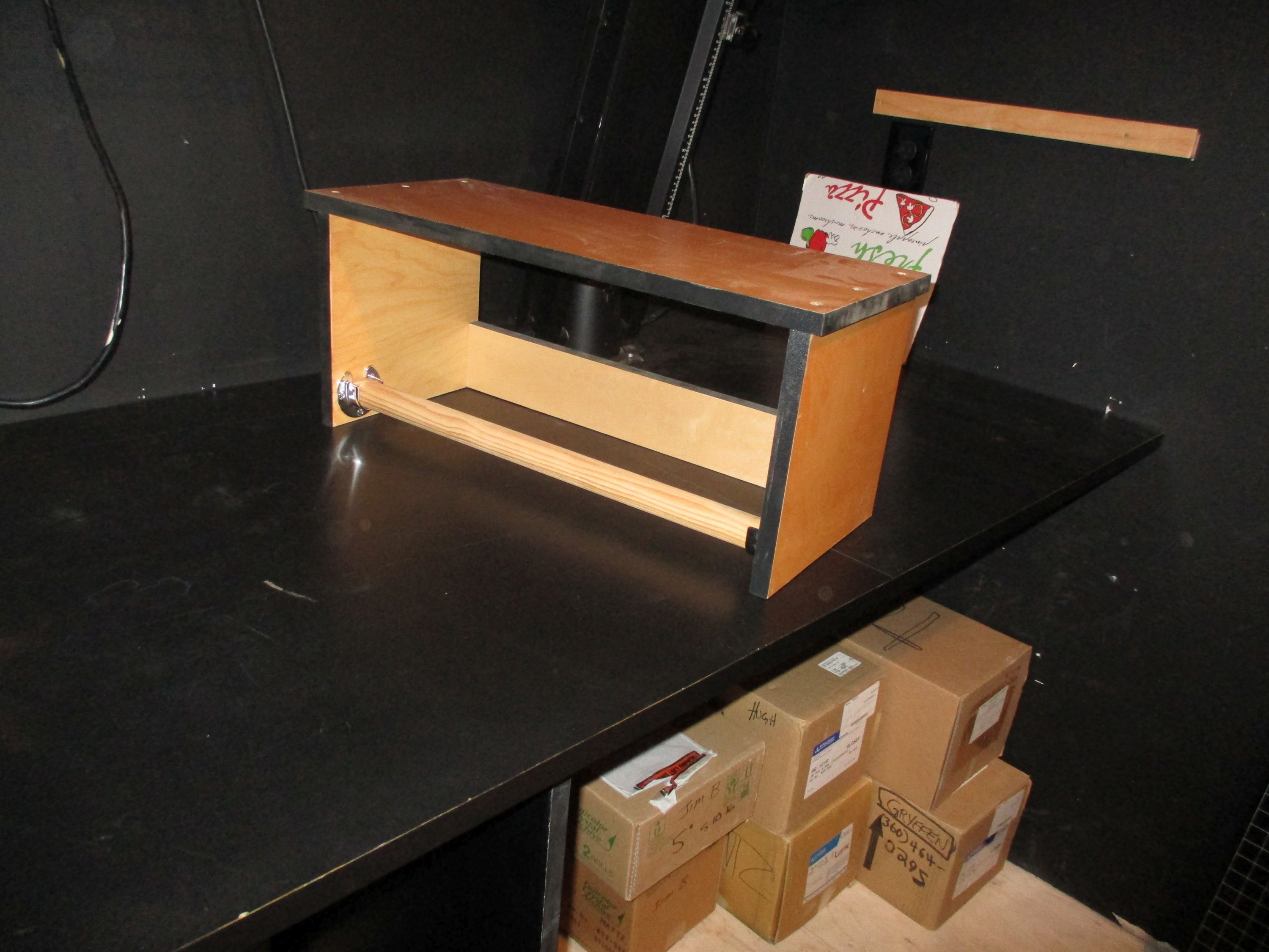

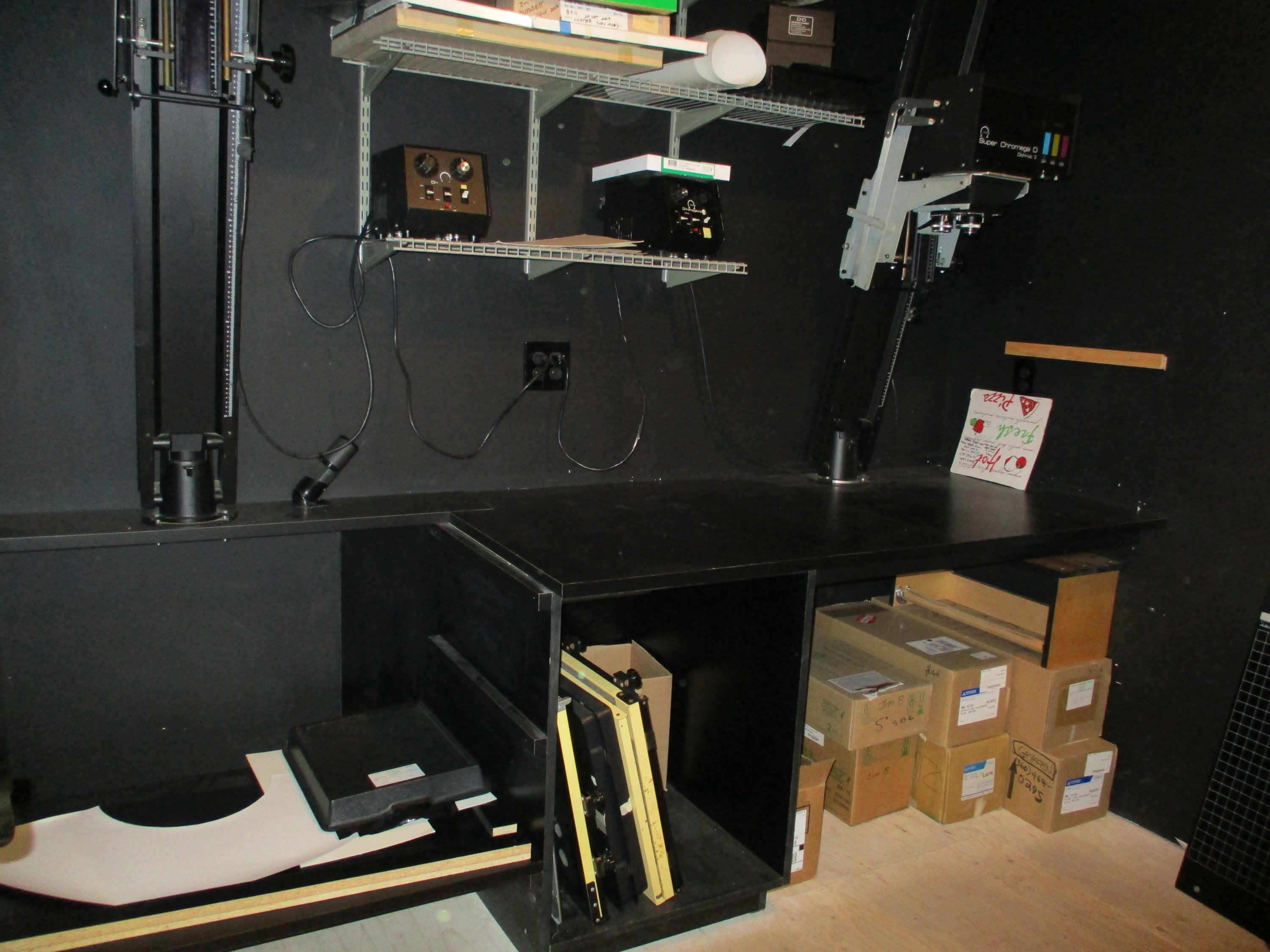

Donald - Okay, so I will TRY to upload a few photos of how I cut paper from rolls. This is my first try at loading photos on this forum, please bear with me.
So first off, I think this is pretty self explanatory, but notice the light colored wood strip to the right of the enlarger. Some people refer to that as a "French clete".

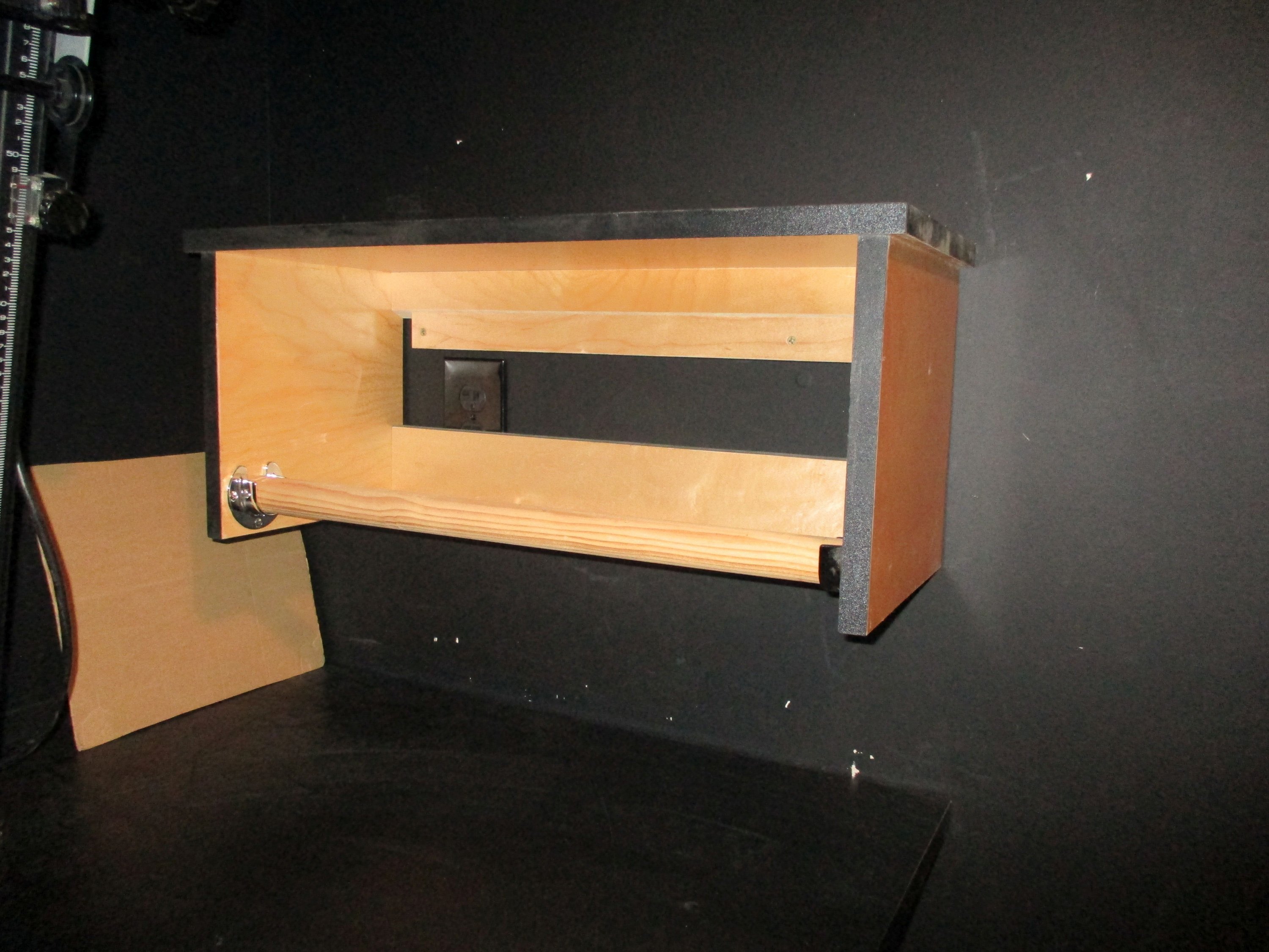

The top edge is beveled back towards the wall, maybe 30 degrees or so. Now look under the table and see a plywood rack on top of the paper boxes with a piece of closet rod nested in closet pole hardware. That rack has a corresponding piece that mates with the French clete on the wall to suspend the rack on the wall when I intend to use it. Here's a better shot of that rack...
and here it is mounted on the French clete...

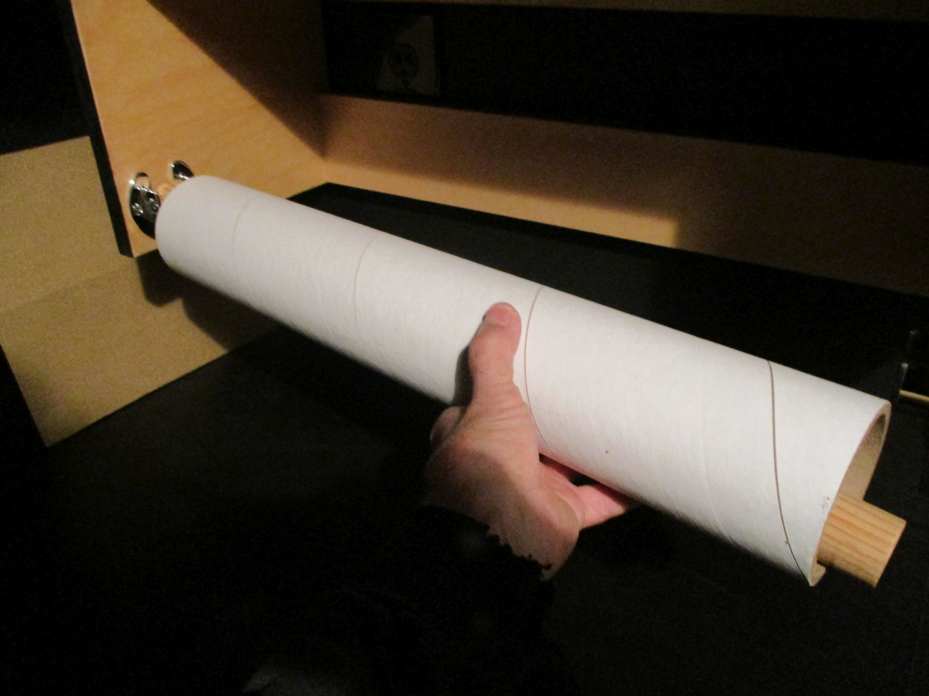

Here's an empty 20" roll, you'll have to imagine it with paper on it. I slide the 22" closet rod into the roll and mount the roll on the rack.
