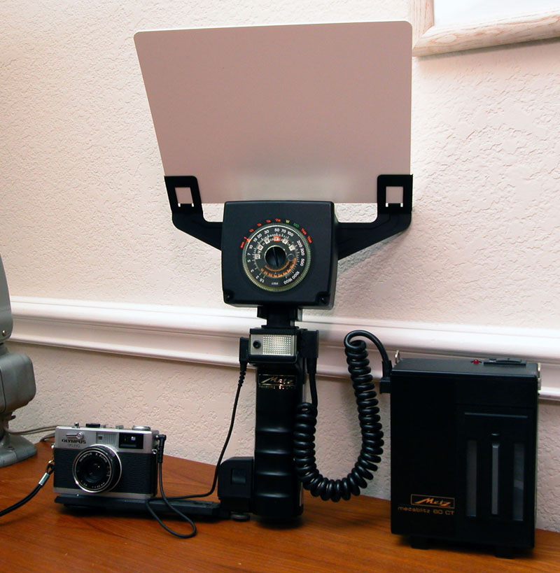

Something like this?
I just found out by taking my cameras out that both the Olympus 35RC (I think the RD is the same) and the Canonet QL17 GIII have the PC connector on its side. So no hot shoe adapter is not necessary.
What is the Metz brick at the side? That seems not compact friendly :D
Something like that, but what I'd try is the flash in one hand and camera in the other. Atleast that's what I saw and seemed very cool :D
Oh that's the power pack that supply both low and high voltage to the flash head. It's definitely not compact friendly. I was kinda did it for fun. As you said the flash is generally ugly and to make it less ugly it needs to be big
The flash pictured is a 60 series Metz flash.
Although the battery pack is large and heavy, it allows Metz to move a lot of the heavy stuff out of the flash head, which as a result is large and fairly light - light enough to handle quite easily, while putting out lots of light.
I used to use one while shooting weddings - powerful, fast, flexible and capable of doing an entire wedding on a single charge.
The bounce card pictured will work on the Metz 45 series flashes as well. They are fairly powerful as well, and don't require a separate power pack, but are heavier in the head.
Okay the big Metz is a bit oversized so I think this outfit would be more compact friendly. I can use it as on hot shoe flash. Remove the sensor attach it to the cable and mount the sensor on the hot shoe and I have a hand held flash unit and still having the sensor on camera.
