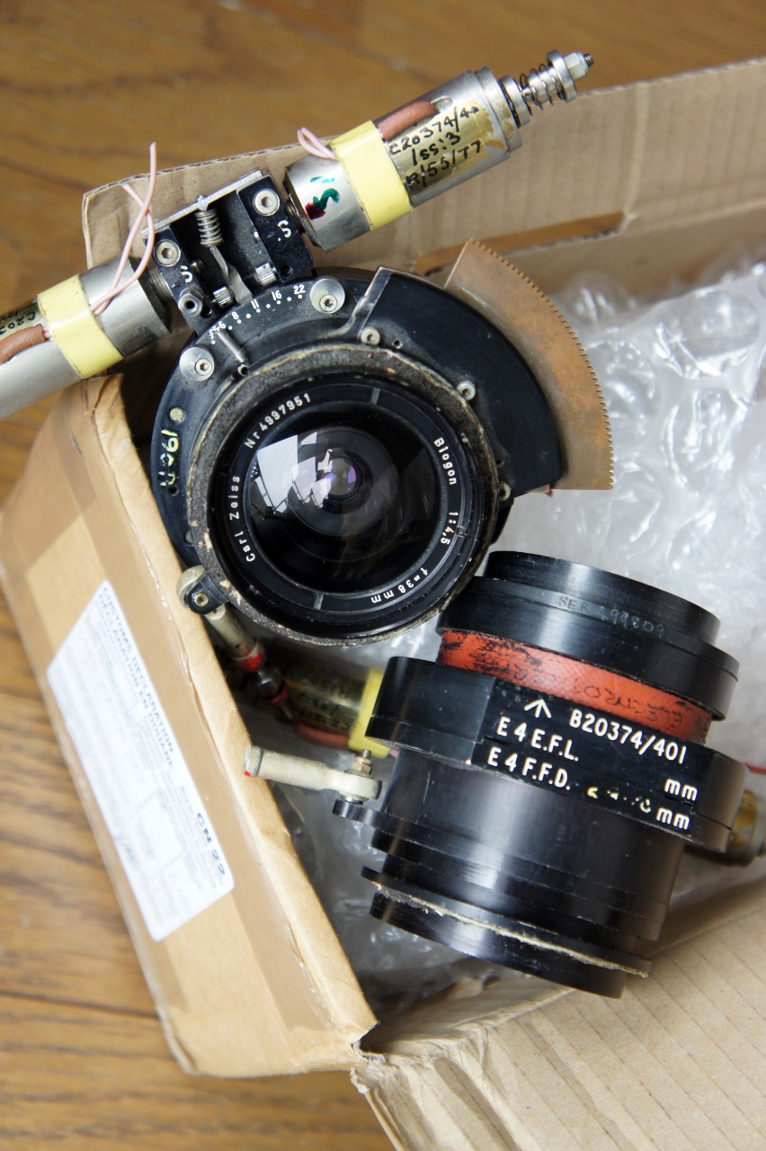

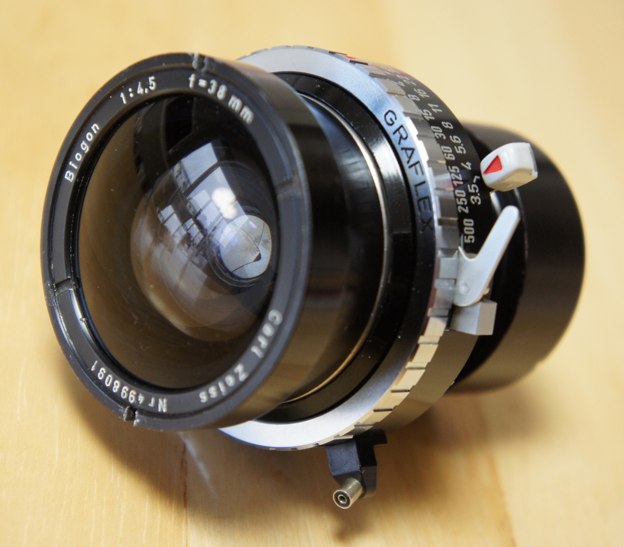

I made a lens unit of Biogon 38mm f4.5 from a R.A.F.(Royal Air Force) aero lens.
Lens unit I bought from eBay.

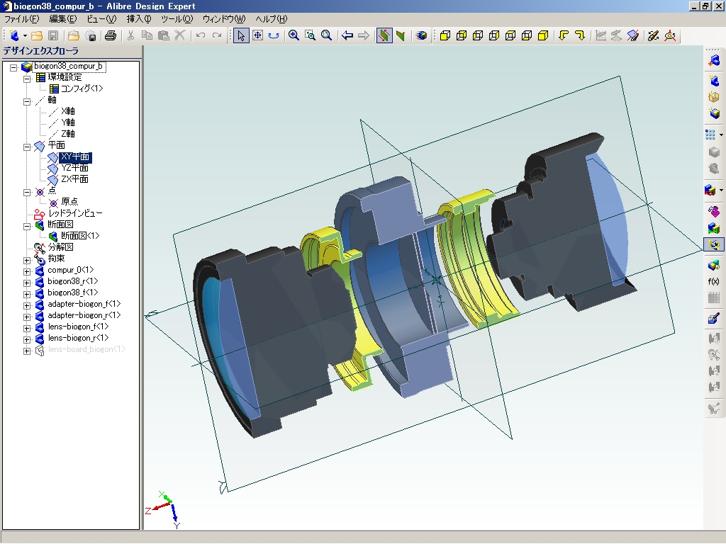

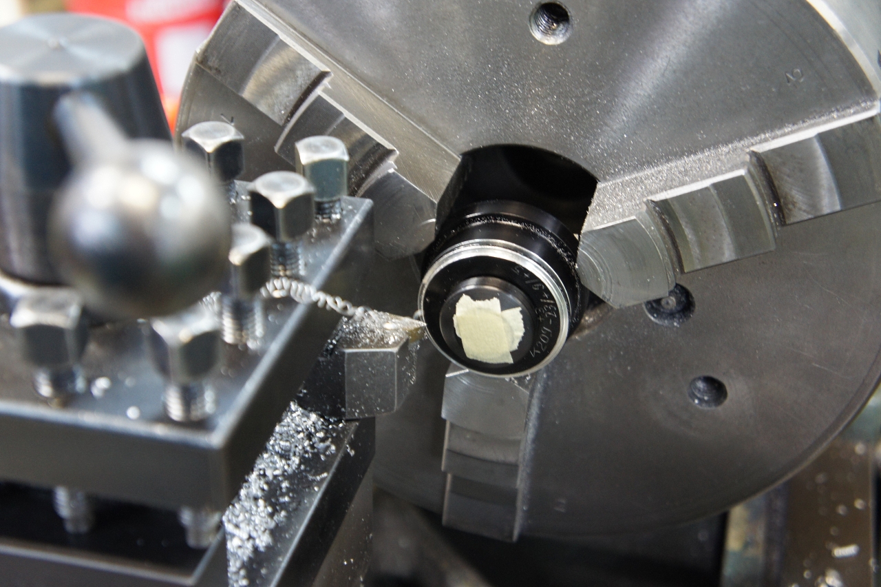

Remove the lens by using a lathe.

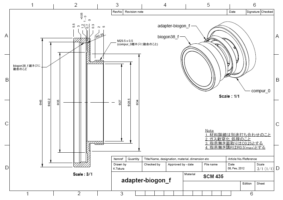

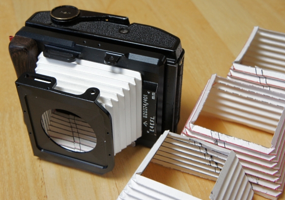

Design the adapter with a 3-D CAD.

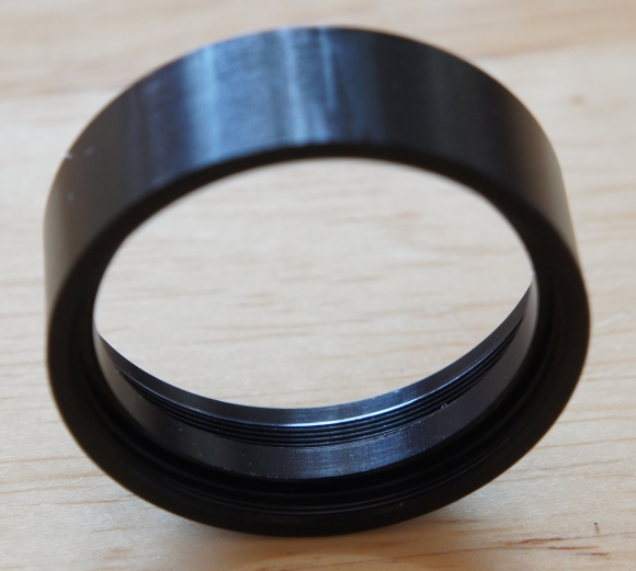

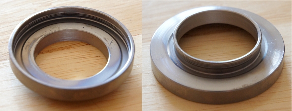

Finished part of the adapter.
Then, the lens unit was completed.
Was required very, very advanced design capabilities and machining accuracy.

stonemute, that is indeed impressive! Have you tested the image circle of the lens to determine whether it could cover film formats larger than 6 cm x 7 cm? (Apologies if this is an ignorant question. Maybe the answer is already obvious to readers who shoot large format, but I am not among them!)

What was the net cost of this lens, for you to make it?
The net cost of adapter is $190(including nitride & anodized),
biogon is $320(including shipping cost to Japan).
Not included my manpower. :wink:
The image circle is 84mm.
It is just covered 6x7, impossible to take 6x8, impossible to rise.
