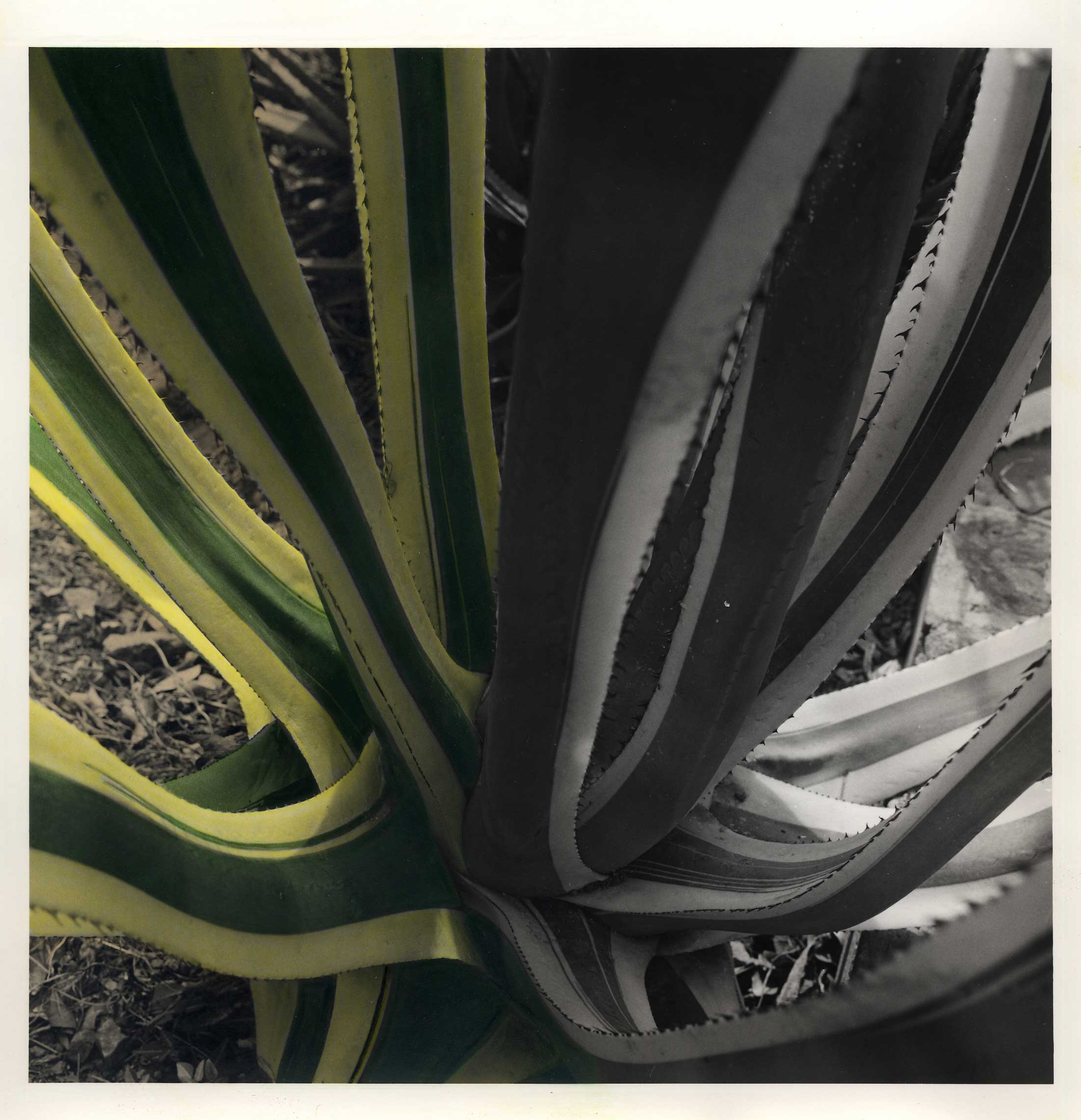

I am not sure if here is the right area for this theme.
I bought today some oil ink and tried my very first attempt to colour a black and white photograph with
swabs.
This is RC paper, I am not sure if it is the write paper to try it.
Any way, I am looking for suggestion and tips to help me with the learn process of it.
Dead Link Removed
Use matte fiber paper. For applying the paint use cotton swabs (Q-Tips), and use cotton balls to evenly work the paint into the surface. Colored pencils work well for details. Here's one which is half colored:
