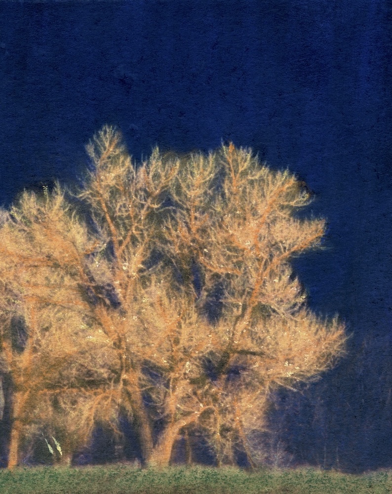

So I haven't been very active here or in the FB group I mentioned. I posted a bunch of resources like books, website links, and videos to FB but few members have posted much. I have around 30 members. So far this forum has been more useful! But I hope interest in the subject grows. I'm trying to post here a picture I colored but keep getting an error saying the file is too big (it's only 806KB)
This is on Ilford MGFB semi-matt, using standard Gamblin oil paints. I did not prepare the surface with a PM solution. The colors apply well to this surface and if a color isn’t right, it can be wiped off pretty easily with PM solution. The odd texture is due to this being a reject work print that was only quickly rinsed after fixing.

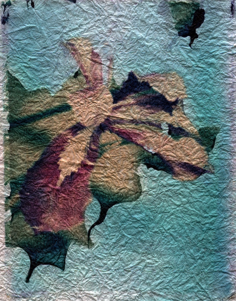

Long time ago, I made a cyanotype and then I tried to colorize with acrylic colors. Here is the result....it was the first try and I am very very bad in painting...
Bj68
Bj68
I love it!

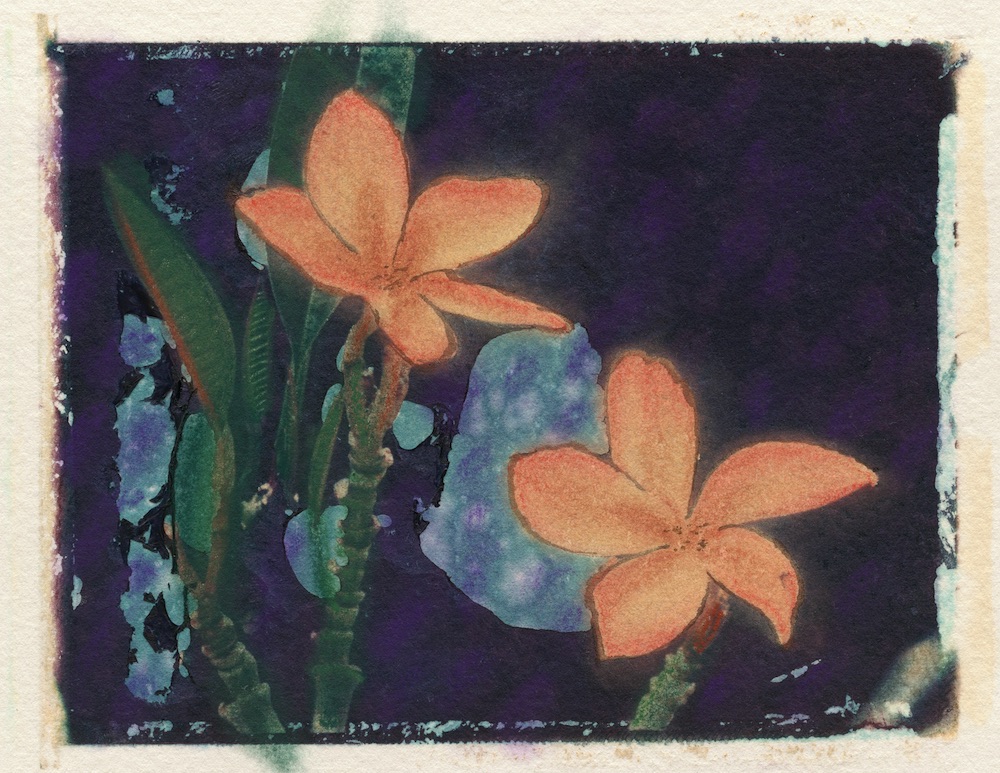

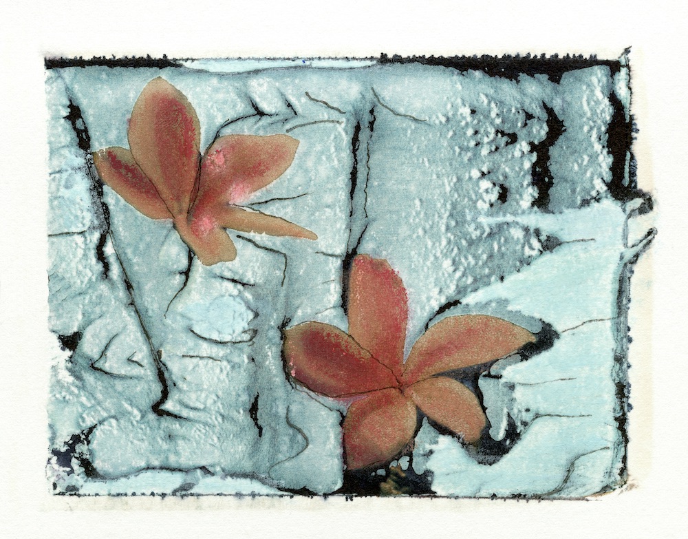

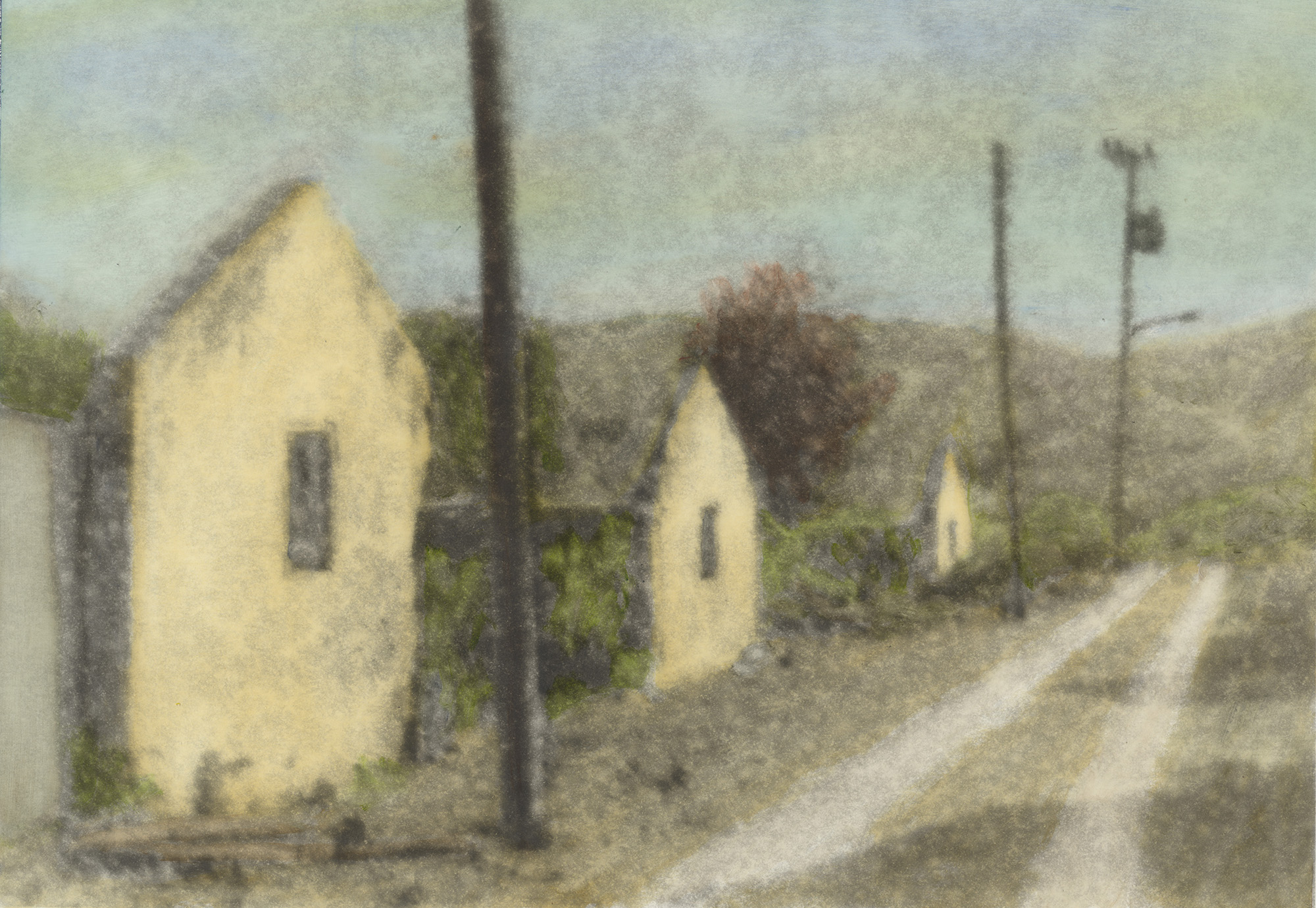

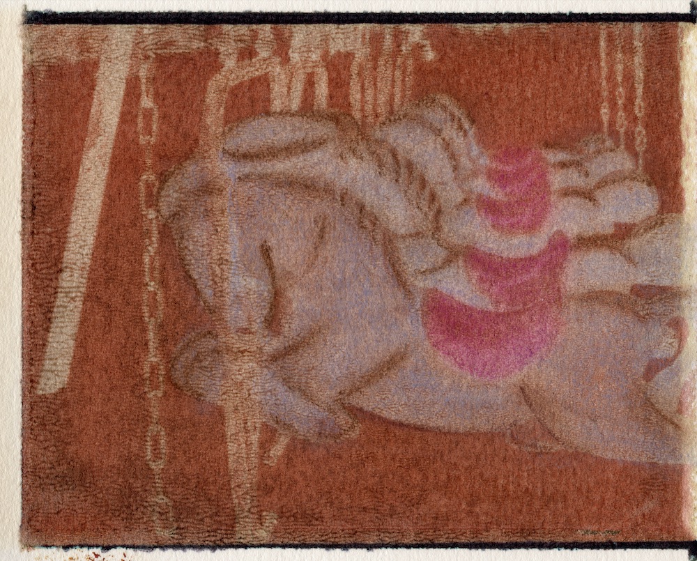

Here are a few hand colored Polaroid transfers on various art papers that I did a few years ago. I used Stabilo CarbOthello colored pencils & Marshall's photo pencils. Blending was done with cotton swabs.
