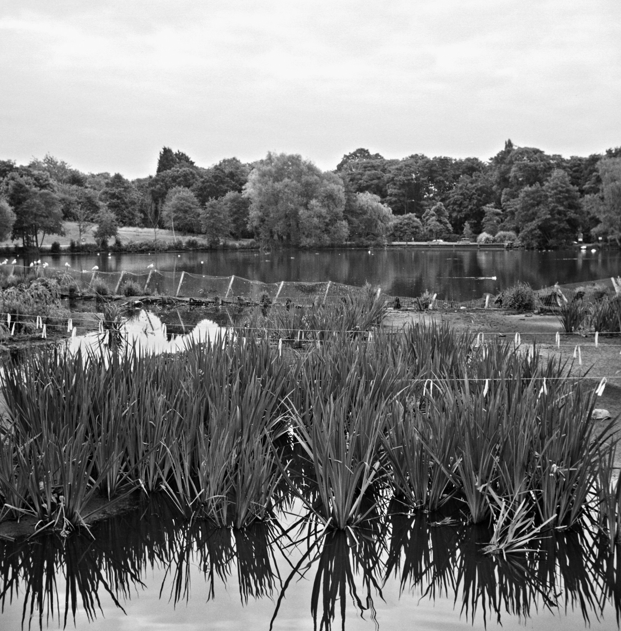

    I get my films dev and scanned at various labs, and I notice they always come back with a 'halo' where the sky meets the ground. This happens with various labs across C41 and B&W on Noritsu and Frontier scanners. If i try to work the scan in Lightroom, for example dropping highlights to compensate or blown over exposed skies, this makes the effect more visable.
    This is 120 Tri-X shot on a Zeiss Ikon Netter, with the film unmodified after scan. Notice the halo in between the top of the trees and the sky

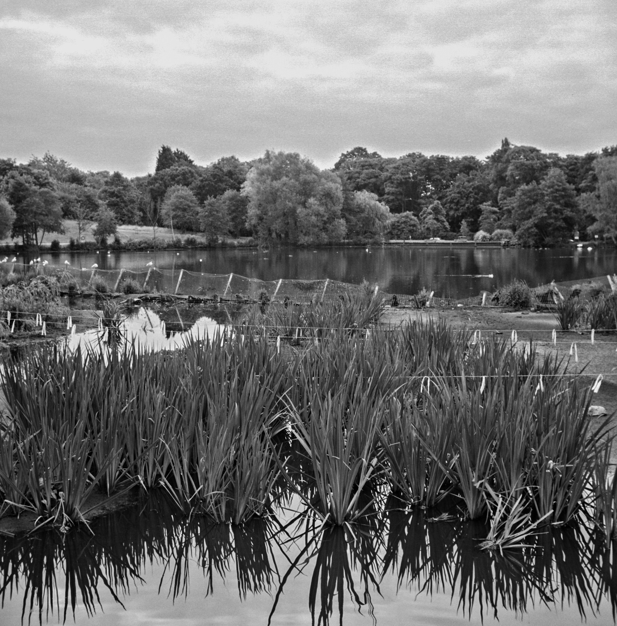

    This is the file with the highlights dropped to -100 in Lightroom, just to make the halo more visible

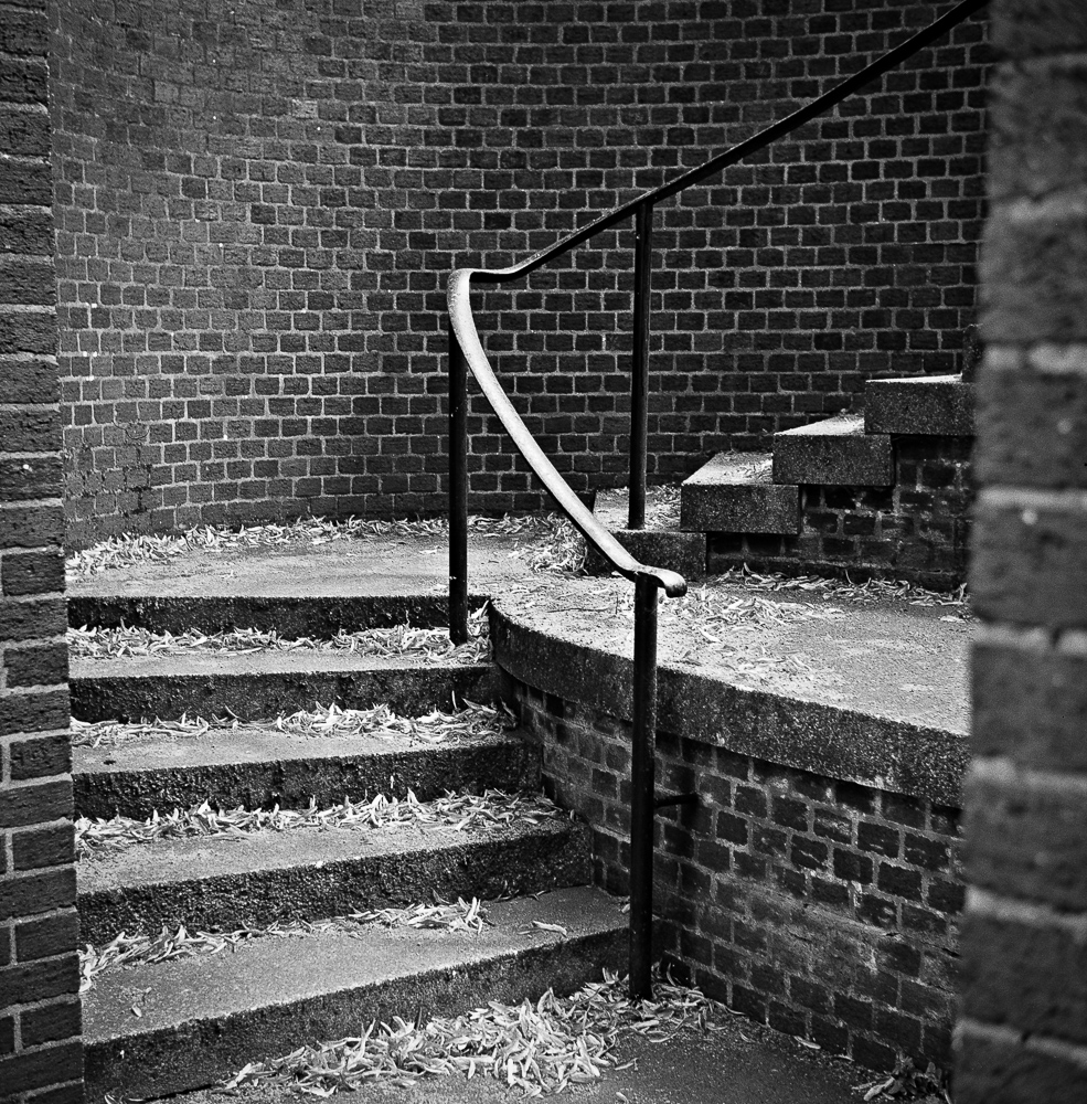

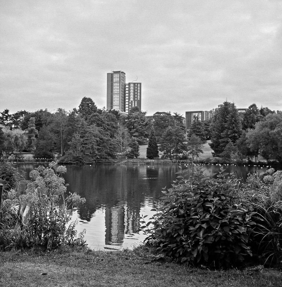

    For what it's worth, here's some more shots from the same roll of Tri-X.
    First image is an unmodified scan, apart from the highlights dropped to -100 to make the halo more visible. A halo again at the tree line but not as obvious as the previous photo 17500012-2.jpg
    The next two don't have a skyline and don't have halos, in fact I've worked on them both in Lightroom (including extra sharpening) and appear to be fine.
