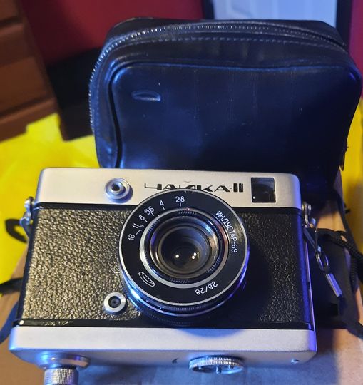

The Chaika II came in today.
I am actually surprised at how quick, it came, all the way from Serbia to Canada.
It looks great, I haven't "used" it yet, but I did a basic function test, and all seems and looks good.
The zipper on the bag is slightly damaged in on area (like was said on the listening) but still closes fully with a little effort.
It's going to be exciting to use this thing.
Fed did make a half-frame camera -- the Micron (a copy of the Konica EYE).
http://www.subclub.org/shop/fed.htm
The Micron (any model) is a very nice half-frame -- and would go very nicely with your Chaika II.
The Micron has a built-in meter, but the Chaika II has a removable lens. Go ahead and remove it -- you just twist it counter-clockwise. You can then use it on an enlarger!!!
