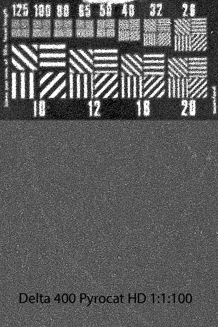

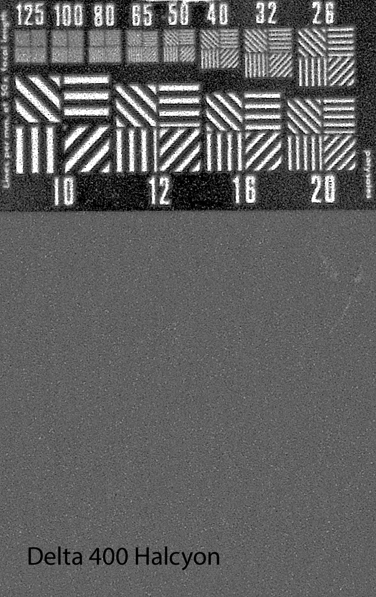

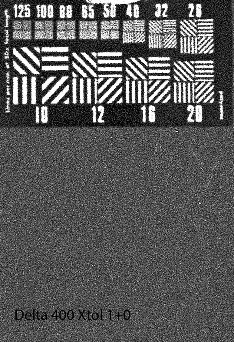

Here I tested the ascorbate version formulated by Jay DeFehr:
https://www.largeformatphotography....?71010-Halcyon-superfine-grain-film-developer
I used it without replenisher, starting at 9min 70F for the first film and increasing time by 5% for each subsequent roll as suggested in FDC. I found it to give about half box speed (sun/shade, average metering) to 1/3 stop less than box speed (Dull, average metering).Of course, this is only a very limited test.
Very fine grain results were obtained cf Xtol and Pyrocat (attachments).
IDK how it compares with Perceptol or with the older PPD based developers or how it works.
Interesting. The Film Developing Cookbook claims that PPD destroys image sharpness, but in your examples the PPD developer has not only finer grain but also MUCH better fine-detail resolution!
Have you shot any real-world photographs with it? I'm curious how the tonality is.
I put this on the Analog section as it may also be of interest to darkroom printers but the only results I have with it so far are on my Flickr, not darkroom prints.
All the attachments are sharpened equally, IDK if this higher resolution with Halcyon is an artifact of sharpening or some chemical effect with ascorbate.

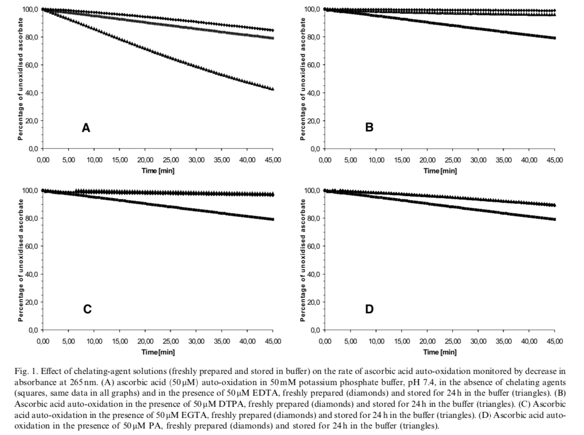

I recommend you take a look at this article: https://www.sciencedirect.com/science/article/abs/pii/S0003269702003226
It describes in detail, that EDTA does not prevent Fenton reaction from occurring, and it shows graphs, how quickly this reaction can destroy Ascorbic Acid in solution. In the experimental setup there is 10% deterioration of Ascorbate alone, over 50% deterioration of Ascorbate in the presence of EDTA, and less than 5% deterioration of Ascorbate in the presence of DTPA, all measured within 45 minutes after mixing.
There's another article to be found under https://www.tandfonline.com/doi/abs/10.3109/10715768609051638
It also describes the effect of different chelating agents on deterioration of Ascorbate. Again, this deterioration happens within less than an hour. It is strongly dependent on the amount of Iron present in solution. For our purposes, this Iron amount depends on both water quality, and the purity of other ingredients used to mix our liquids. We can use deionized water to mix our soups, but typically have little control over ingredient purity.
Things may be a little bit better in practice, because we typically use more than the 50µmol/l of our chelating agents, but I'd rather not assume it's going to take days until Ascorbate deterioration becomes a thing, unless you use proven and powerful sequestering agents like DTPA or phosphonic acids.

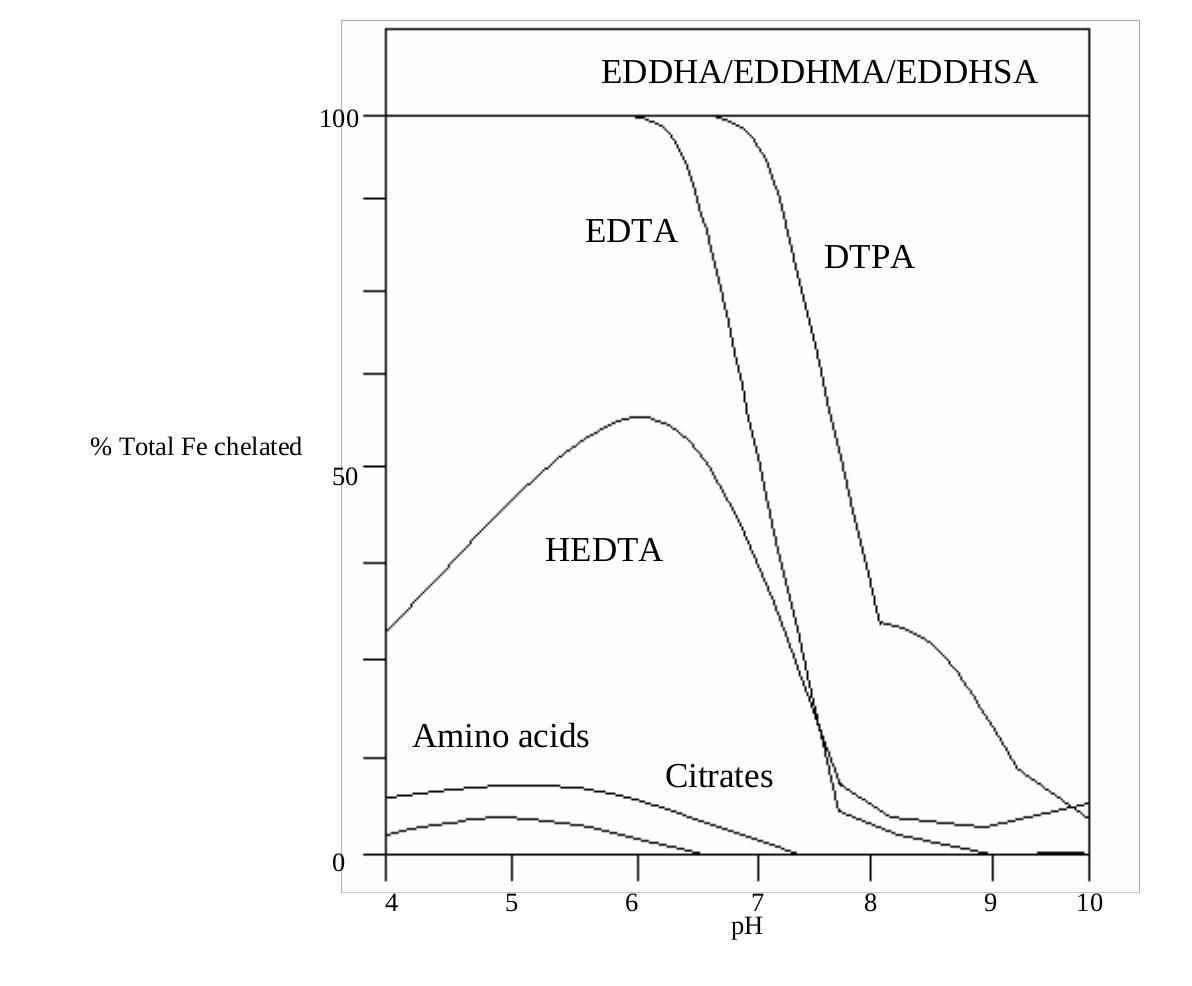

It's quite possible that the compatibility of various chelates with ascorbate is different.
This is not about compatibility between ascorbate and some chelating agents. Different chelating agents bind Iron to different extent, and there is a difference between FeII and FeIII, expressed by their logarithmic stability constants:
  • FeII and EDTA: 14.33
  • FeIII and EDTA: 25.10
  • FeII and DTPA: 16.55
  • FeIII and DTPA: 28.60
This shows, that the binding between Iron and DTPA is much tighter than between Iron and EDTA. This is especially significant at neutral to alkaline pH, where Fe(OH)2,3 is likely to form:

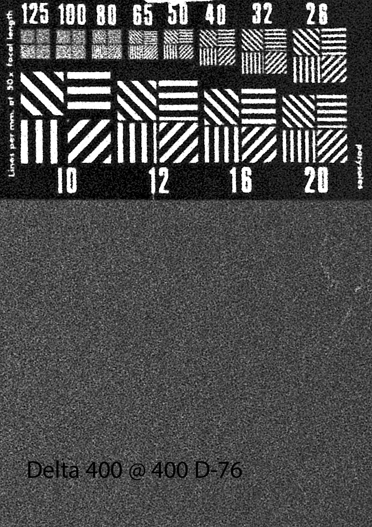

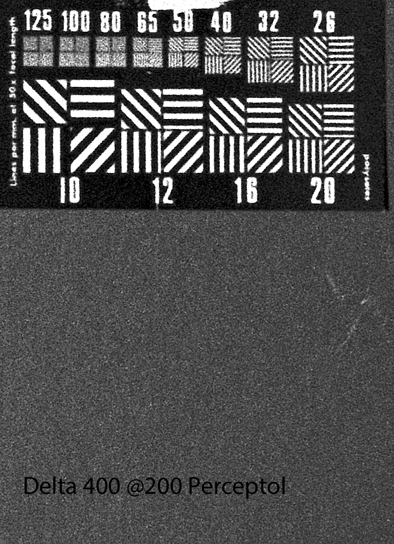

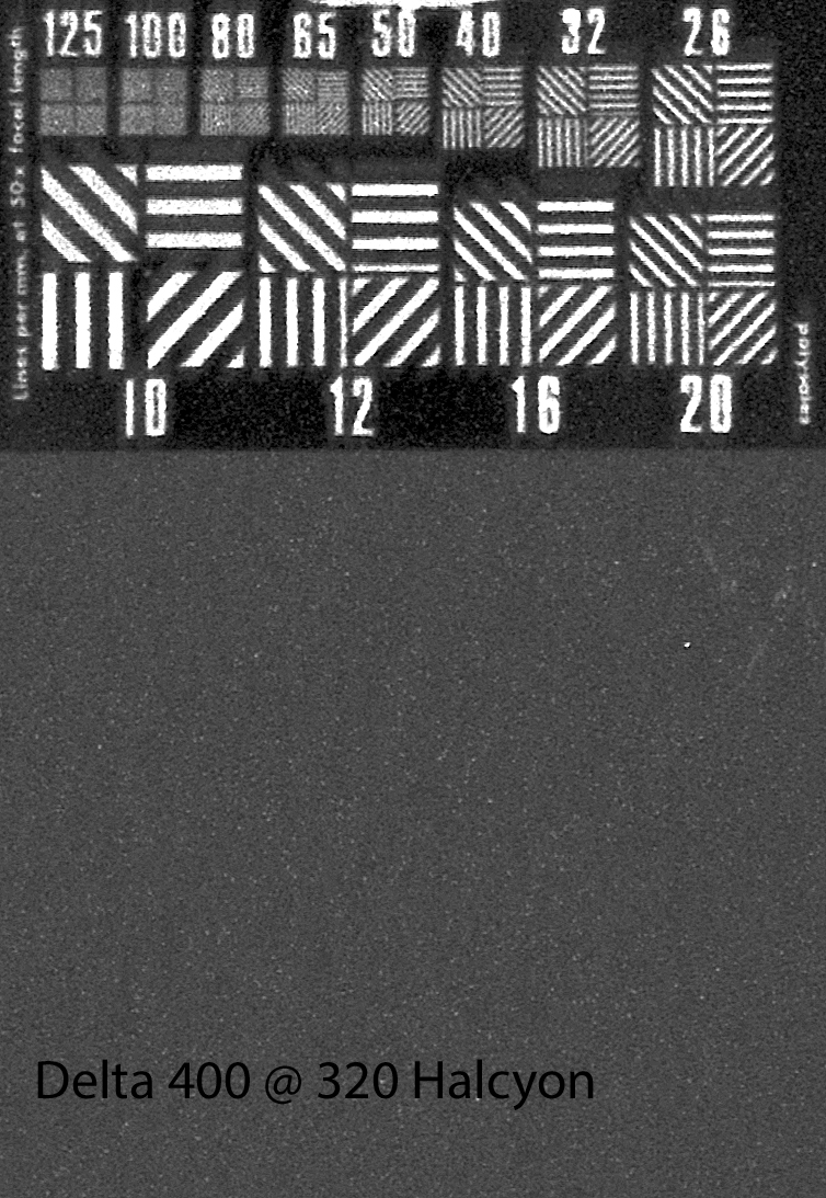

Here are the results for Halcyon, Perceptol and D-76. All are sharpened equally.
Lppm resolution is subject to small scanning height errors.
Halcyon appears to be the clear winner for fine grain, in agreement with old timers who considered PPD the finest grain developer.
Halcyon has some downsides (1) May cause allergy, see eg The Film Developing Cookbook 2020 p87. (2) Deposits silver particles and requires frequent filtering of the stock solution. (3) Speed loss cf D-76, lower density.(4) Stains (5) Hard to find ingredients.
