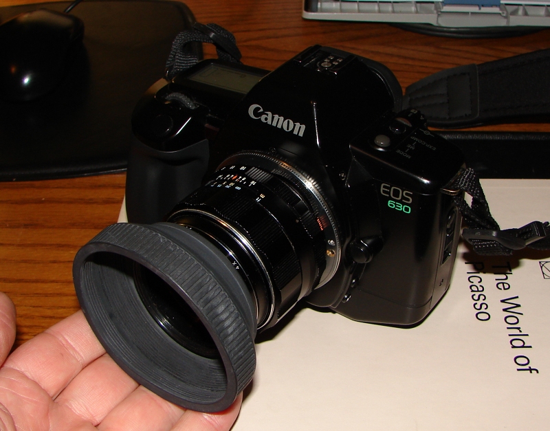

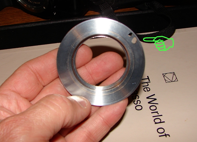

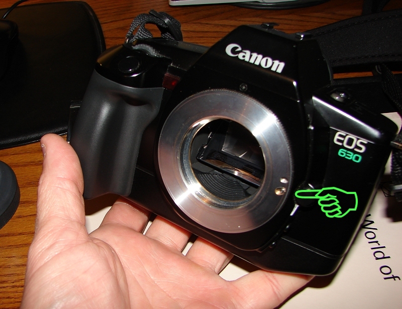

I currently use two Asahi SMC Takumars, the 50mm 1.4 and the 135mm 3.5. When it came time to upgrade from manual bodies, I purchased the 630 as it would accept the adapter shown. I simply set the camera to shutter-priority and leave the camera aperture set to 1.0.The camera meters as I set the aperture and it adjusts the shutter speed accordingly. I found the adapter on eBay for about $7-$9. It's chrome-plated brass. The adapter allows for infinity focusing on the canon. The adapter also has a lip that pushes the aperture pin on the lens. I had to offset the locking pin hole (green finger pointer) otherwise it prevented the mirror from returning. Also put a layer of electrical tape on the back of the adapter, just in case it decided to touch the camera-lens contact pins.
