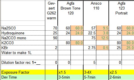

Any progress on the warm tone paper developer? I mixed up some ID-78 and I like it but any warm tone effect is very subtle, almost insignificant.
Attached are some old warm tone formulas. The figures with brown background are after the recommended dilution. I haven't tried them because many report that with modern papers they don't work well. I use a Nova vertical slot so changing developers is a pain. I don't have space for a single tray.
