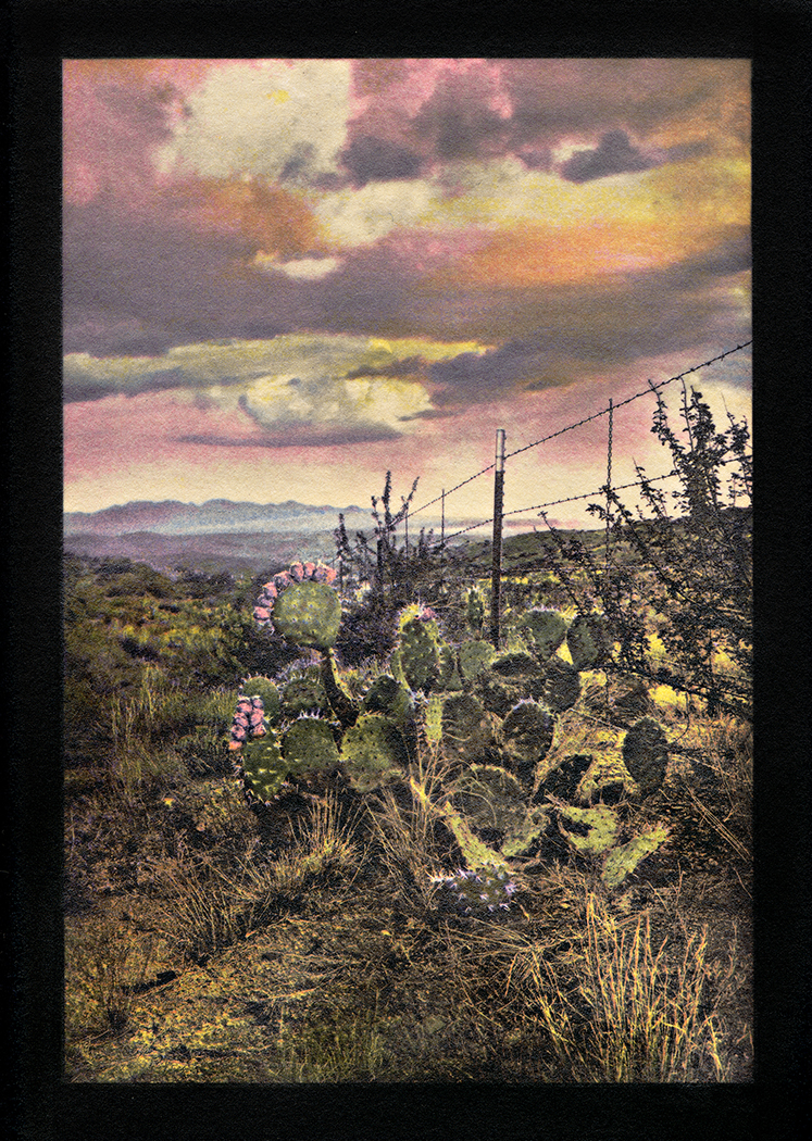

but you can do some hand coloring in Photoshop on your B/W image and then separate the channels, print them and make a tricolor print.

+1 on hand coloring then channel splitting. Lots of fun. Good luck!
