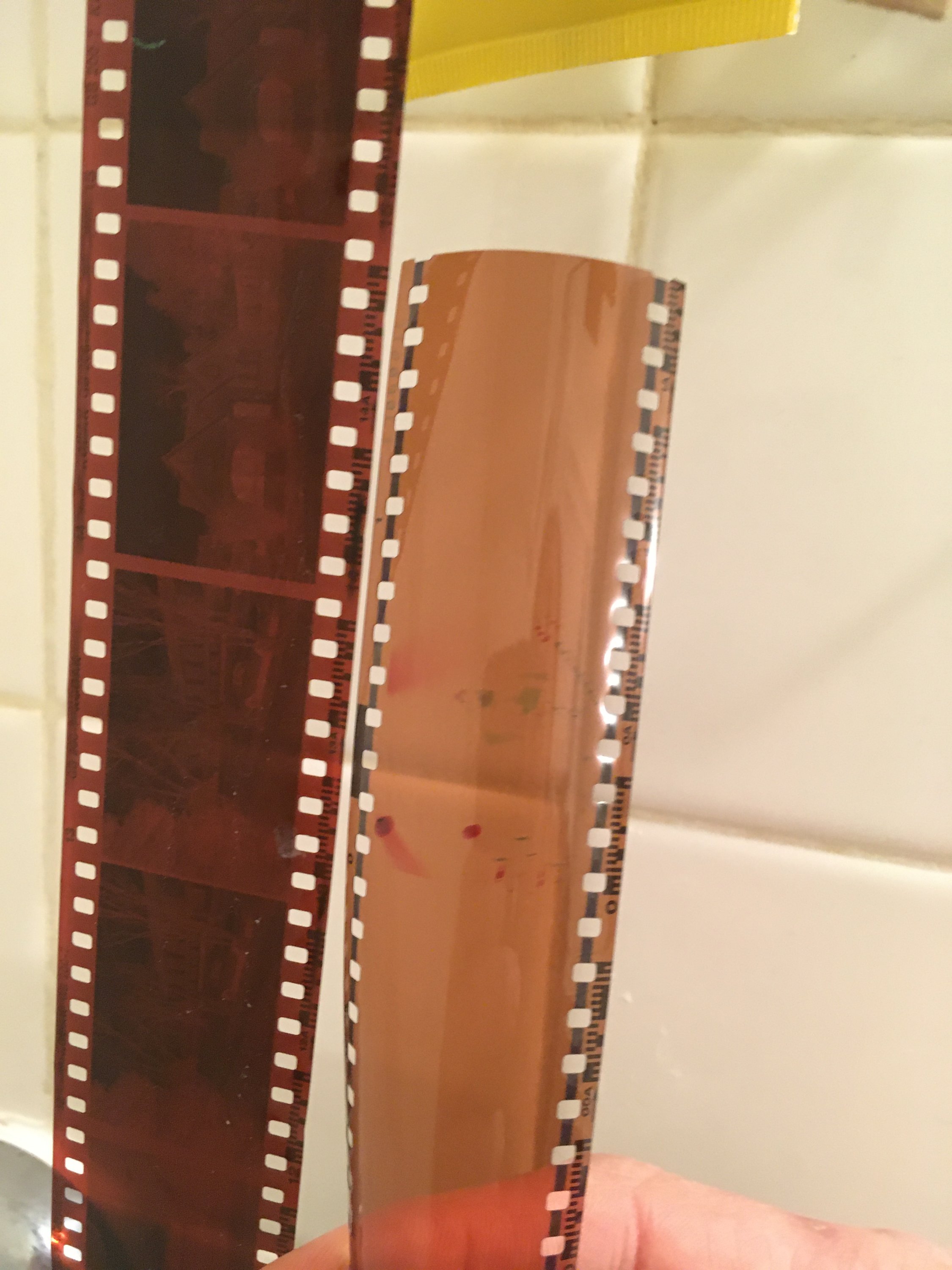

This wasn't a ferricyanide bleach, or was it? If it was, you might try soaking those strips in a carbonate solution (let's say 1%; it's not critical) and see if there's any change.

Looks like magenta-forming layer may have some fog.
I've read about a magenta cast due to active developer getting into the (alkaline) fixer with C-41 -- this was originally attributed to use of ferricyanide based bleach on Fuji materials, but later found to be not brand specific. Thiosulfate is a mild fogging agent, so if there's active developer in the fix, you can get some development of fogged halide before the fixer can dissolve it, leading to yellow and magenta layers (the top ones) showing most -- but since magenta dyes are stronger than yellow,and there usually won't be much of this because C-41 fixers are so fast, what you see is a magenta cast on the negative. The slower your fixer, the more this effect will be visible if it occurs.
Fixes for this are to ensure that all developer is washed out of the film before it gets to fixer (add a short wash step between dev and bleach and between bleach and fix), and/or to use a faster fixer (add some thiocyanate to the thiosulfate based rapid fixer). Another possible option is to use acidic fixer (to prevent developer carry-over from being active), but C-41 is designed to have mildly alkaline fixer.

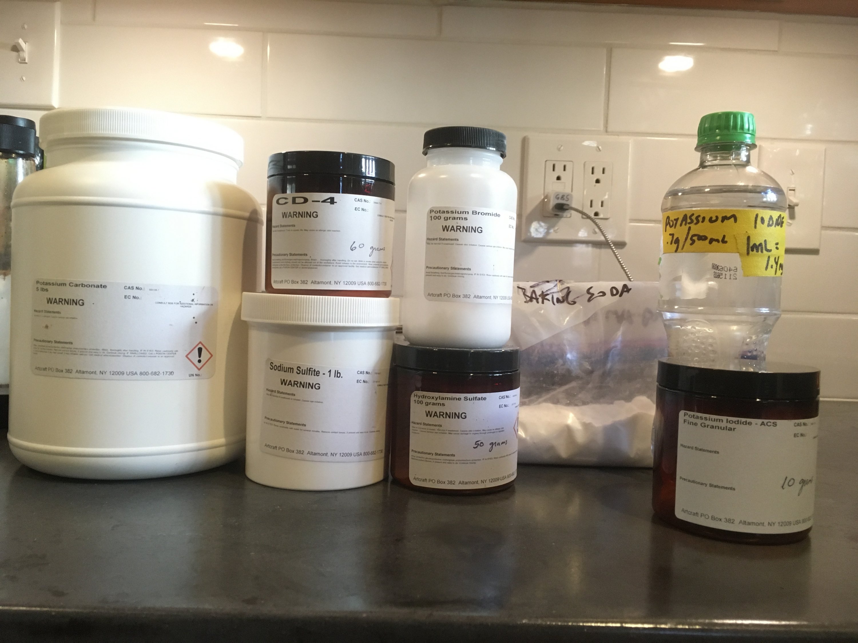

@Rudeofus I agree; this is really strange. I did not substitute any chemicals, and triple-checked this time. Same results as last time, so I'm beginning to suspect something I have is off/wrong. Here are photos of exactly what I used. (I'm not sure how it happened, but I see I am 0.3g/L short on CD-4. Obviously that needs correcting, but will that alone result in the major shift?)
The following chemicals pictured above were also used in my ECN-2 batch with no problems:
Sodium Sulfite
Potassium Carbonate
Potassium Bromide
Sodium Bicarbonate (baking soda)
If a chemical is wrong, it would lead me to believe it's one of the ones I did not use in ECN-2:
Hydroxylamine Sulfate

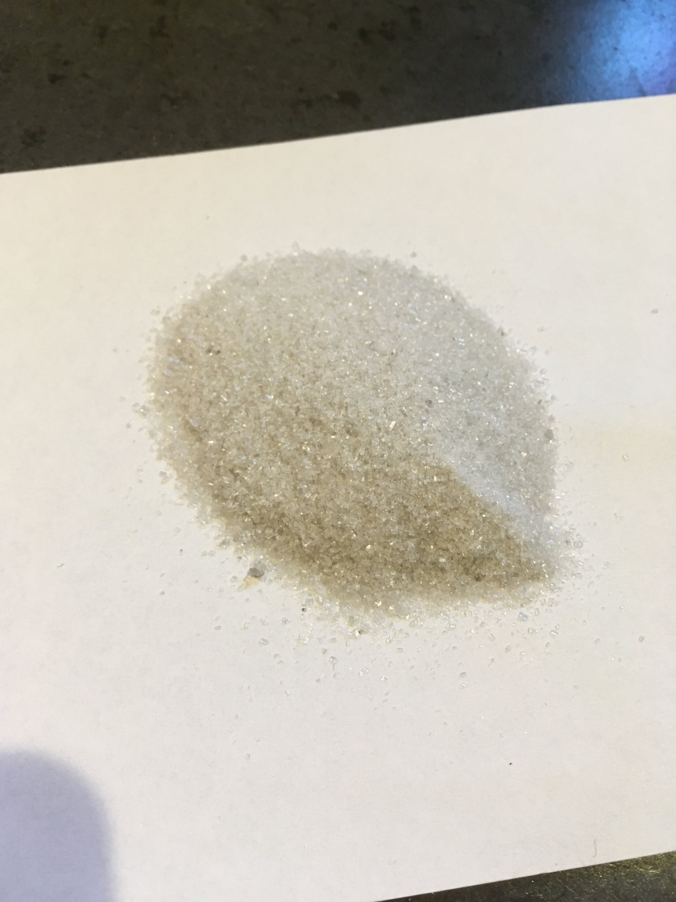

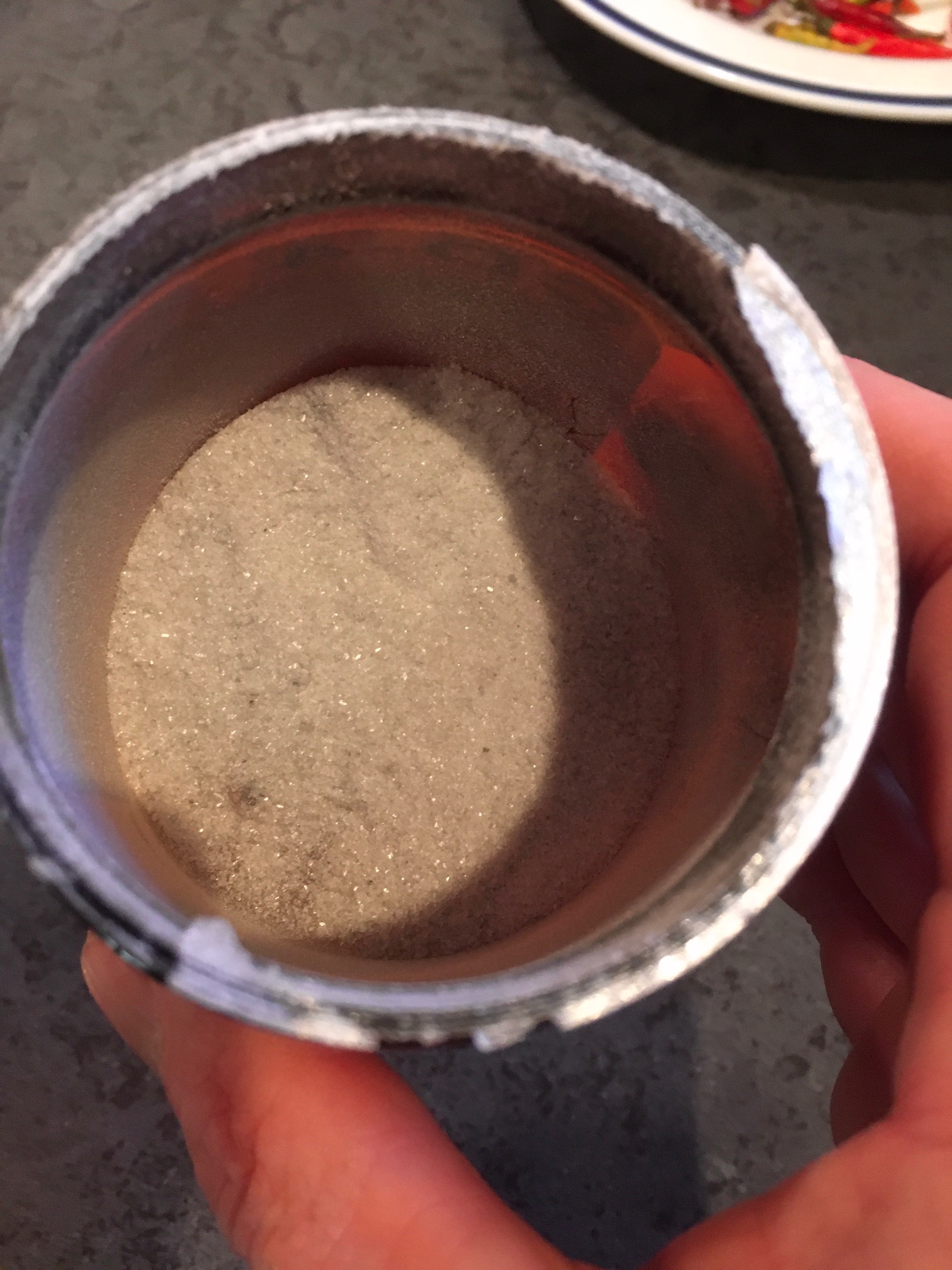

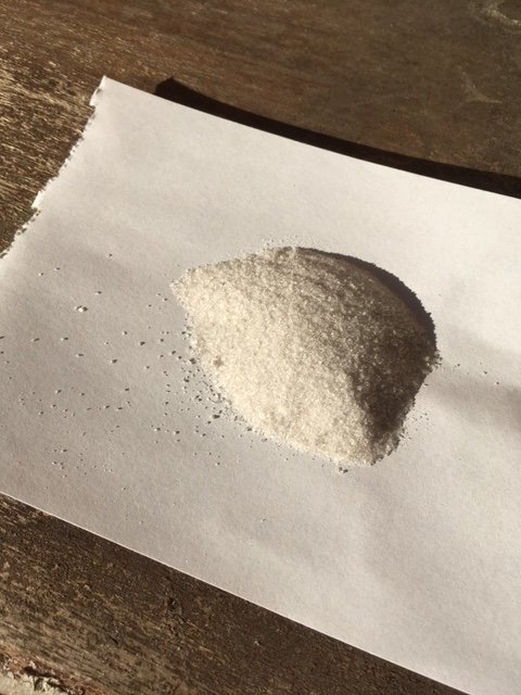

What color is CD-4? Mine is a grey/beige. I’m attaching photos. The one in the jar most closely resembles what it looks like to my eye under those lighting conditions.
DE963DF7-F5F7-472F-BCE7-8872CC2465E5.jpeg 11B52667-F9B8-4C93-BA58-11E5C29E957D.jpeg 8C61C227-19AF-4273-AFE7-4DC1F2F5ADE9.jpeg

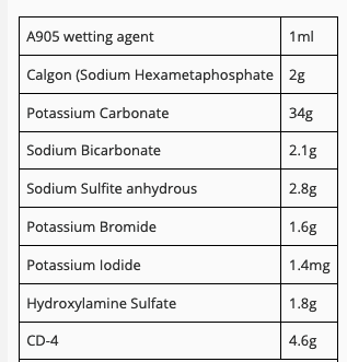

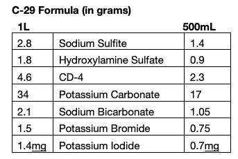

I'm using C-29 from here, with 1.5 KBr as recommended here
Screengrab from my working printout (in mixing order), which omits A905 and Calgon
I got a small sample of CD-4 from Artcraft I can try next time, but he said he hadn't gotten any complaints so it seems unlikely that's it.
