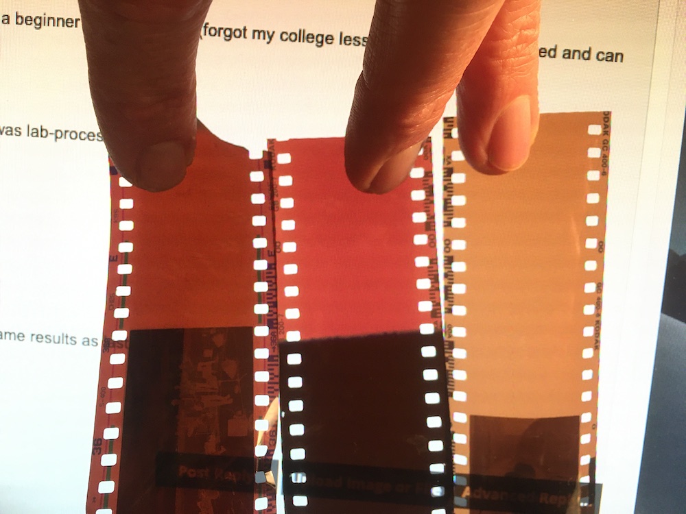

Hi,
I've successfully developed a half-dozen Vision 3 rolls in ECN-2, still testing that out. Hoped to have more to report, but it's a slow-going affair.
Tonight I tried C-41, rather, C-27 which I got from @stefan4u here:
https://www.photrio.com/forum/threads/color-negative-developer-near-to-c41.42731/#post-612215
I *thought* I mixed everything correctly, but have my doubts now. What are some causes of this? It happened to this roll, and a test strip that was stored separately, so I don't think it's fog. (I omitted Calgon and A905, mixed with distilled. I do not have a pH meter).
(on the left, tonight's process - Superia film. on the right an example of lab-processed Fuji as a comparison)
I re-fixed for 4 extra minutes and that didn't help. Then I processed a roll of ECN-2 (in separate developer) and used the same fixer, and the ECN-2 came out fine. (The fixer I'm using is C-41 fixer my lab gave me to use for tests).
I'm using ferricyanide bleach with lots of washes before and after, plus sodium sulfite in the stop, as well as a sodium sulfite clearing bath after the bleach.
There are a lot of possibilities. I'd suggest to start out with a short piece of leader, same film as your problem roll. Bleach and fix, only, then wash and dry. Then see if it cleared ok. If it did, you know that your fixer is functional (the bleach step was to take out the possible silver yellow filter layer).
Next take a short strip of unexposed film, develop, bleach, fix, then wash and dry. So it's just like your previous test, except that developer was added. So if the base stain increases, you can probably blame the developer.
This would be a,start.

How long are you bleaching? Ferricyanide bleach is slower working than the EDTA based bleach the commercial lab would be using, and if the film was under-bleached you might still have part of the silver filter layer present (which would appear in the rebates as well as the frames). Try rebleaching, for at least 8 minutes at 100F, followed by a full fixing period?

@Mr Bill, Solid test I hadn't thought of. Thank you. I don't have any more film from the problem roll. But I can do that with a different roll from the same batch. Thanks!
Hey @Donald Qualls. Thanks for asking. Bleaching for 3 min, based on the ECN-2 times from from Kodak for that same bleach. I know they're different chemistry, but didn;t think to adjust the bleach time. I'll try to re-bleach for 8 min, then fix--as well as Mr Bill's clip tests. That should help narrow it down. Thanks a ton.

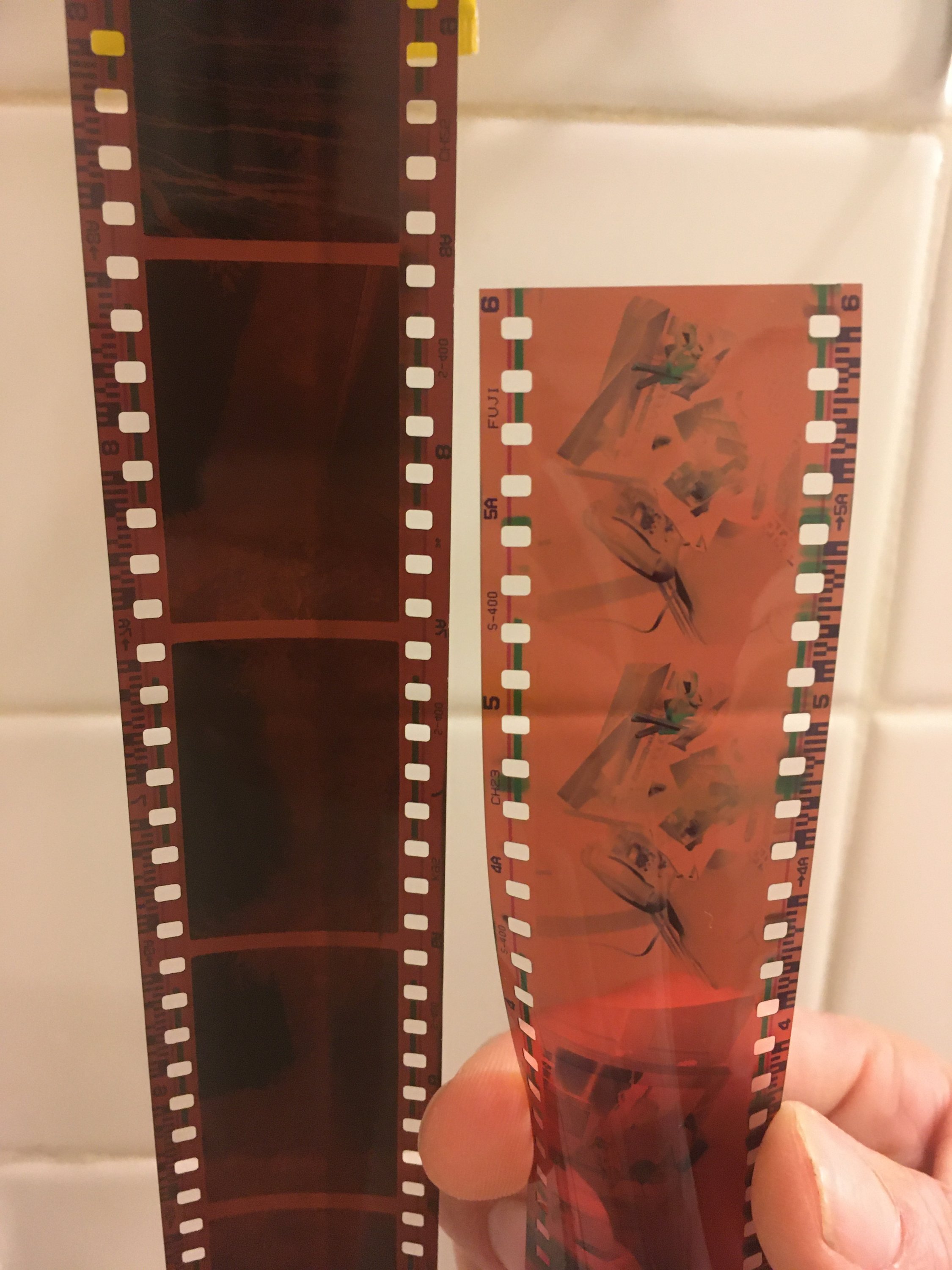

It does look like insufficient bleaching at first glance, but as you point out, ECN2 bleach is pretty vigorous and I wouldn't expect C41 film to be harder to bleach than ECN2 film, but I haven't tried the ECN2/ferricyanide bleach on C41 - apart from rescuing an insufficiently bleached part of film on occasion, which did indeed clear fine in ferricyanide bleach.
I'd suggest something along the same lines Mr_Bill does, but I'd also verify if the fix step is successful. So clip a piece off this processed film, fix it for e.g. 10 minutes in fresh 1+4 B&W fixer. If this makes a difference in density (just hold the dried! test clip next to the rest of the film), you know you have a fixer problem to take care of. If this doesn't do anything, re-bleach the same strip and fix consecutively. Again check the difference. If that doesn't yield any change, you know you have to look at either the developer itself, or the interaction between the developer and the bleach. The latter is a bit unlikely to be a problem given your careful wash steps, so all considered, I'd expect the bleach is the most likely culprit for now.
Just to be sure - you're not comparing very outdated film to fresh film in that photo, are you? I often use 20-year old Superia 200 and compared to fresh film, it gives about the same overall density difference.
Also, to get the development consistent, I'd definitely suggest getting that pH meter if you're DIY-ing your developer. I suspect you're waiting for yours in the mail since our last conversation :wink:

I appreciate the thoughtful suggestion. I got a few tests done while I still had everything out.
1) rebleached roll in question for 8 minutes, then fixed and rinsed - no change.
2) clip test (new roll): bleach, fix - normal, clear base
3) clip test (new roll, unexposed): develop, bleach, fix - normal, clear base

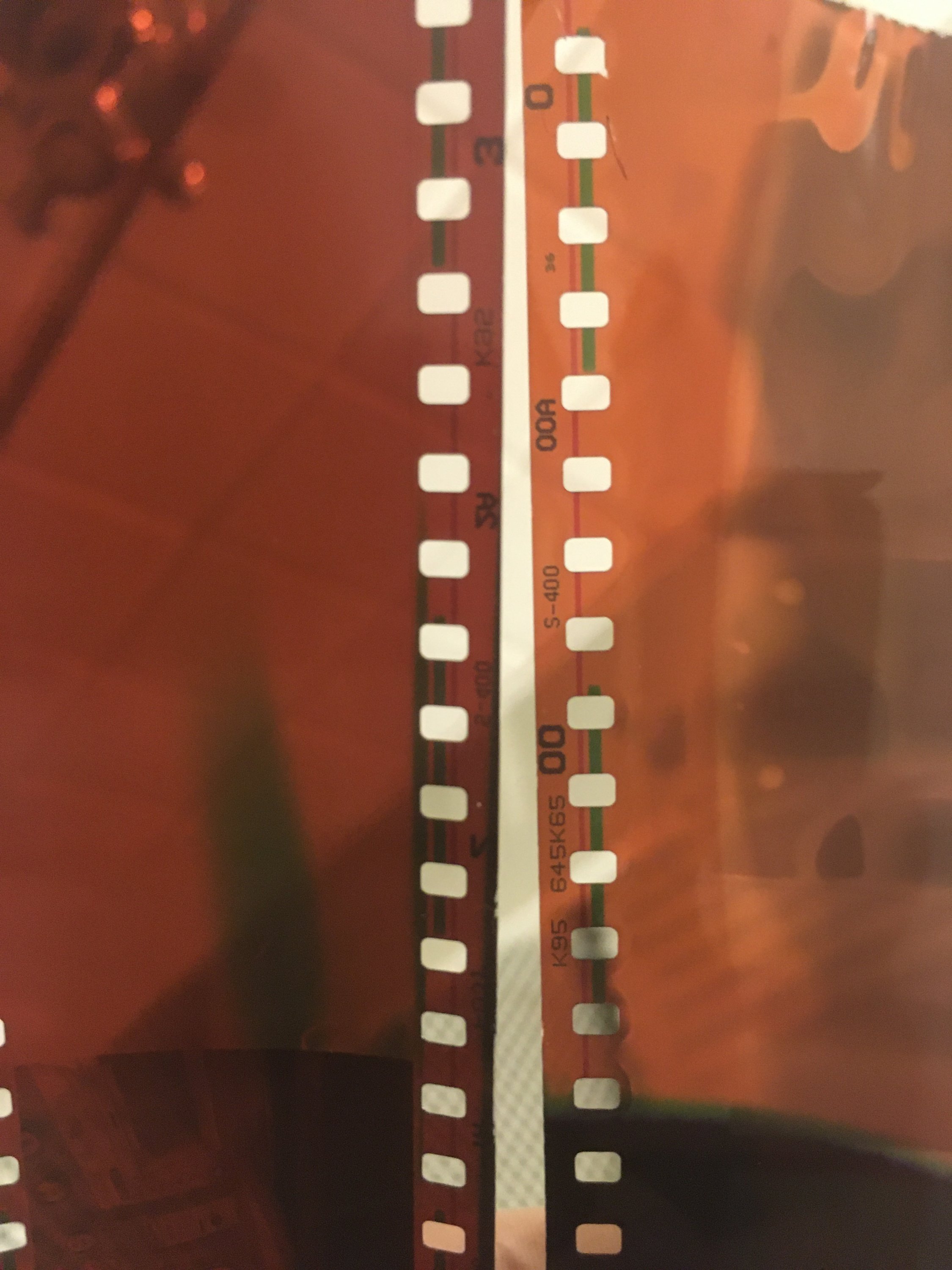

L- original roll / R- new roll clip test. unexposed and fully processed
I don't *think* the original roll was expired, nor was it exposed to extreme heat, but I cannot say with full certainty since it was a test roll that bounced around a couple cameras over time. Based on the test results from the new roll, I'm starting to suspect the film for whatever reason. Just odd/ironic that it would be my first attempt. I'll shoot a few frames with the new roll and run those through next time--since I know the new rolls is clearing normally.

Yeah, I think it might just be the film. There's also an interesting streak of cyan fog in that last picture you posted, suggesting something didn't go entirely as planned with that part of the film.
Honestly it looks pretty similar to what I get from my 20 year old (stored refrigerated) superia 200.
I'm not sure if you have ra4 printing capability; if you do, I'd just make a contact sheet of that film and see if contrast and colors come out OK.
