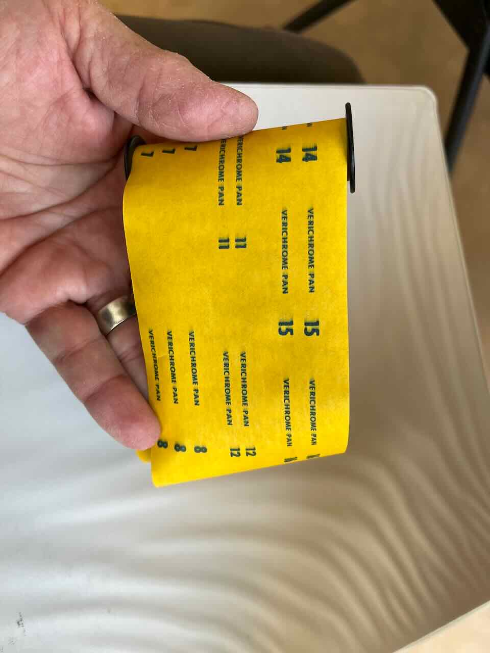

I recently bought a camera and when opening the back I saw quickly that there was a roll of 120 verichrome pan (iso 125) loaded.
I would like to finish shooting the roll but I’m not sure what decade it’s from. Verichrome Pan was produced from the 1950s-2000s and the camera is from the 40s.
Should I just shoot it at iso 2 or about 6 stops slower and hope for the best or can I more accurately guess the age of the roll based on the backing paper design?
The paper was yellow with only the frame numbers and verichrome pan written. I believe there were three rows of numbers too for the different formats.
I do not recall Kodak being marked anywhere or any other symbols lines or arrows. I could take a picture of the backing and uploaded it but I don’t want to further risk ruining the 5ish photos already exposed on the roll. Let me know what y’all think!

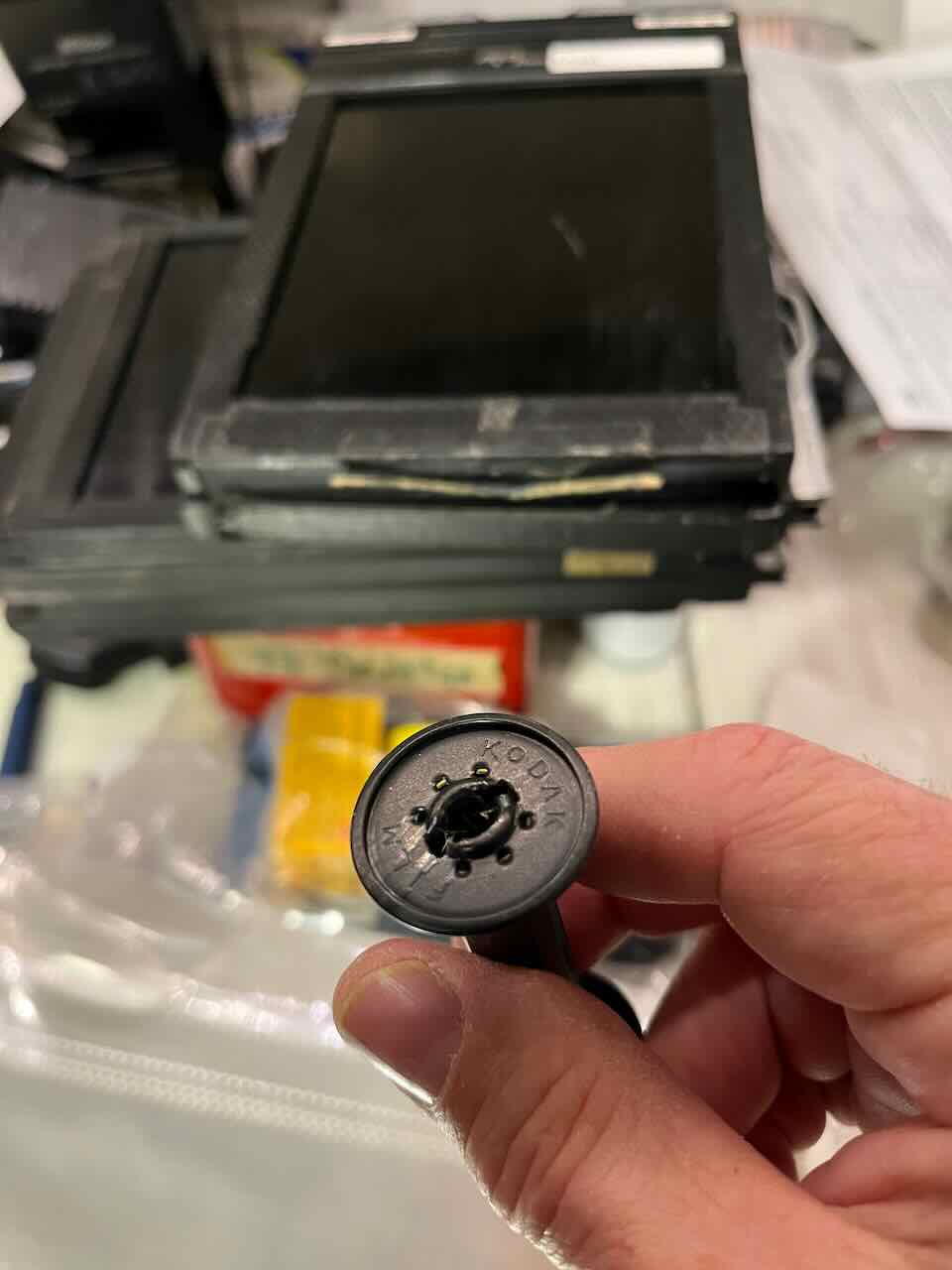

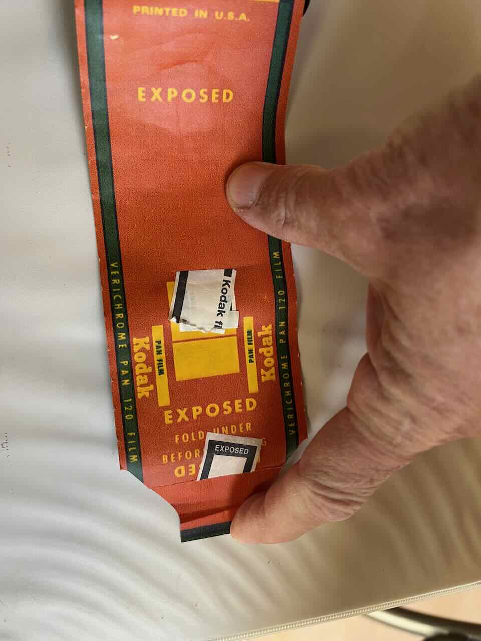

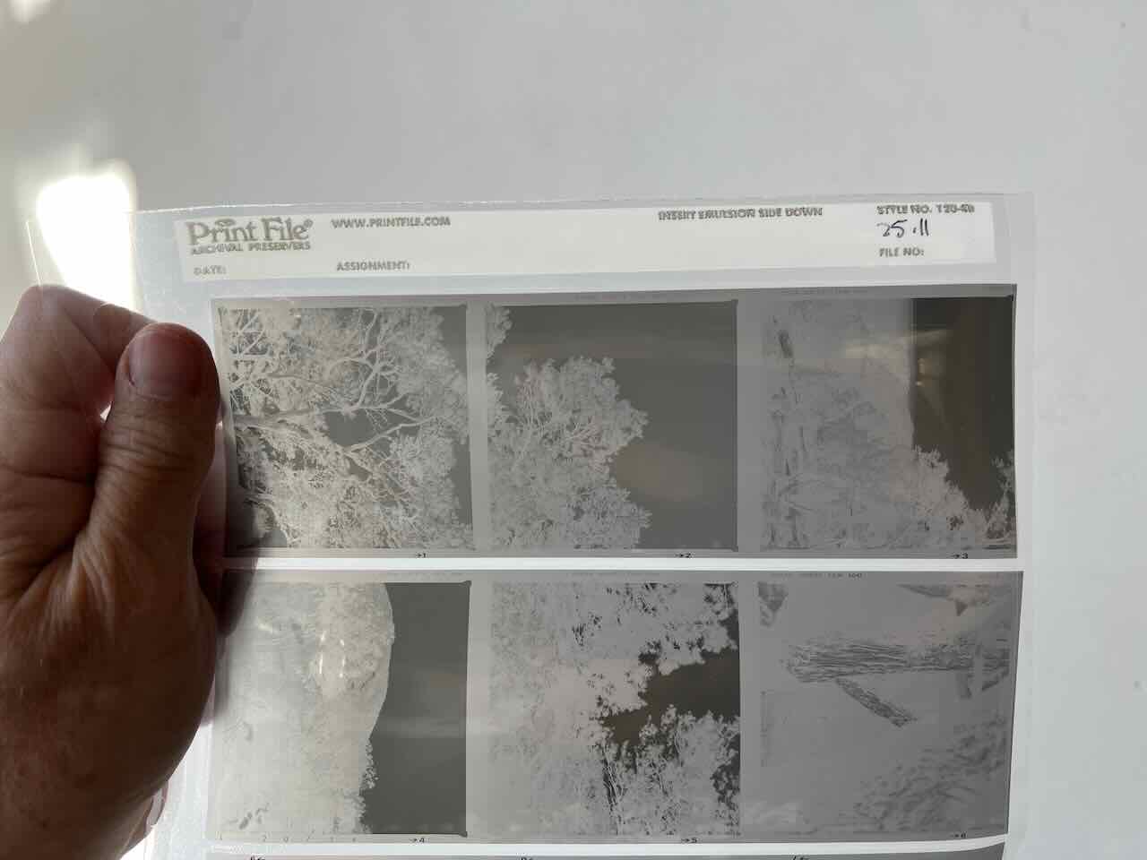

Verichrome Pan has an amazing lifespan, I am getting perfectly usable images from a brick from 1979--there is base fog, but will take some pics of the film and the backing paper after breakfast. It is well-known as one of the most stable films. Shoot it at 100 and develop normally. Unless you have some other reason, ignore what people are about to say about tossing it as worthless or that it needs benzotriazole (well, it could use benzotriazole, but not need).
Of, and after you take it out...metal reels were used in 1979, plastic in 1983. Not sure which year they switched.
I agree. Shoot at box speed or close to it.
These are from a 1979 batch. If you have a red window you can tell on the next frame...
Appreciate the input and pictures! The backing I think is identical so I assume can’t be much more than 10 years older at maximum. I’ll shoot at iso 100 and upload the pictures when I get them developed. Thank you!

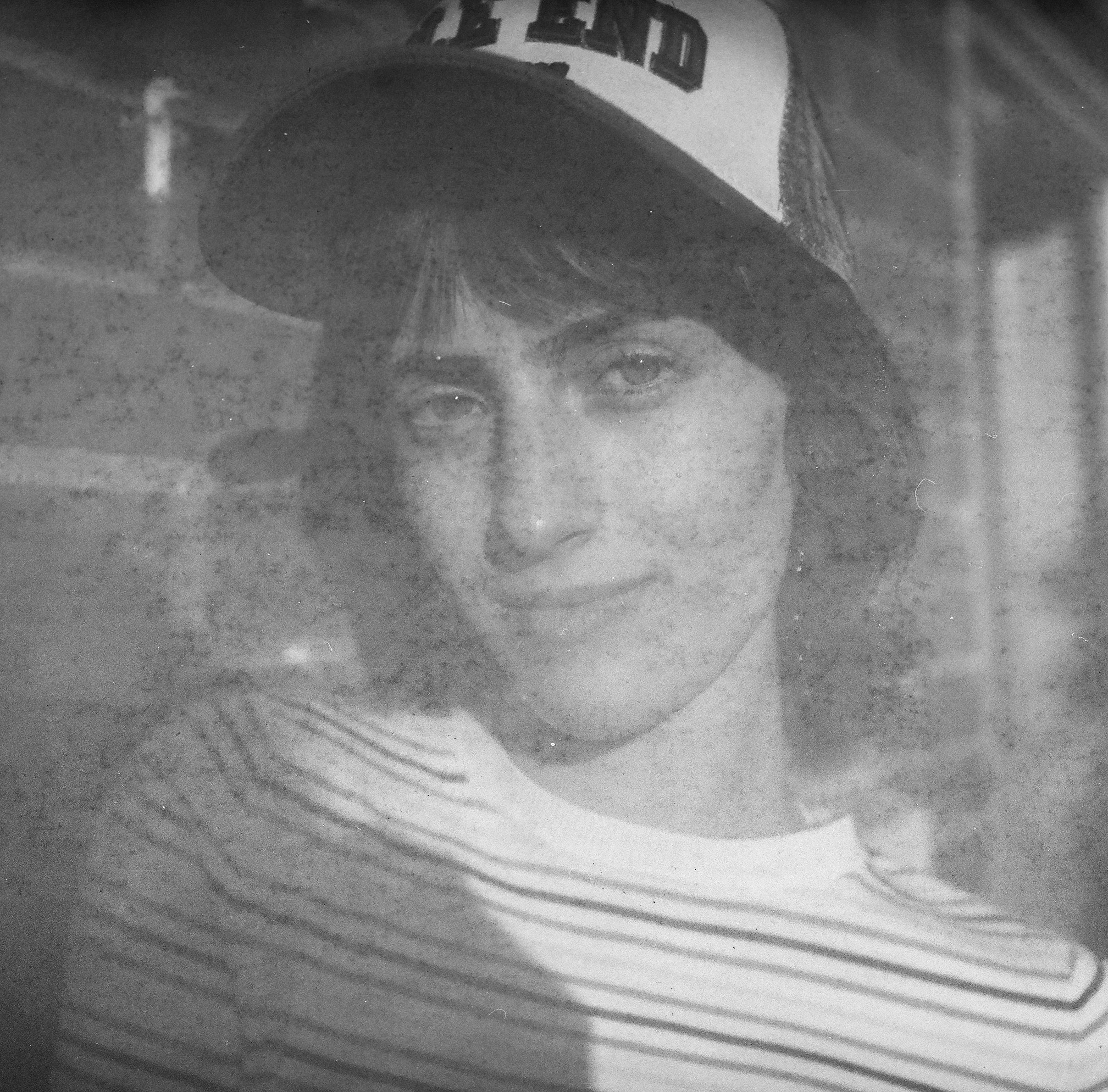

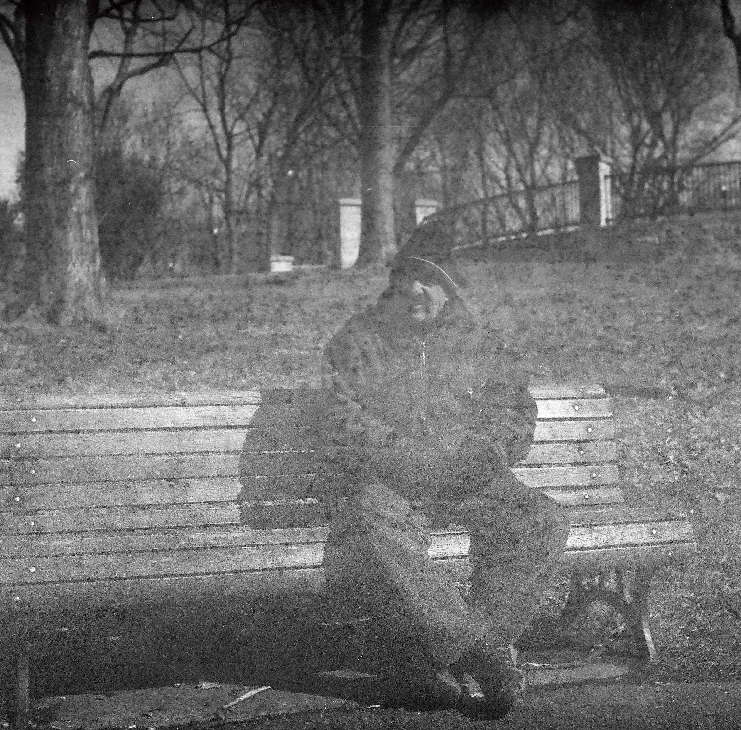

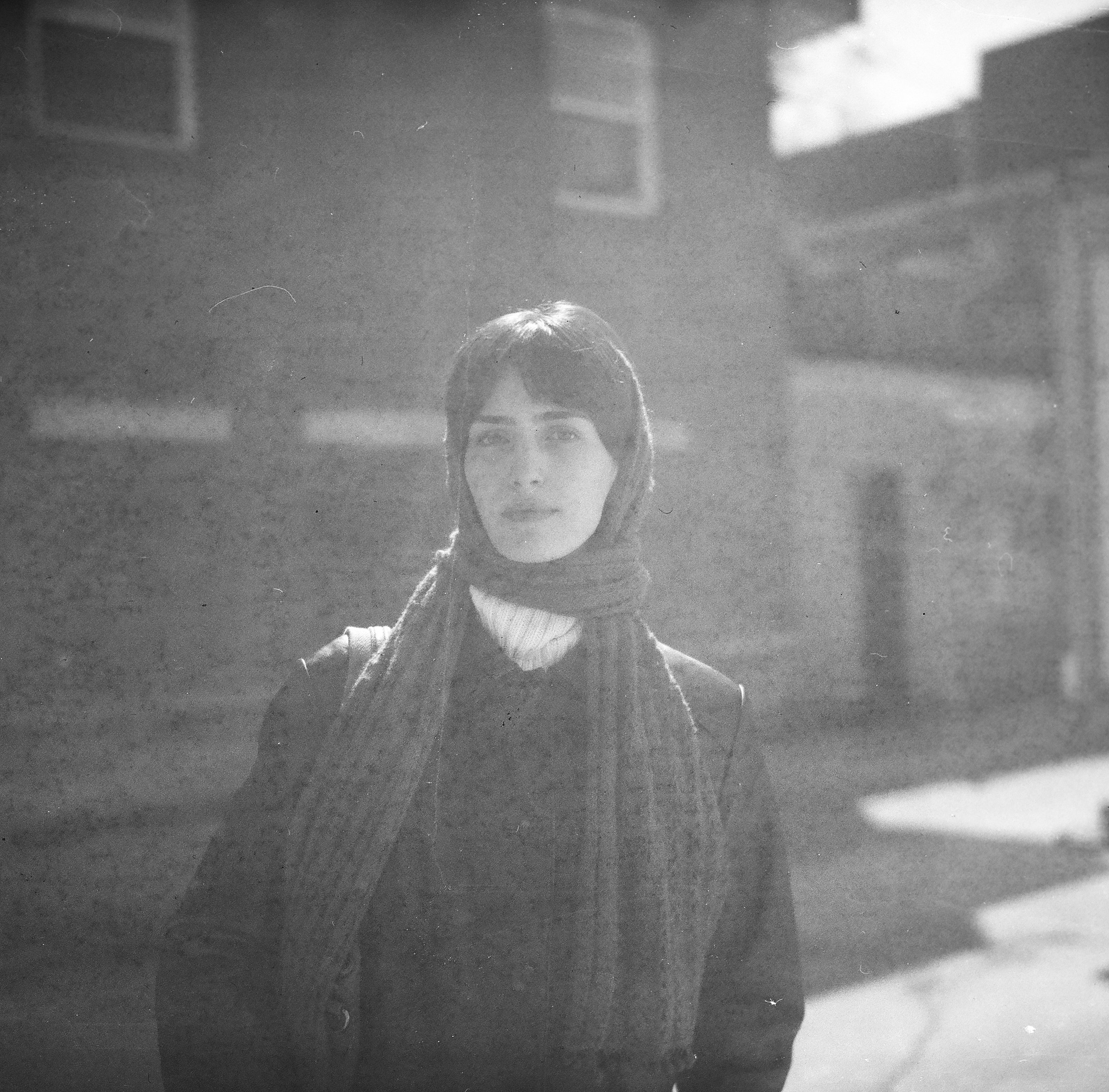

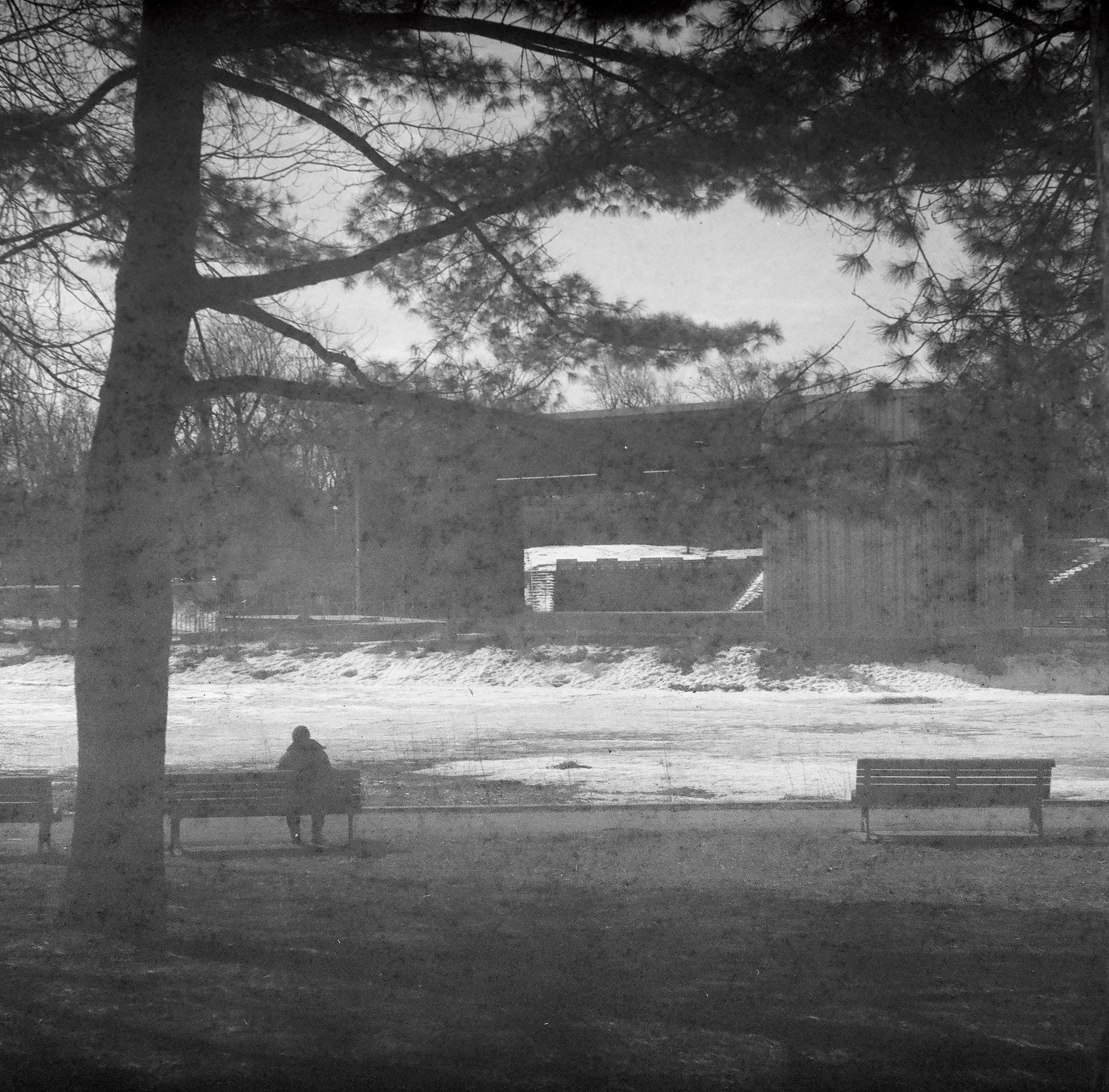

Finally got the scans back. The first 5 photos taken by whoever owned the camera before me weren’t sent so I assume they were completely fogged/light leaked. I’ll see when I pick up the negatives. Out of the 7 I took here are the better ones. Let me know what you think
