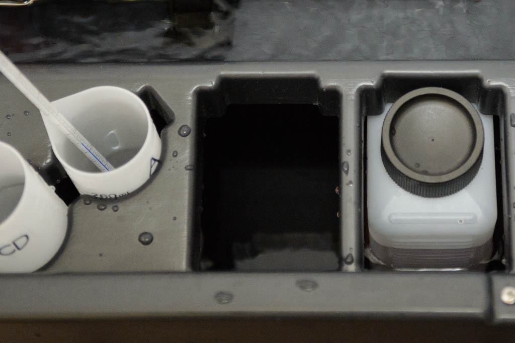

The highest possible water level only covers about 2/3 of the 1L bottles, less than half about the graduates. So that even when room temperature is around 30 degrees and CPP3 set to 38.0, the chemistry is just around 35~36; Still far from the C41 standard.

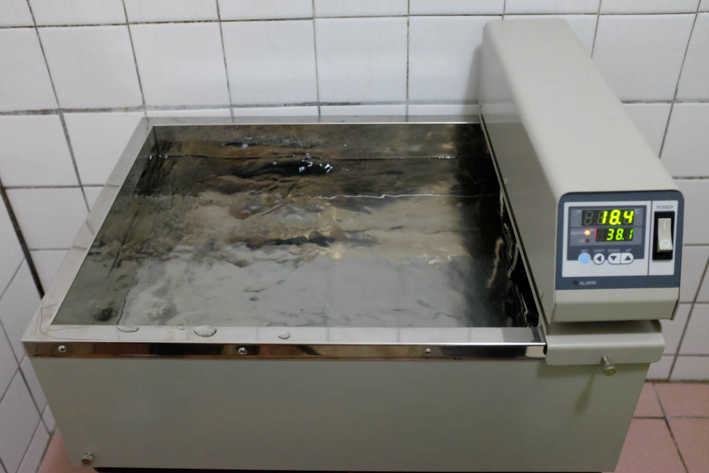

After two attempts on September I gave up and have another stand alone thermal static tank as the main chemical heater. The thermal tank serves much better, but that's additional cost add up to the already premium priced CPP3.

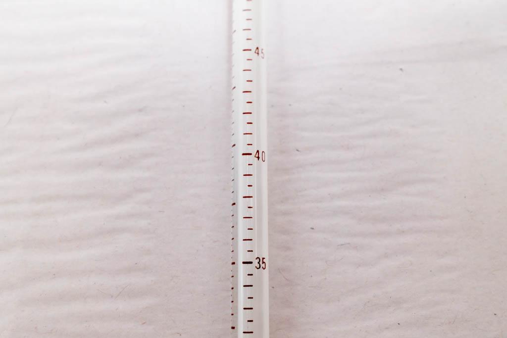

I adjust the temperature setting based on an accurate thermometer in the bottles, not what the display is telling me.

As Jerry Thirsty says always use a reliable, accurate thermometer to check the temperature of the measures. Always check inside the measures, not that of the heating water bath which can be 2-3 degrees warmer. I find for B&W I have to set the JOBO heater to approx 22c and for the C41 set it around 40c to get the baths up to the right temp. I tried it once as an experiment, setting the JOBO dial at 38c and leaving it overnight and in the morning the liquid in the measure after 8 hours was still only 36.3 degrees.

The level of the bath has to be increased once the pump is running to get good coverage of the chemical bottles and graduates when using the trough, you just have to either add a short hose to the overflow outlet at the back of the processor or drain some water off when you turn off the pump as the water level will rise in the trough and may well come out of the overflow and go over the working surface or floor if not sat in a bath or container.

In my CPA-2 I maintain the water level just slightly below the cap so that the chemistry is completely submerged. I always fill the unit with water that is about 5 degrees from the processing temperature and let it warm up and then mix the chemistry and insert. The temperature is monitored at the troughs outlet which gives an accurate reading of the temperature of the trough water. Its easy to maintain a constant temperature during processing by carefully monitoring the thermometer and making minor adjustments but the temperature is always constant throughout the developer cycle and usually remains so until the later steps when it may drift 1/4 degree but at that point its meaningless.

The Jobo heater really is not that efficient and it can't help me to maintain my chemical at around 37.5 degrees without overshoot the water bath temp too much. And by adding another thermal tank takes extra cost and footprint to the whole system.

I use two thermometers (both Paterson) and find them quite accurate. They even agree with my thermal tank down to 0.1 degree which surprised me when I did the test. I am not after the brand but quite happy with them so far.

In order to have the highest possible water level, after the water bath fills I add more water to the trough until it starts overflowing a little bit from the back outlet. Even by applying this measure it can only covers about 2/3 of the Jobo 1L bottle, which only brings my chemistry to about 2~3 degrees lower than the water bath.

Yes, you are being a bit too critical. The norm is to set the Waterbath temperature to 2° above the processing temperature to allow for the difference in chemical temperature/cooling of the drum in use. If your Jobo needs to be set at 40.5° to give you a chemical temperature of 38° then so be it, or process at a slightly lower temperature and adjust the time to suit.
