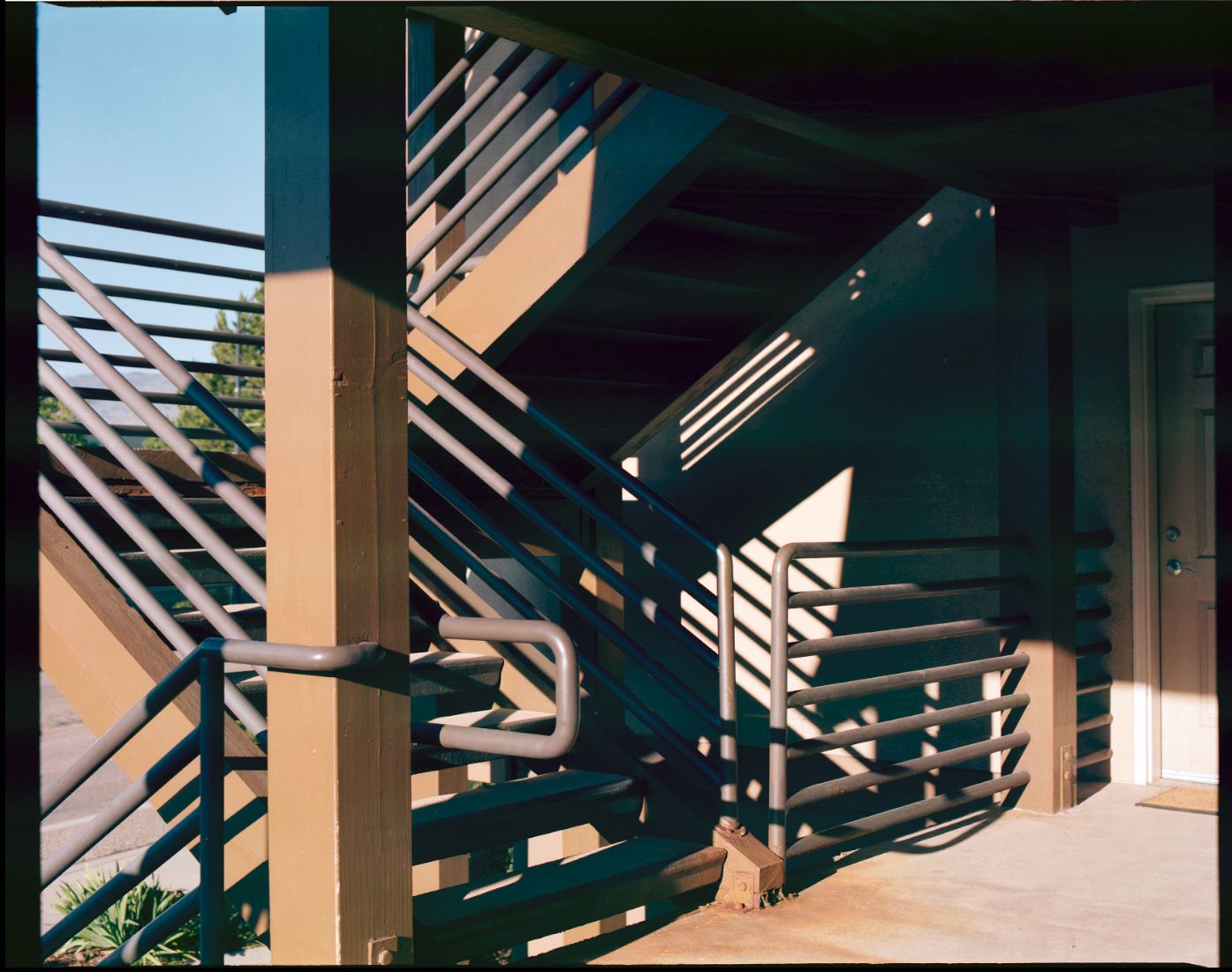

I'm having an issue and I'm trying to determine if it's a scanning issue, or a lab/develop issue.

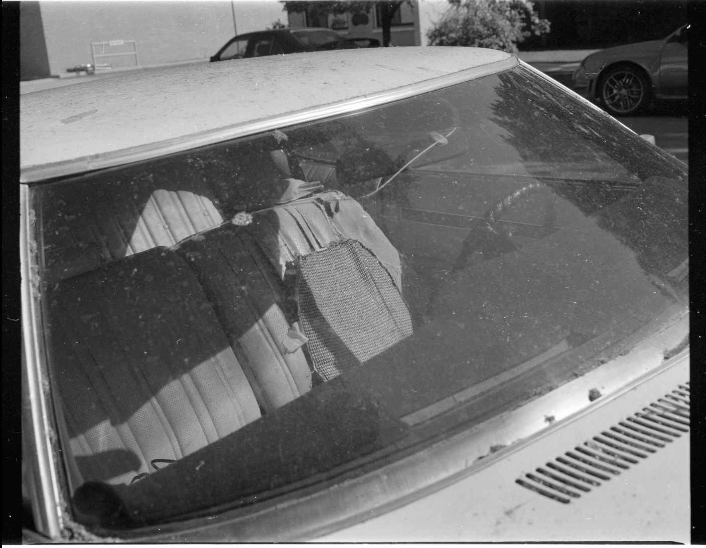

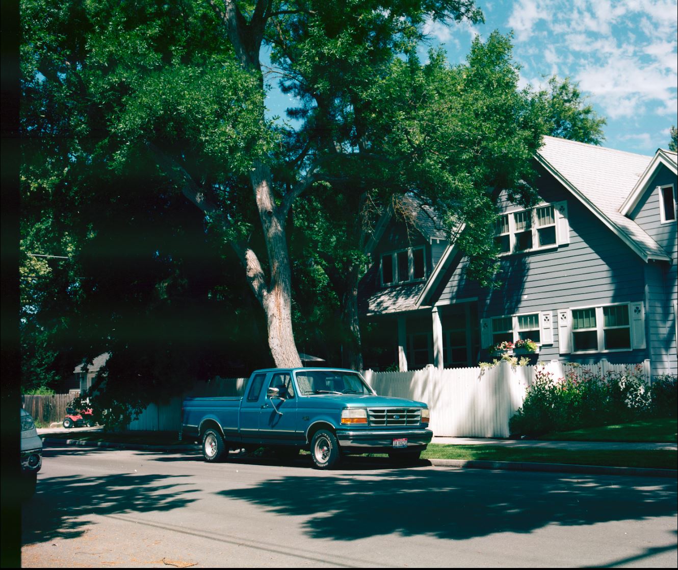

In all of color negatives I'm having these green lines running through them, in b&w there are no issues. I'm hoping it's a lab issue, but they permanently closed the day after I picked up these negatives so I don't have the option of talking with them. I've attached a photo from separate porta 400 rolls that are exhibiting the green lines, and b&w that doesn't have any issue.
Thanks in advance for the info!

Also, I should note, I'm scanning these myself with an Epson V600 and Negative Lab Pro.
Thanks!

Matt, the lines are there, look at the stairs image. There are 3 of them, center and on both sides equally spaced.

Every scan on flatbed with lines caused by dirt has sharp line that has no detail of any kind. Not the case here, hence I don't believe it can be a dirt in this case. Note also the location of these lines, a near impossibility to have dirt so perfectly spaced out.
There are actually more than 3 lines, all equally spaced and also outside the image, so running all the way across the scan. If negatives look clear on that, I would try a different USB cable or different software.
Also, as for B&W frame, have you scanned as grey scale or color? If grey scale, then try to scan it as color neg and see if you get the lines. I always scan B&W negs in color mode, never tried my case in B&W mode, so no idea if I would have had similar difference. If color mode produces the lines on B&W negs too, it might be software processing too.

Are these scanned in the same position on the film holder? If from multiple positions, then is there a way to rotate them 90 degrees on the scanner bed (or can you just lay them on the glass of the scanner and scan both ways?) to see if the lines rotate also. If so, then almost certainly the scanner is doing this.

After adjusting the angle of my screen I see the problem now - I was looking for thin lines, while these are wide patterns of lighter green.
Are the lines parallel with the edge of the scanning area or parallel with the space between frames?
The streaks show pretty clearly in the inter-frame space visible on the left side of the picture on "color 2.JPG". If you scan a known good film strip and still get the streaks blame the scanner. If the streaks aren't there blame the lab. If the lab was in financial trouble the machine might not have been maintained properly.

So I should have prefaced even futher, the scanner was brand new out of the box. I also went back and did these via dslr on a lightbox and had the same issues. I haven't gotten my hands on any other confirmed good film negatives to scan in, but I asked around and it sounds like other people were having issues with the lab.

But in that case you should be able to see the lines in the negatives, at least under a loupe.

Surely that is possible, except we now hear negatives show same stuff in other types of scanning leading to one conclusion: it's on the negative. Since these lines are equally spaced they now appear to me as from rollers or other in-path component in the processing machine causing streaked development.
