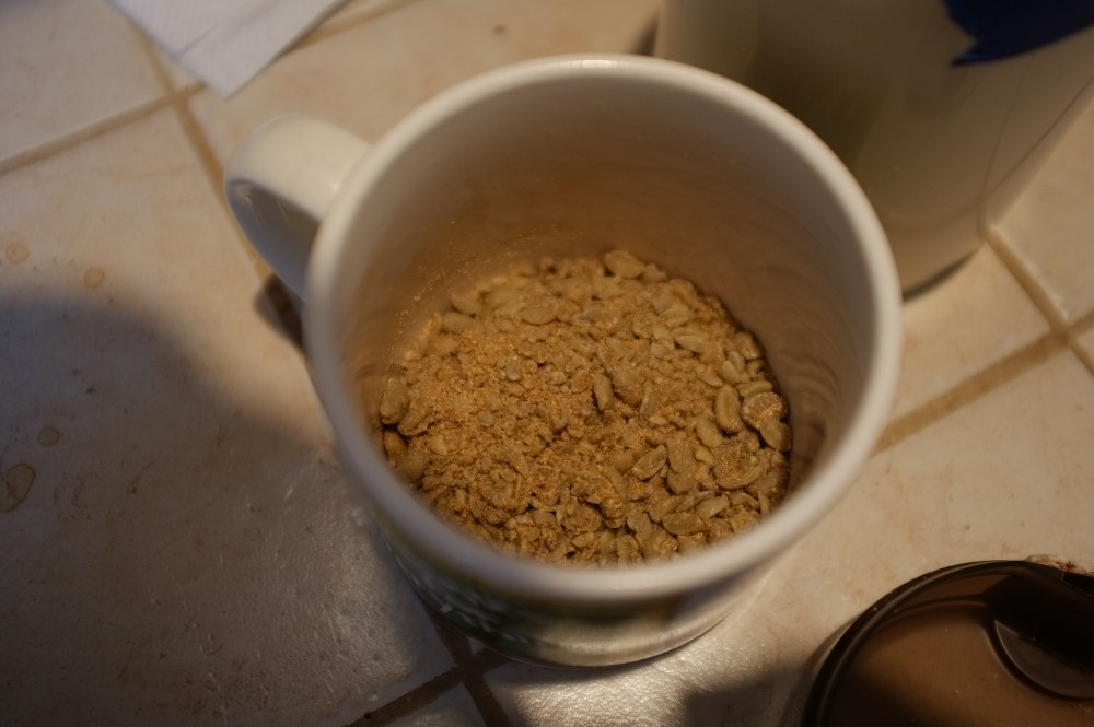

I took 1/3 cup of green coffee beans and put them into my whirly-blade grinder... it sounded like grinding rocks and the result was a mixture of powder, broken beans and whole beans:
attachment.php
A side benefit was that is scoured my coffee grinder so it is all clean and new looking ( but I wonder how dull the blades are now! ):
attachment.php

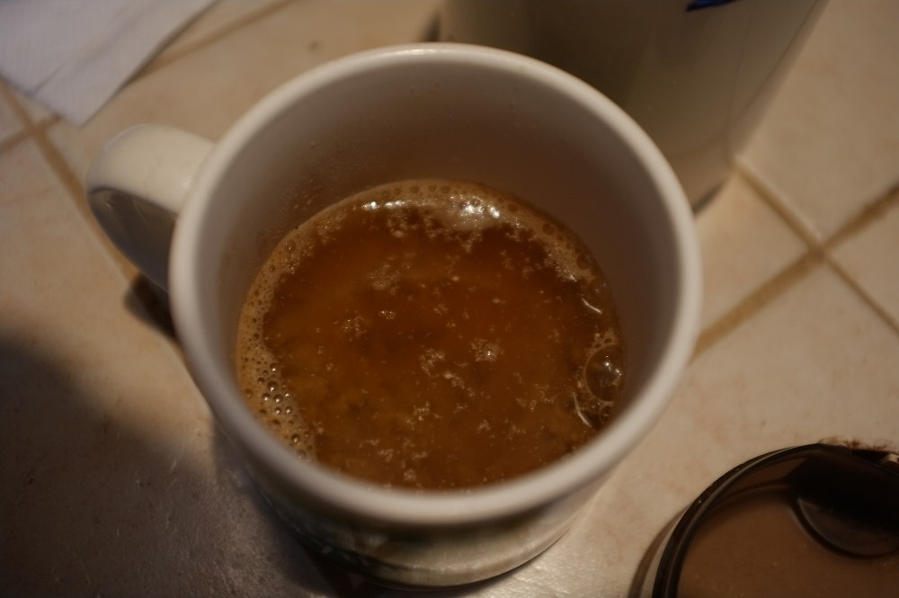

Then I poured boiling water over the result. After it cools I'll put everything in a bottle and let it steep for a few days.
attachment.php
Based on the legendary (there was a url link here which no longer exists), I expect this will work just fine to develop film if I add a little carbonate of soda. Not sure yet what I will try to develop or if I really want to put this goop into my developing tank... probably not. I think I'll make a pinhole paper negative and develop by inspection!

Update: the crushed/ground beans swelled up and absorbed ALL of the water. I added more water and now it is steeping. It looks like thick strong dark green tea.
And of course I tasted it.... not pleasant...Strong green coffee bean flavor.
These beans are left over because the roasted coffee did not have much flavor and not much caffeine. So they are kinda the opposite of robusta.

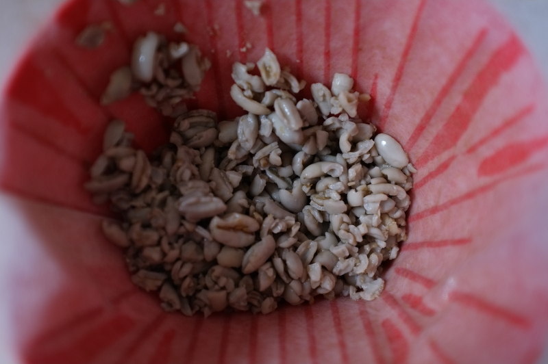

Here is what it looked like after steeping in the bottle for a day:
attachment.php
After filtering, there were 9 fluid ounces of liquid. The beans became pale and lost their green color:
attachment.php
