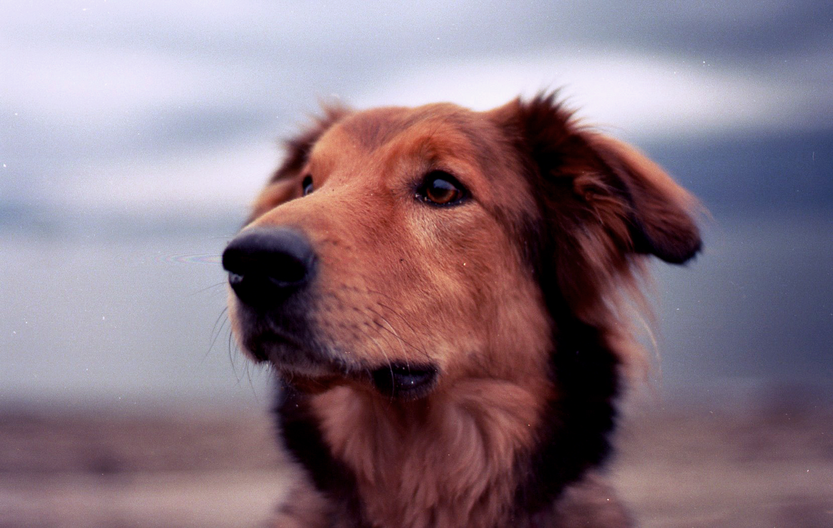

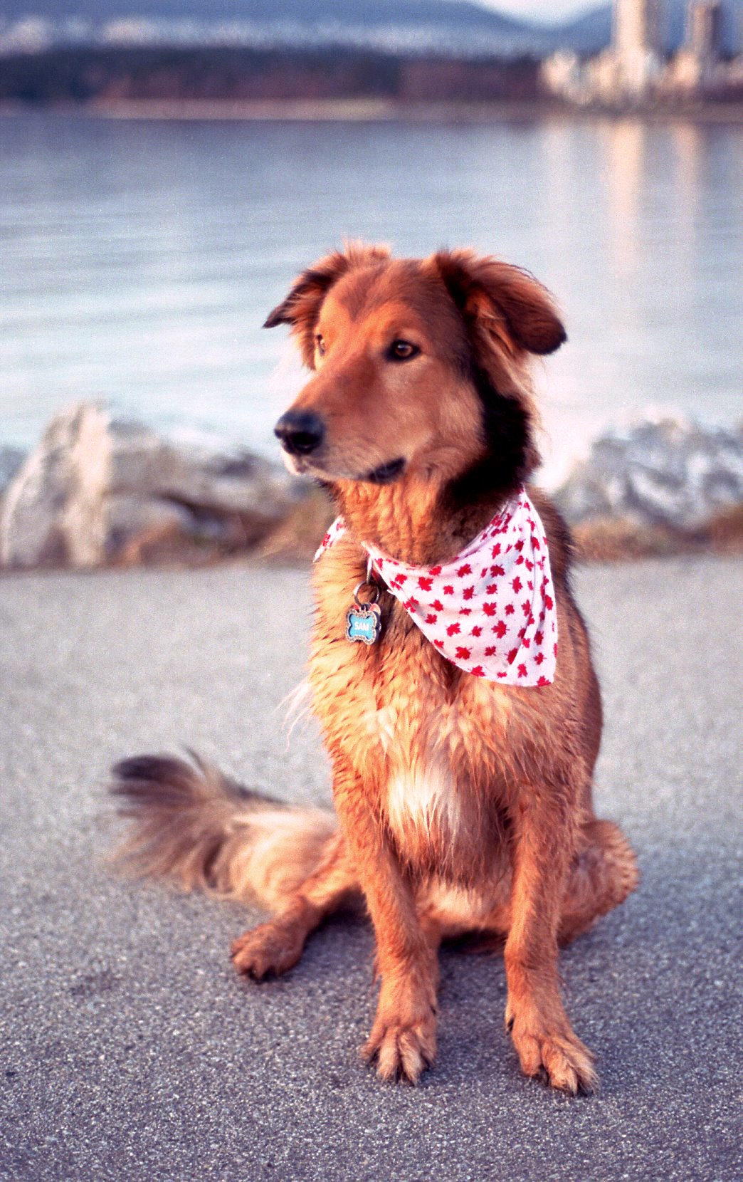

Here are two shots of my dog on very overcast days (ah, winter in Vancouver). The red in my dog's fur is not accurately captured, and things aren't this blue in real life, but that seems to be common for this film. Shot on Nikon F80 / 50mm f/1,8, scanned Epson V500 1200dpi (these are the compressed jpegs, the actual files are on a different HDD). No photoshop, etc.
How do you know it's the film? It could be your scanner, it could be your monitor, it could be the software rendering the image, it could be your video card driver, it's not always the film that is at fault. The best you can do is make an optical print, if you can't remove a cast in an optical print with a reasonable filtration, then blame the film. The best thing you can do, if you need it on the computer, is use the white balance feature in software and pick something white to balance on. If it can't correct the cast without making something else look weird, then blame the film.

Theese scans of that poor too cyan-too red dog are just weird garbage, technically speaking

I tried to fix the doggie: ektar cyan correct.jpg

Here is a sample with, as far as my eyes, monitor and video card are concerned, his fur being its true colour.

You can see it with the dog scans. Although the images were probably taken at short time interval and in the same light conditions the "raw" filtering of the two images is evidently different. The first is probably skewed toward red-magenta and the second toward yellow or green or cyan. That means two different filtrations have been applied by some layer of software, as the film, no doubt, is the same.
