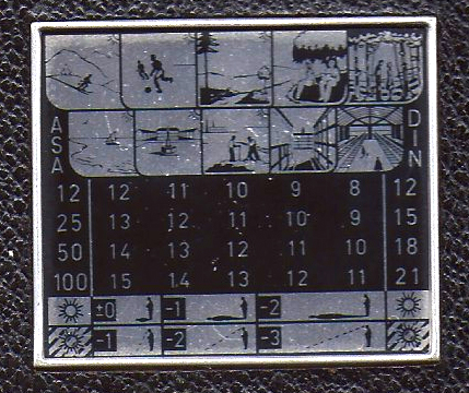

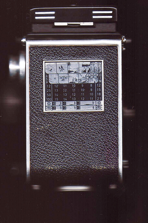

My simple exposure method for a beginner shooting ISO 100. :smile:
Something similar...
