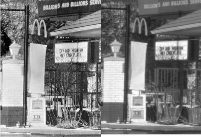

BetterSense
Aug 16, 2008
3,151
North Caroli
I have much better luck scanning prints than scanning film, especially when it comes to grain. Here is a comparison image of a 35mm color slide. I scanned the right side of the image with my Epson V500 at 6400dpi. The left side, I made a 4x5 internegative, contact printed it, and scanned the 4x5 print on the same scanner. It's disappointing that I get better results doing this even through 2 enlarger lenses than straight off the scanner.
http://i109.photobucket.com/albums/n78/daravon/sharp.jpg

@bettersense: Thats a lot of difference!!!! The scan is just an approximation of the original !!!!
