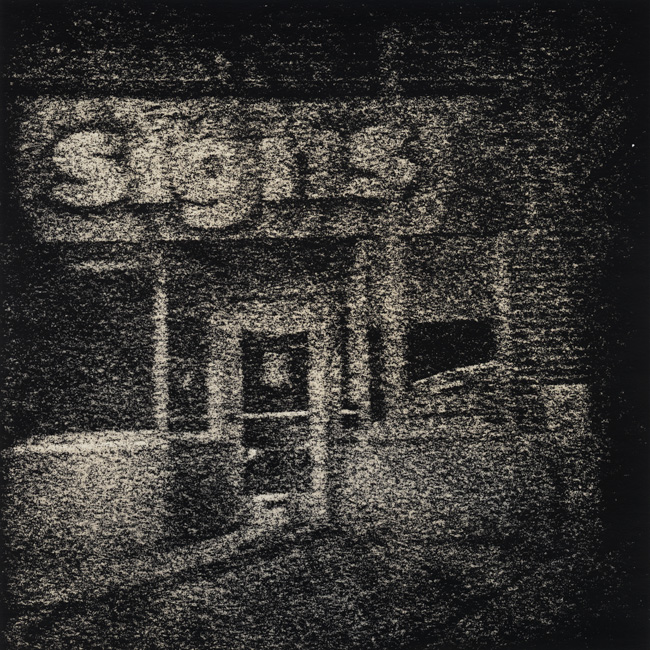

Easylith in general gives a pretty fine grain, it seems. The most pronounced grain I have gotten with any combination of paper and developer is Fomabrom 112 and Arista Powder Lith (from Freestyle in California).
Ilford MGWT and Slavich G4 gives a fairly grainy appearance also.
If you use negatives of moderate to high density and you have to expose for a long time, you can get some interesting grain that way.
Attached picture is Fomabrom and Aristalith, subsequently toned in sepia and selenium.
