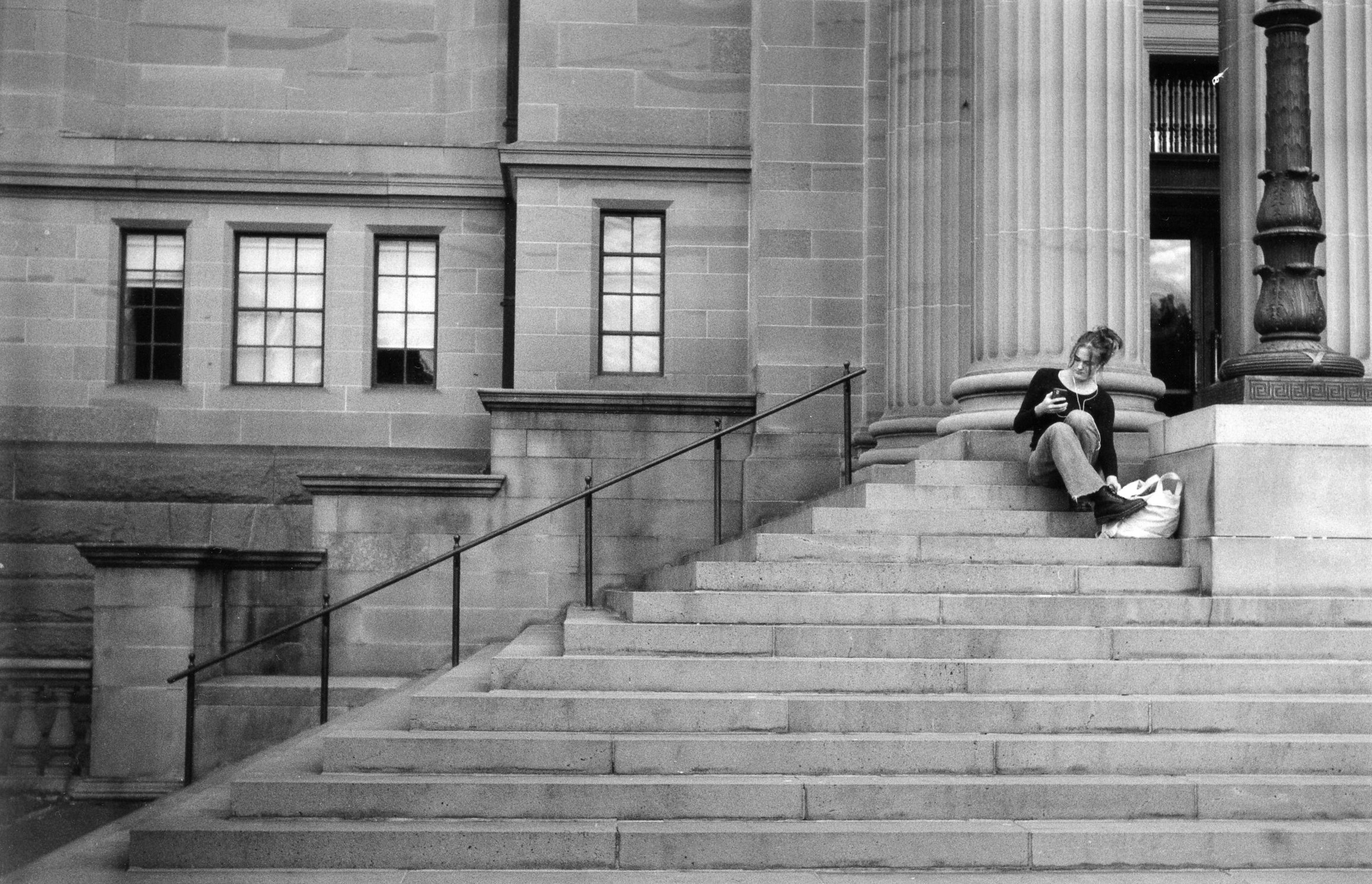

This is HP5 in T-max developer, printed with a Componon-S on 11x14 Ilford MGFB. I think it is pretty grainy.View attachment 346704
For the OP's benefit, I'd say that this very grainy for HP5+ too. It is quite a contrasty print, which will have exaggerated the grain; but I also wonder if T-Max developer is the best choice for this film (unless you like grain)?
On my own 12x16 prints from HP5+ (also on MGFB) I have to study the photograph stupidly close to see the grain at all. I've just looked at several prints to confirm this. I use a metol-only two-bath developer, and am generally printing at G2 ± 1.

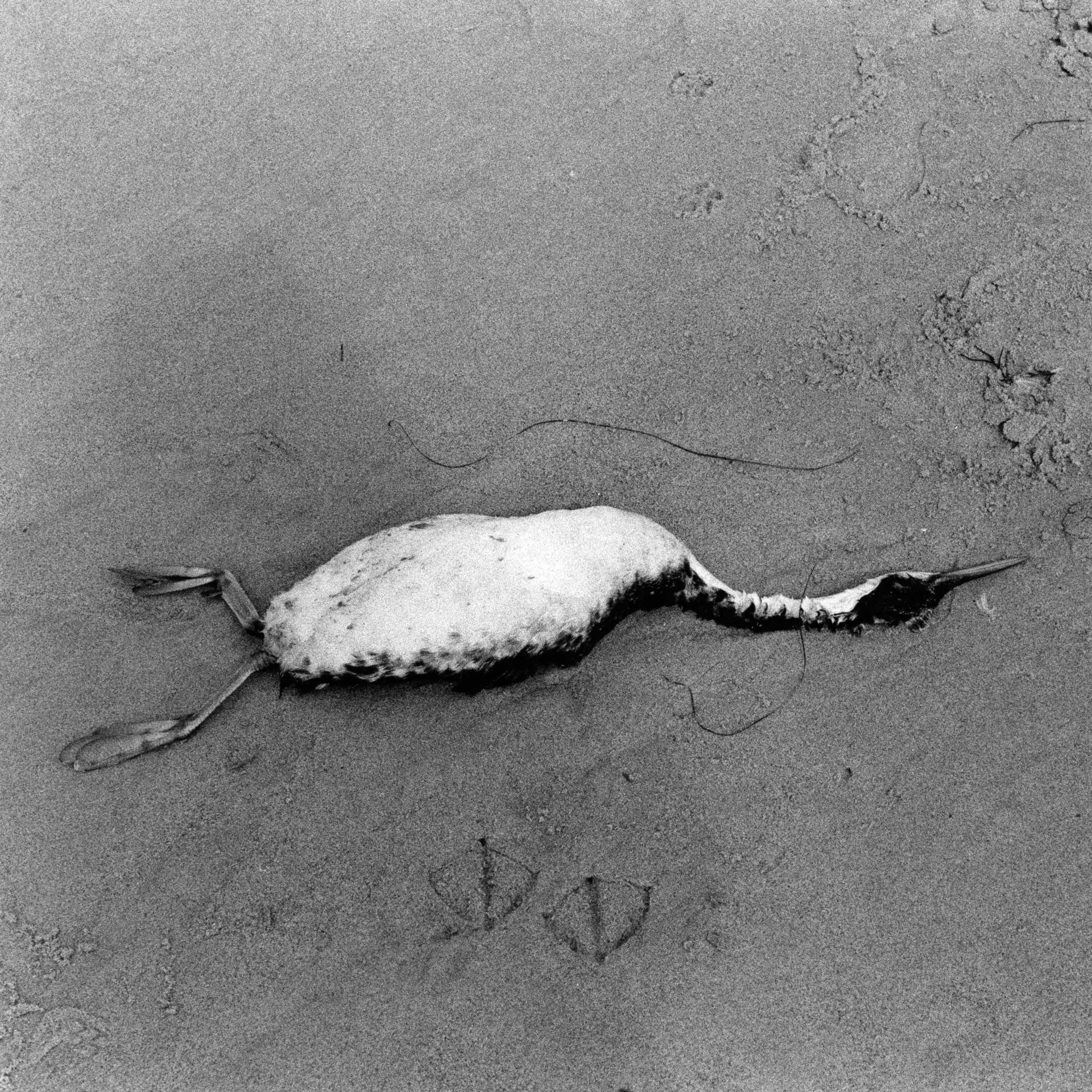

Scan of darkroom print. 35mm HP5+ rated at 160, Rodinal, cropped square.
This cropped print scan looks less grainy (considerably, to me) than the previous two presumably full frame scans. Both of the earlier ones look somewhat over developed to me, but that can be a result of more contrast in the scan. If they are, though, that will increase grain.
The apparent "grain" being the result of over-sharpening in the can makes sense.
I want to clarify my response to my image above:
"I think it is pretty grainy... compared to 35mm HP5 I have been using since 1984 and exclusively since 2017. I don't recall HP5 was that grainy."
Same process all these years... Jobo & Tmax Dev 24C, Componon-S lenses, Diffusion enlargers, Ilford MGFB paper , etc.
I just processed 25 rolls of HP5 35mm in the last two days. I'll see how they print.

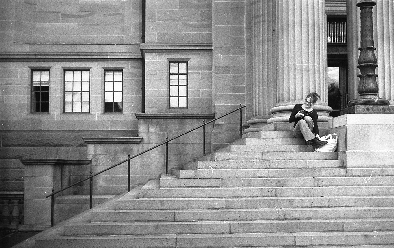

The difference between a low res neg scan HP5 (using D76 1:1 in a rotary processor @12 minutes 20C) and a low res print scan.
Yours looks slightly over processed.
Neg Scan
Print scan
