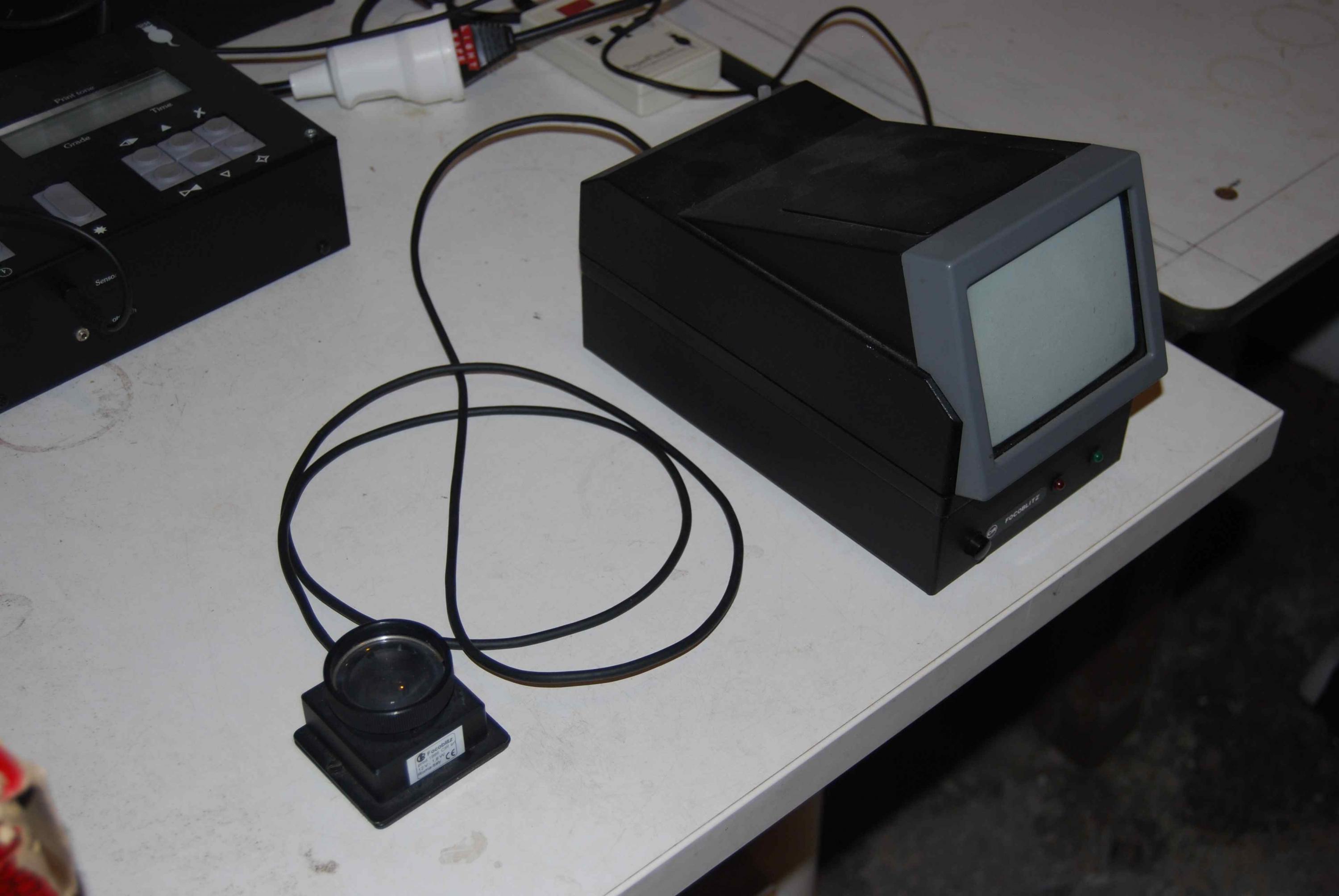

If , as I have , you have spent many hours tinkering with autofocus enlargers (Leica V35, Leitz Focomat 11c, and Durst DA 900 in my case), using a Focoblitz precision grain magnifier as seen in picture, you will have learnt that the only sure solution is glass top and bottom, As it happens I have AN on top and plain below but I haven't tried AN above and below, or plain above and below. Perhaps I am lucky but dust is not a problem for me. a squeeze of my blower brush suffices and if a spot appears a very fine brush and Martin's ink eradicates the irritation.
Richard
PS To learn more about the Focoblitz, type Focoblitz in the search box in APUG Home Page
