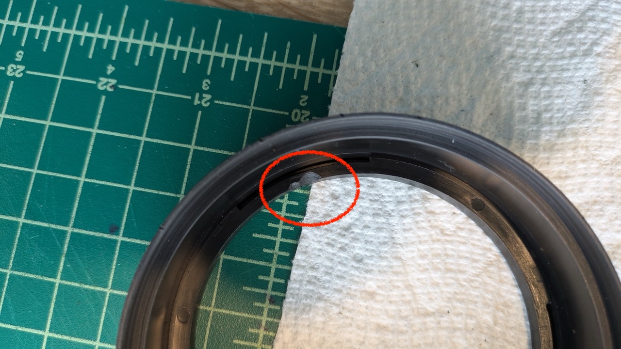

Recently I got a Graflex XL SW with a broken focus ring. It is a common problem for the Graflex XL system: the three plastic tabs on the plastic focus ring are easily broken and render the camera unusable. You can see the photo below. And on my sample, all three tabs were broken.

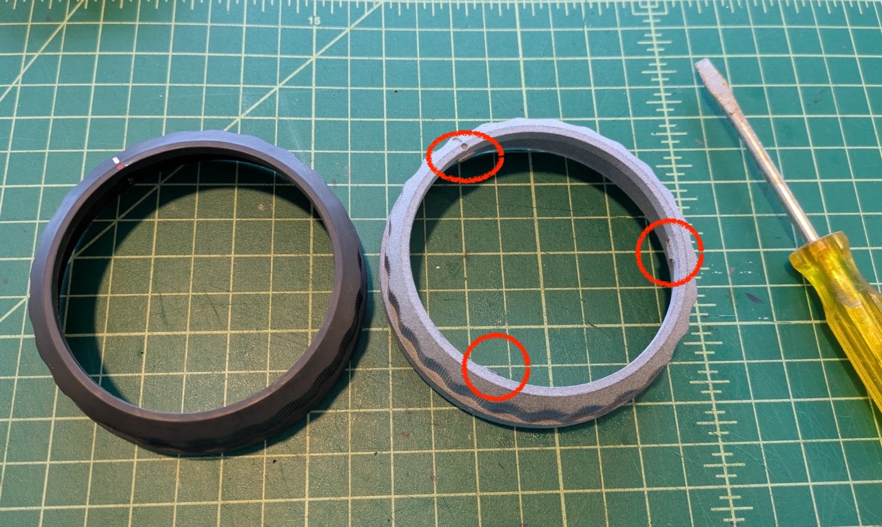

So I decided to test it out with the 3D printed version. Since my 3D printer cannot use nylon or carbon fiber material, I used commercial printing service (Xometry) and their Nylon 12 material. It costs about $28 each. Here you can see the old vs the new. The new light grey one on the right has those three small focusing tabs.

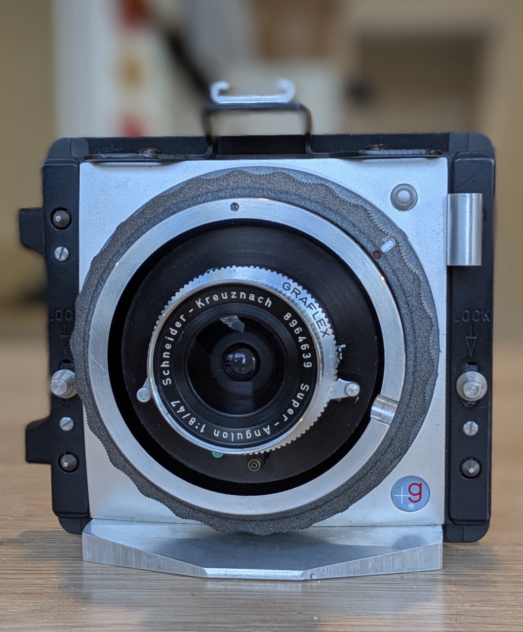

Since I have taken the camera apart before, it was fairly easy to remove the old focus ring and install the new one. In addition, I thoroughly cleaned the internal focusing tube and lightly lubed with helicoid grease. The new one is a bit loose fitting, while the old one is snug and very tight. But after some small adjustment, the new one seems to work well in terms of focusing the Super Angulon 47/8 lens. There is a little bit of wobble, so we will see how the photos turn out. But at least the camera is usable now. We will see how long it can last.
