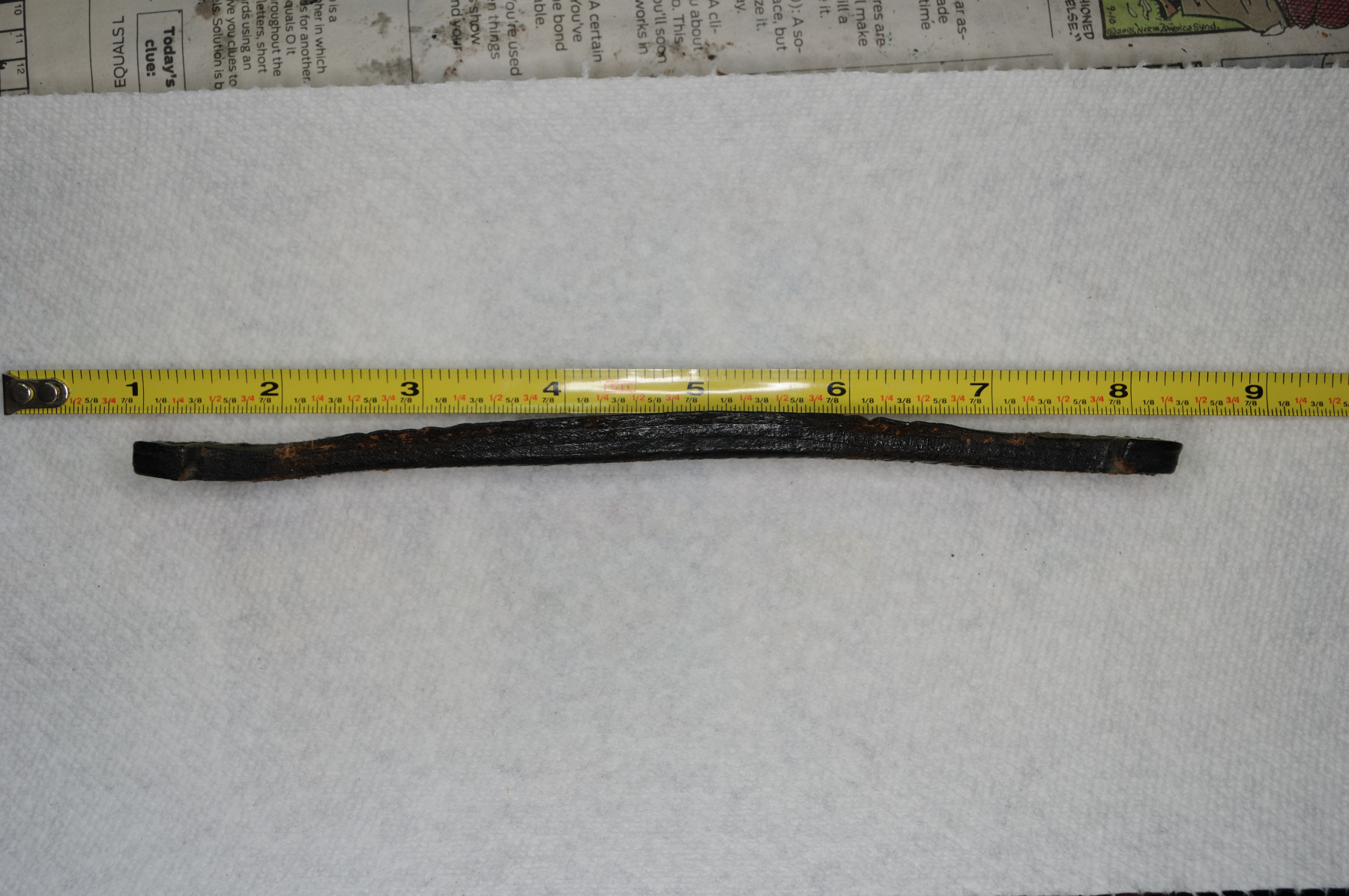

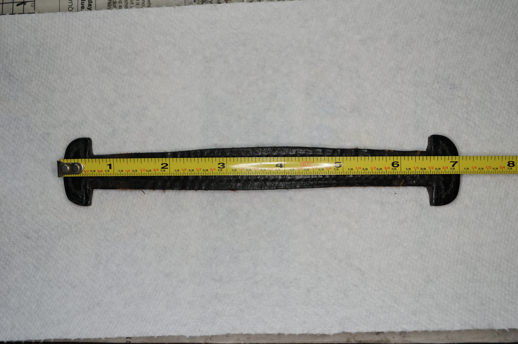

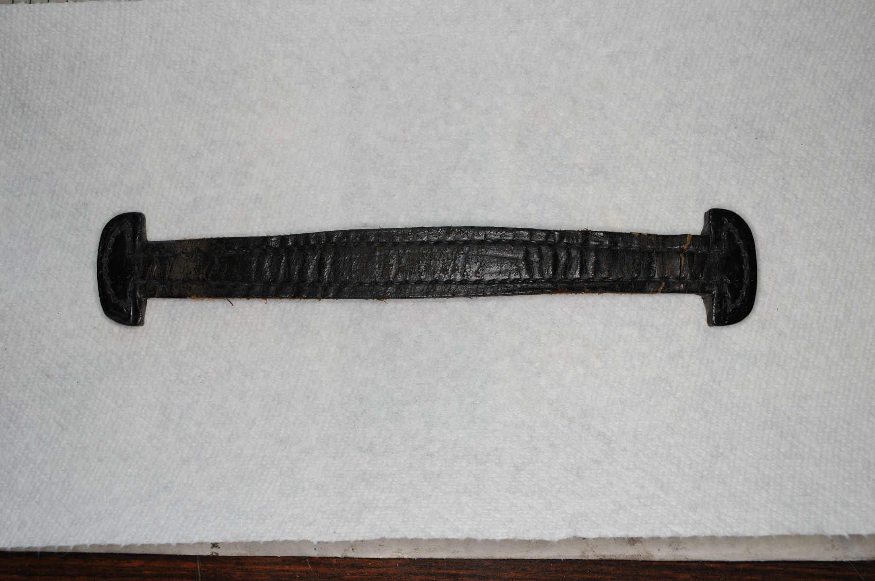

The handle is riveted on via straps at each end. Remove one lower view hood brace retainer bracket screw and loosen the other one 1/2 turn, pull the loose end of the bracket outward then slide the view hood brace from under the other bracket. The view hood should release from the view screen easily, sit the view hood in a safe place. Drill out the flanged end of the rivets or cut them off with a rotary tool and cut off wheel. Use a pin punch and drive the rivets out of the view hood door supporting it to prevent breakage. Save any parts of the handle retainer strap and the flat washers. I get leather scraps from a local Tandy Leather store and cut a new handle from scratch. The origonal handle has 3 layers, base, center that is shorter and tapered for the finger area, and a top piece the full length with all 3 stiched together. A single layer of 1/8 inch leather is adaquate. The retainer straps are pieces of leather that go over the handle and allow the handle to slide under them without allowing the flared ends to come out from under them.
Or try a premade luggage/trunk handle from http://www.brettunsvillage.com/trunks/howto/parts/handles/
A TH2 or TH13 may work.
Replace the rivets with #2 Brass screws and nuts and reuse the origonal flat washers.
https://www.boltdepot.com/Machine_screws_Slotted_round_head_Brass_2-56.aspx
They will need to be 5/8 inch long or longer cut down once installed.
Assembly of the view hood is reverse of removal.
