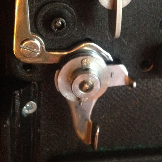

When you slide the I/T slider to I from T does it lift the M lever any?
To move the slider from T to I the M lever needs to be pulled back a tad to make it across. When the slider is moved from I to T it drops back down again. Maybe you can see the overlap of the levers better from this angle:
attachment.php
And now you have the source of the problem. The I/T slider should just fit under the M lever without having to raise it. Heavily used cameras may raise the M lever .001 to .002 inch / .02 to .05mm only because the M lever drops down further than it should but your cameras M lever is where it should be.
With the H lever removed does the I/T slider move easily?
Is the slider square to the center line of the shaft opening?
Does the pin hole in the H lever align properly with the pin hole in the mirror shaft? In your last photo the pin is in the bottom of the H lever and 10° to 15° left of center.
I cannot tell from the pictures what is off, if I had it in my hands I could. I think the slider is bent upward .1 to .2 mm to the T end.
I don't know what it was, but after taking it apart and putting it back together again this problem is gone. Perhaps it was just the way the H lever was set. Anyway, all is working now. Thank you so much, Shutterfinger, I surely would never have gotten this camera's shutter working without you
