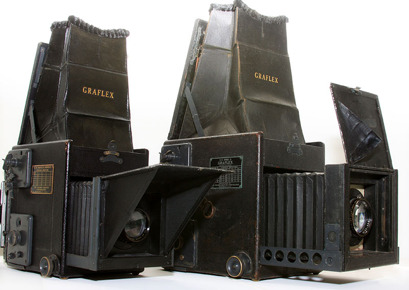

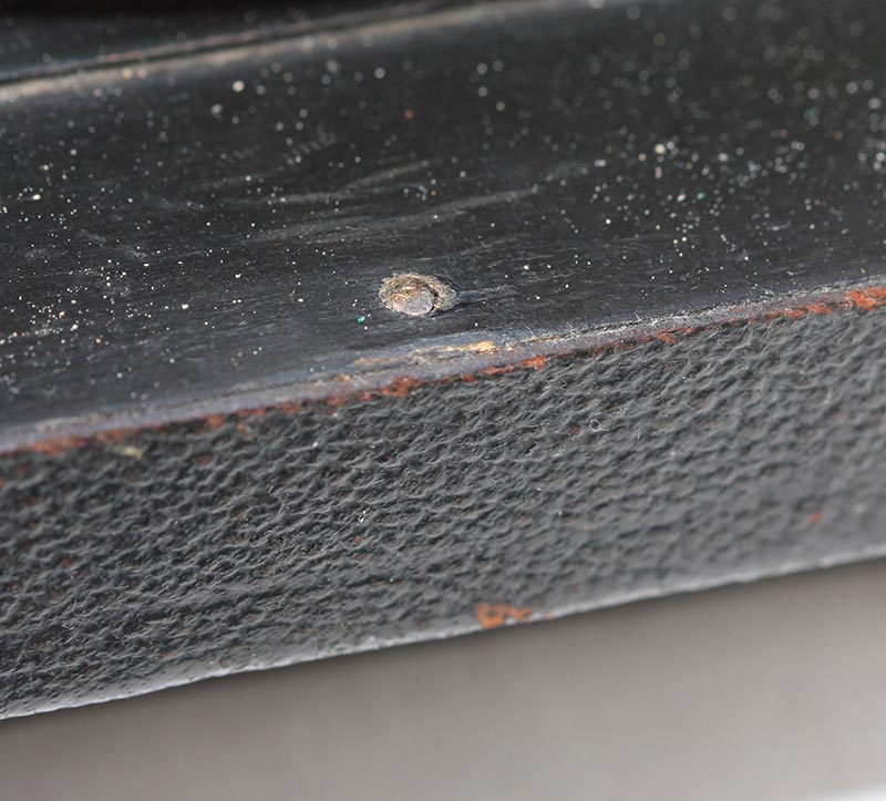

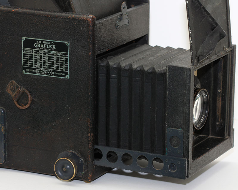

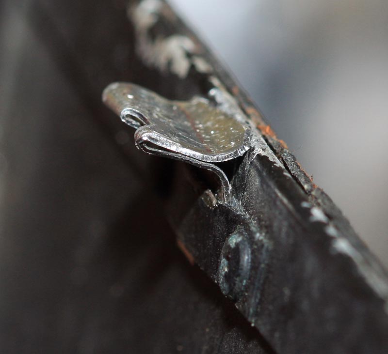

I'm trying to repair the damaged latch and shade curtains on this 4x5 RB-D (photo attached since there seem to be many variations on these things). There seems to be a missing metal hook of some sort on the door. And, there's a pin in the bottom of the front standard. Is the only thing missing the hook on top or is something missing from the pin? Can someone show me what it looks like?
I was going to make new curtains out of some black cloth and just glue them to the door and standard. Anyone have a better way to do this or will it work okay?
Thanks,
Dan

on mine ...
the flap that closes in front of the lens
had a piece of metal that was like a spring catch too
it latched by friction on a little nubby thing like yours.
(it broke off 10+ years ago :smile: )
the shutter is rubberized cloth with metal pieces around the slotted shutter holes.
fred lustig ( and his wife ) have the material and a die to cut and make perfect shutters.
if you don't feel like reinventing the wheel, you might consider contacting him ( fred ),
his prices are reasonable .. and he does very good work ( from what i have heard ).
you might be able to find a work-around on graflex.org as well ...
good luck!
john

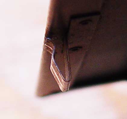

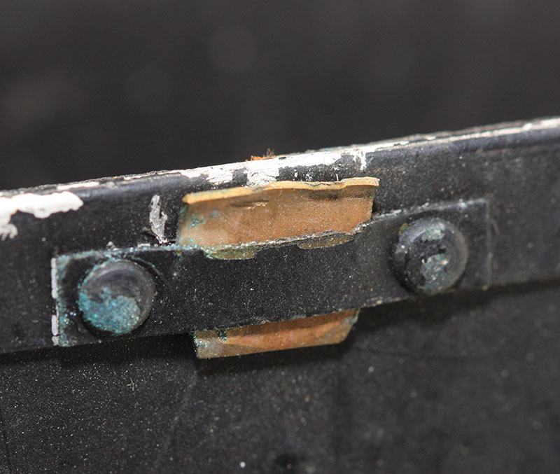

John,
I had a piece of .015" thick german silver (nickel silver - there's actually no silver in it - it's nickel and copper and some other elements in small percentages). Here's what I came up with lacking a template. It does work, but the doubled over section that hits the pin is too thick to spring up once the pin is lifted (ie, once the standard is retracted fully into the body). So, right now, you need to hold the door down while cranking the standard back the last half inch or so.
The shutter curtains on this camera are nearly perfect actually. They were filthy but after I washed them down gently with a little warm water they're clean and fully light tight, and the shutter works well throughout the range (although who knows how acurately). I'm not sure I'd bother with it if the shutter wasn't functional.
I'm referring to the little sunshade curtains on the front that keep the door from springing all the way up. They also seem to have some sort of a plastic coating on them - more like a shellac than rubber though. I see there's a bar screwed into the standard that holds them down on the bottom and on the top they're pressed/glued? under the sheetmetal lip on the door. I'm not sure I want to try prying that lip up and then reforming it so I may try just a bead of silicone adhesive. I'm not sure what material to use - maybe I'll contact Fred Lustig and see if he has something.

I also have a 3x4 RB-D to go with this 4x5. That one's in excellent condition in every respect (barely used it would seem). The latching mechanism is completely different from the 4x5 - I wonder if that's inherent in the 3x4s or it's a function of age. Also, the 3x4 is marked as a "RB Graflex Series D Curtain Aperture" while the 4x5 is simply a "RB Series D Graflex". If you come up with a fix for your bag mags it'd be nice to see.
