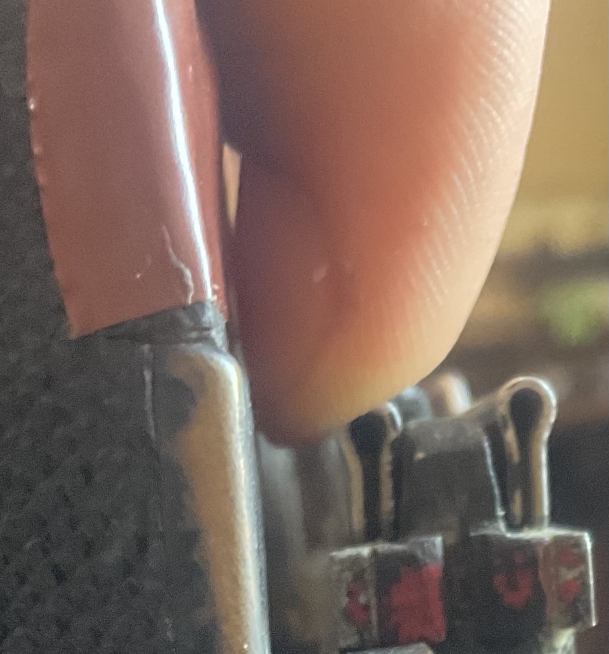

Just acquiered graflex series b, just to make small(comparing to 8x10) portraits, but I have troubles removing darkslide when back is in vertical position, not enought space for fingers to grab… I like the camera but i need it only for vertical shots… is it any better with bag mag,or graflock conversion?
How about using a piece of string (or a leather strap) tied through the center handle on the darkslide?
That was my first idea, it works, but I fear: 1)to brake darkslide by applying wrong angle;2) to accidentaly remove darkslide while it is not in camera
You know, I hadn't noticed how much of a pain that is. Haven't used my RB 3x4 with film either, so.... What size is your Graflex? The Grafmatic might make things easier, if you've got a 2x3 or a 4x5.
Alternatively, I don't think a leather strip or a hook would unduly strain the darkslides.
I think I just rotated the back so the darkslide faces down and it's easier to access. It's been a while, though.
Yes, in horizontal position is easy, but I just don't like the idea to turn it every time I need to make a shot...

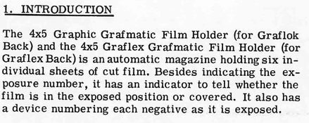

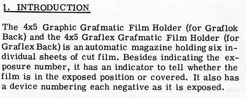

According to graflex.org, and the official service manual for the Grafmatic 45, there is both a Grafmatic 45 for Graflok backs ("Graphic") and for Graflex backs.
I admit, they're pretty rare.
I always get mixed up which Graphmatic is which and I can’t remember where I put my two Graphmatics to check my model number.
I think the 1268 is for Graflok, the models I have, back and 1168 is for Graflex back.
The 1168 one is the hard one to find and I don’t think they all had the model number on them.

The repair guide lists the 1168 as the "early" version-- but doesn't specify the back. Like you, I thought it was the Graflex back version.

No - I mean turn it to upside-down and pull the darkslide out downward. I'm not talking about landscape.

Having a international back, spring back or graflok back installed to use modern unslotted film holders will not help. You will still have difficulty removing the dark slide, the distance between the body and film holder does not change. Don't waste your time or money. Look for a bag magazine instead of the grafmatic. They are old and you might need to contact a tailor to make a new leather pouch. They work better than any grafmatic you will buy. 1 moving part, grafmatic backs are a waste, they break, get jammed and they have the wheel so all your exposures are spoiled.
Just use a key or coin to loosen the dark slide. Hardware stores have blank keys if you don't have one, I can't help you with the coin I have numismaphobia.
