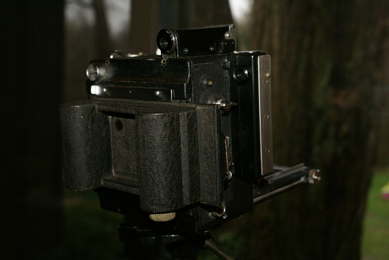

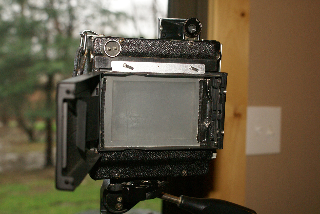

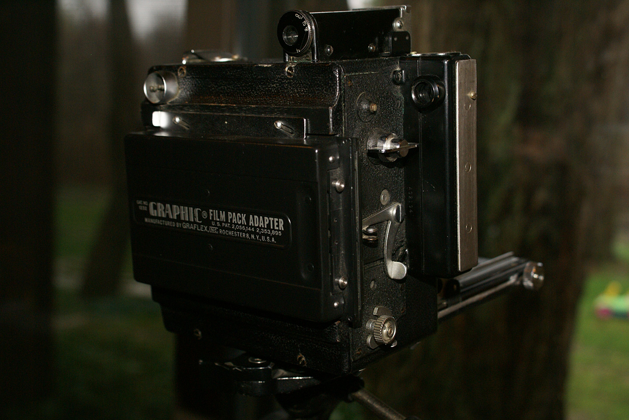

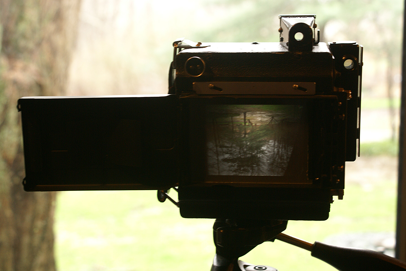

Adapting a Graphic Film Pack Adapter as a focusing panel for a Graflex back
It is two completely different systems.
1) Graphic Back
or
2) Graflex Back
I have a 2x3 Miniature Speed Graphic with the rare Graflex back, but no ground glass focusing panel. So I took a Graphic film adapter and taped a ground glass inside it were the sheet film would normally sit. Then I found a Suydam 120 roll film holder for Graflex backs. I shot a few pics last fall with this setup to check focus and it appears to be ok. The film plane and ground glass are in the same place. The Film pack adapter was easy to find. The Suydam roll film holder not so easy to find.
