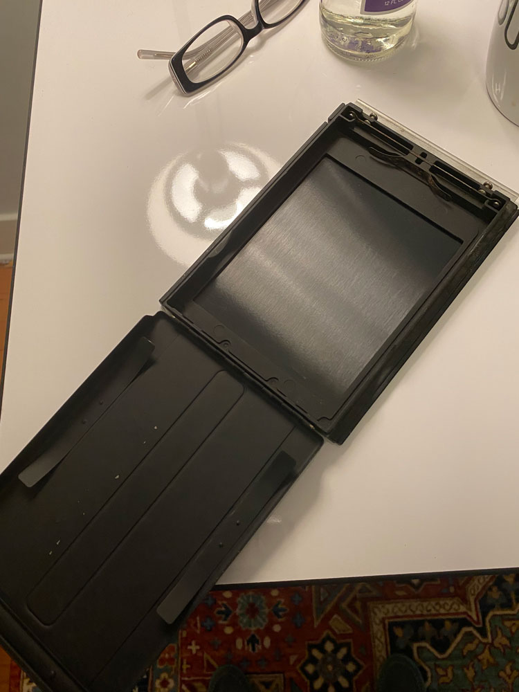

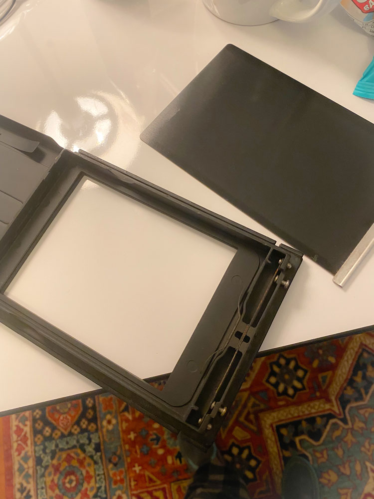

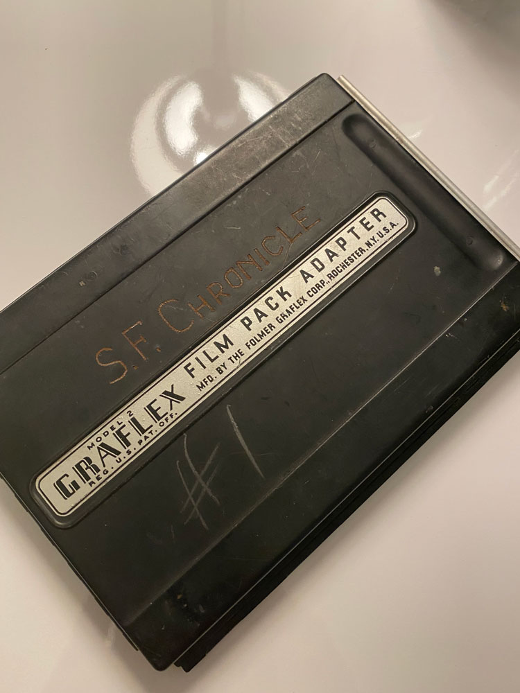

I came across one of these at an antique store here in Seattle. I’m assuming it’s one of those 6-sheet film holders but I don’t see how it switches between sheets. Is it missing something inside?

It’s missing thee film that came in a film pack that slipped inside it.
The film packs that these were made for haven't been available for quite some time. The film pack consisted of several thin sheets of film attached to a paper leaders and packaged in a tin cassette with paper tabs sticking out. After each exposure, you would pull the tab for that sheet which would pull the film from the front of the cassette to the back, leaving a new sheet ready for the next exposure. After all the sheets were exposed you would remove the cassette, open it up (in the dark), and process the film. Polaroid pack film operated similarly if you're familiar with it. They were a convenient way to have several sheets of film contained in a small package. But with some downsides, the film was much thinner than regular sheet film, since it needed to be flexible, and each sheet was actually slightly larger than its "normal" sheet film counterpart. So, special hangers were needed for processing, and then to fit most enlarger carriers you had to have a pack film specific carrier or trim down the negatives.
I've heard of people modding these for wet plate, but aside from that, unless you buy old film packs from ebay they are fairly useless.
What you have is complete, for what it is.
I threw out several but save one, which is convenient since I now want a removable ground glass with protector… and it seems that one of these will be perfect for that application.

This is a film pack adapter, which held a film pack, no longer made, like everyone said. The adapter may be useful for making a ground glass back and I think some people adapt them into plate holders for wet or dry plates.
The OP 's mention of "6-sheet filmholder" is thinking of the Grafmatic holder, which would have a stack of film sheaths and can be used with currently made sheet film.
And doesn't hinge open like that -- access to the film sheaths is by pulling the slide out the end (they're readily identifiable by the pull ring that's used to do this). I've got three, one with still functioning number wheel; they're the cat's pajamas.
