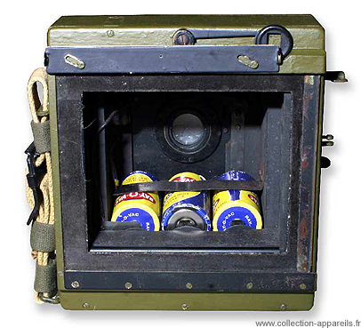

I'm sure I could have forced it in. But I encountered stiff resistance getting it into the leading edge, and I didn't like the way the springs were bowed, so I backed off. I'm not going to gorilla a 75 year old camera. Was bad enough to discover it had a set of (leaking) C-Cell Eveready batteries in it-- one of which had swollen enough to pull the retaining screws out of the inside of the camera. Fortunately, it didn't do much damage.

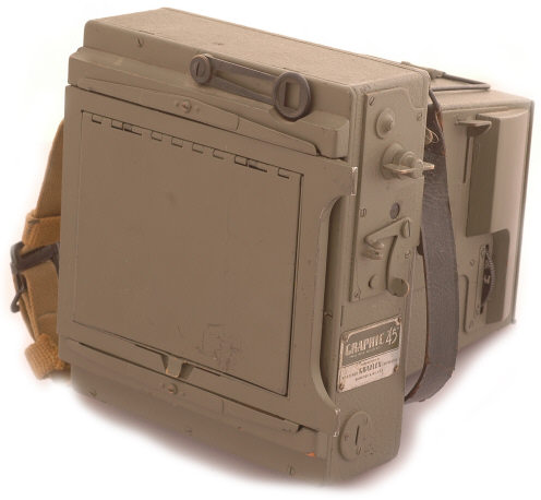

Here's someone else's with what I presume is a graflok style back:
And the back it uses is in this picture:
The back on my camera looks more like this one:
Although mine is olive-drab and has the Marine Corps plate instead of the civilian plate.

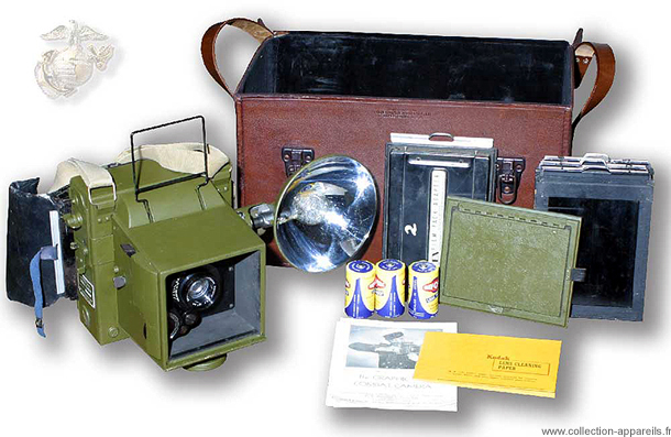

I'm also curious why the flip-up wireframe finder appears to be installed backwards-- in this picture, the frame flips down *forward*, and lays against the lens box. This one, the frame wants to bend backwards, and lie across the top of the back of the camera.
Finally, is that a button above the winding knob for the FPS? Mine looks very much like a button, but doesn't seem to do much.
FYI This is a Graflex back that takes the Graflex slotted holders. Not a one off form of Graflok back..
What you presume to be a Graflok is actually a Graflex back. First, Graflok didn't exist until the Pacemaker came out (after the War?), and second, Graflex and Graphic were the two back options for the Annie (which is what the Combat is based on). Graflex backs have the rib and groove to retain the film holder swapped from the (now more common) Graphic back -- that is, the rib is on the camera and the groove in the film holder. The single latching plate was, however, the inspiration for the double latching plate of a true Graflok back (which has the same holder retention rib setup as the Graphic -- rib on the holder, groove on the camera).

If yours is like the bottom picture then its a Anniversary Speed Body not a Pacemaker Body.
This manual https://www.cameramanuals.org/prof_pdf/c-3_graflex_camera.pdf covers it. C-3 was the military nomenclature for the Anniversary Speed Graphic.
Graflok sliders are angled inward at a 45° angle, Graflex slider(s) are straight. Late (1950's) Graflex backs had a slider top and bottom.
The bump above the wind key is the cover for the top roller shaft.
