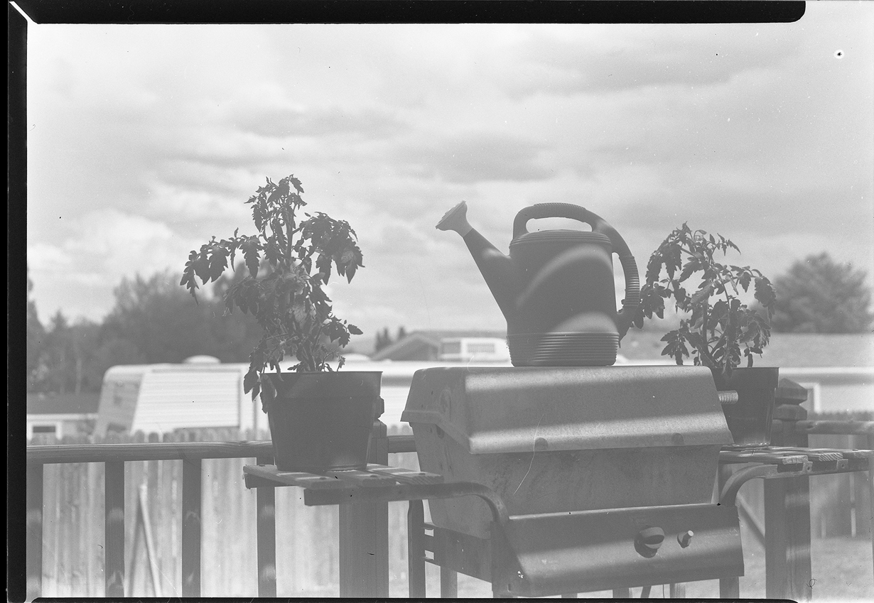

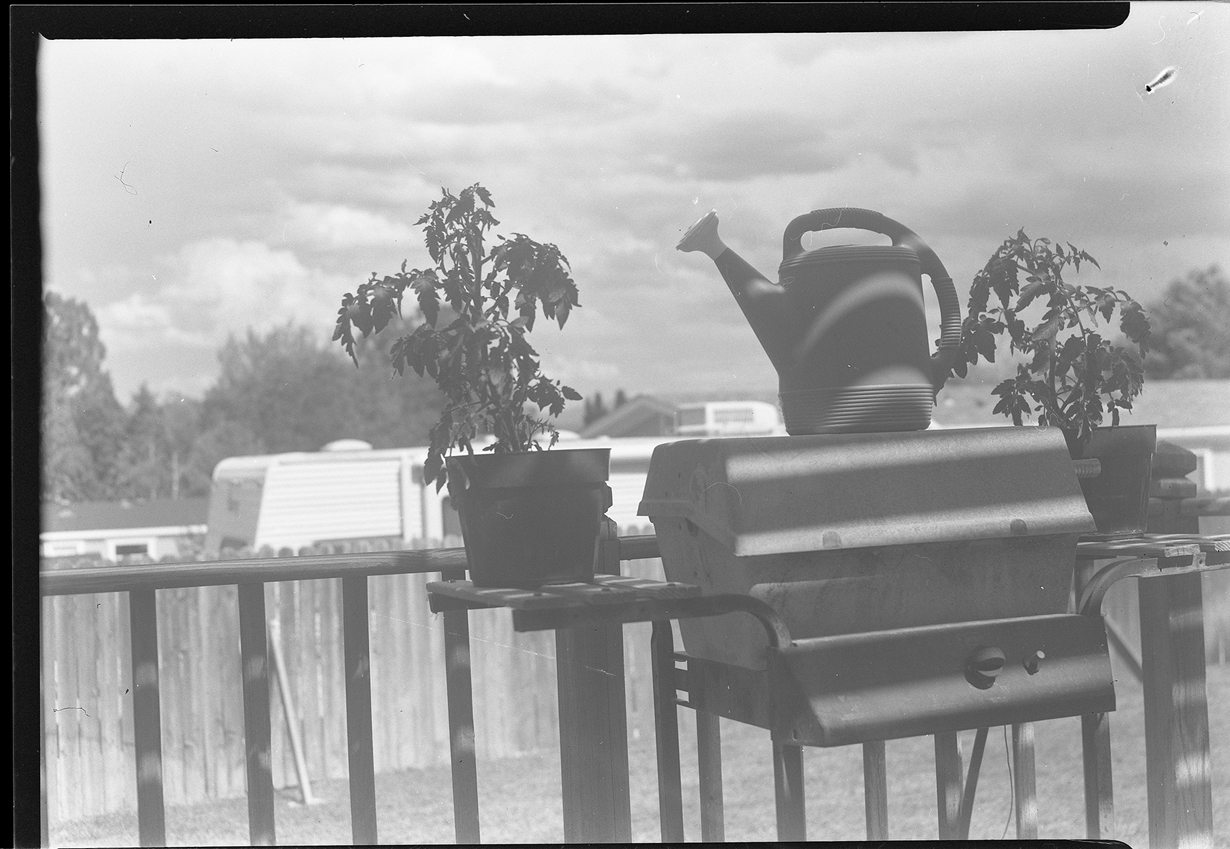

This was a check on shutter behavior. Sorry about the subject matter. I so suspect they will produce some delicious tomatoes though.
Two shots with the 2x3 Super Graphic and the 101mm Ektar lens. Shutter speeds and aperture were identical for both exposures. The lens is not coated. No filters were used.
Film was Ilford HP5+ developed in D-23 1+3. Scanned on an inexpensive Epson flatbed. Image rotated to horizontal and reduced for web viewing. Nothing else was done.
One was taken with the focal plane shutter and the other was taken with the leaf shutter. Both are low contrast which can be expected from the lens and from the developer.
Overall it is very difficult for me to see any difference so I have to believe the shutters are running pretty close. I will do some contact prints later on.
There were 2 more side by side images but one of them is a bit unsharp so I suspect I had some camera movement on one of them. I will put the camera on a tripod next time.
I'm going to clean the lens a little and see if I can find a yellow filter to help boost contrast. I'll try this again tomorrow.
I do think it is worth saying that these are the first two images captured by this camera for quite awhile so I am not terribly disappointed.
