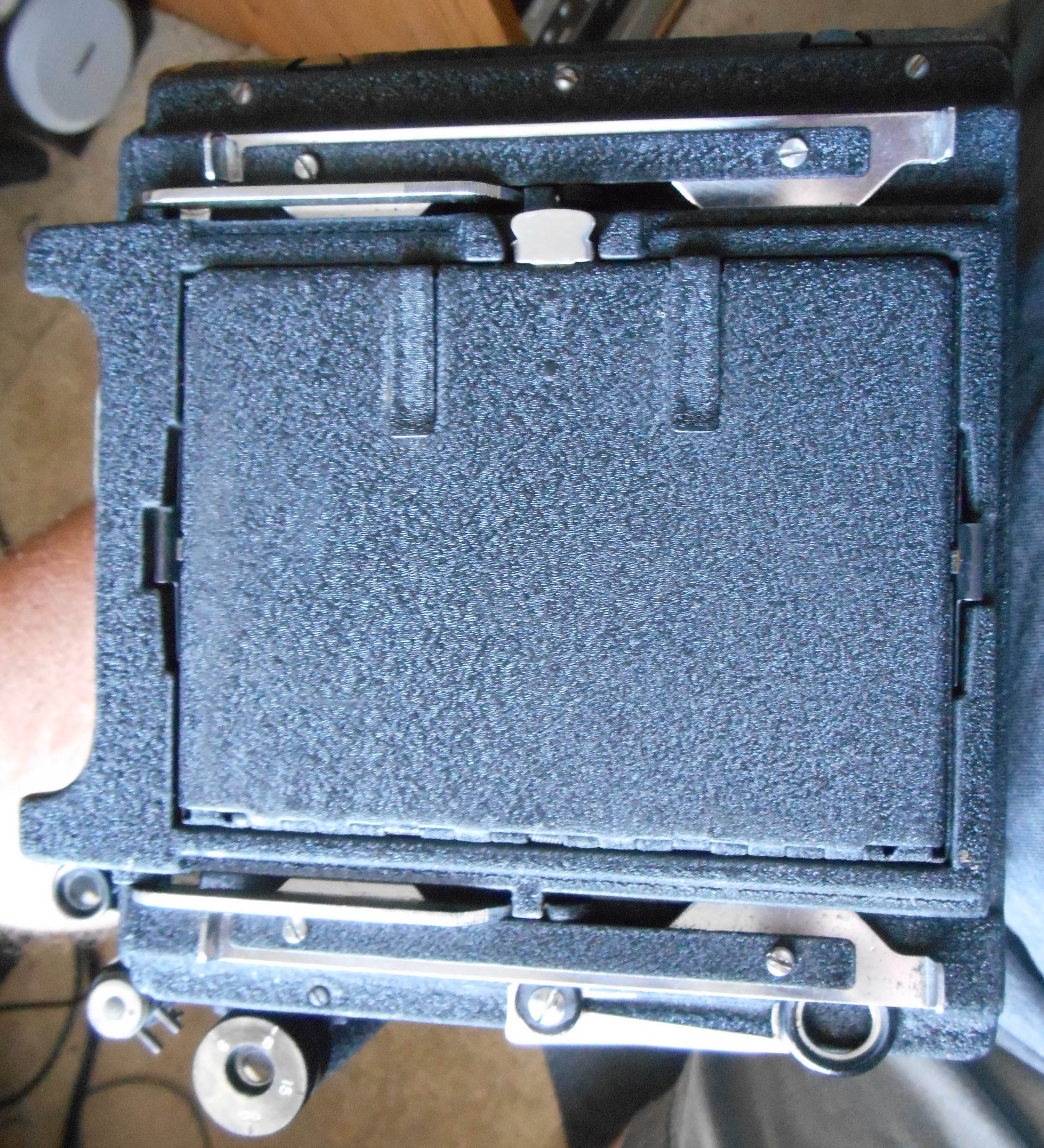

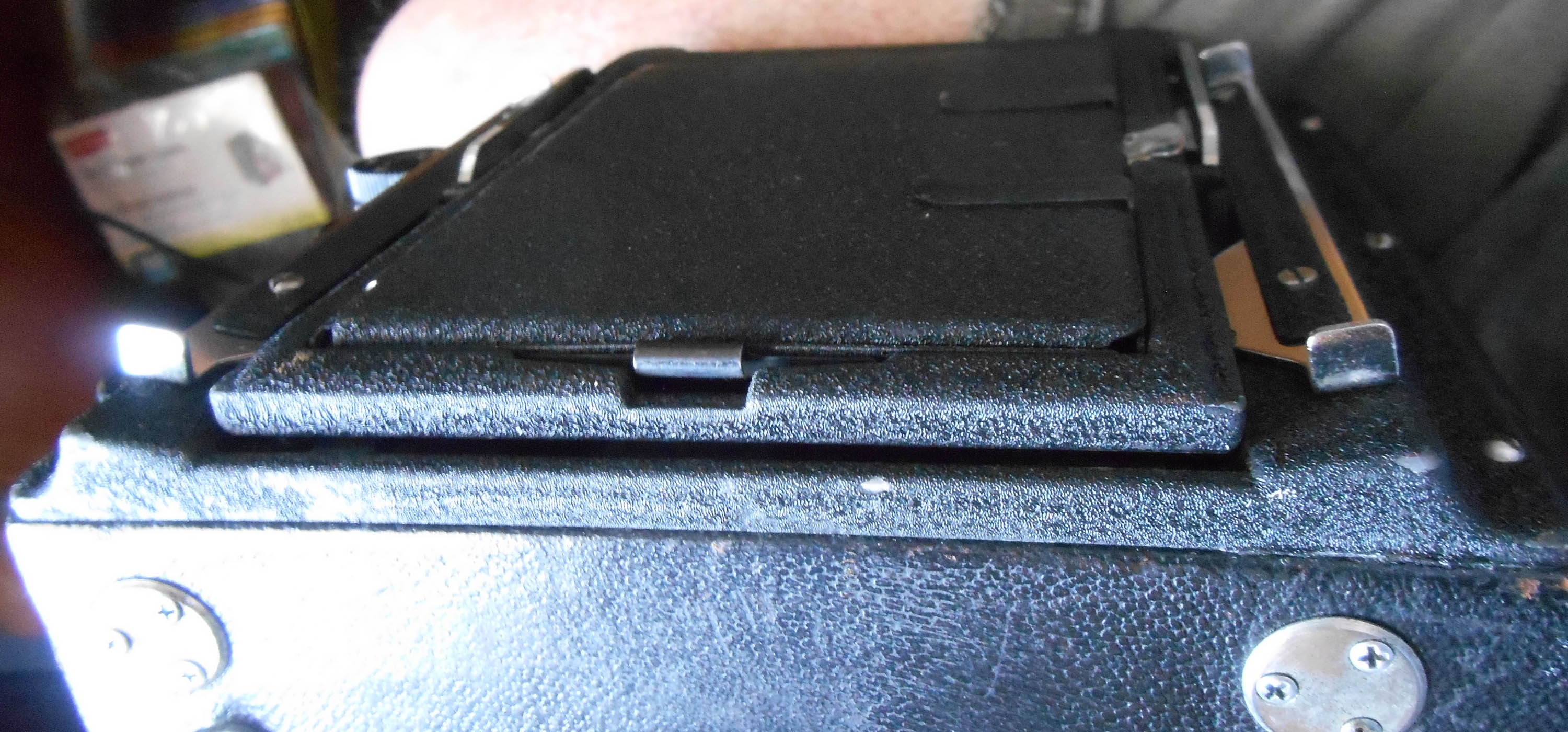

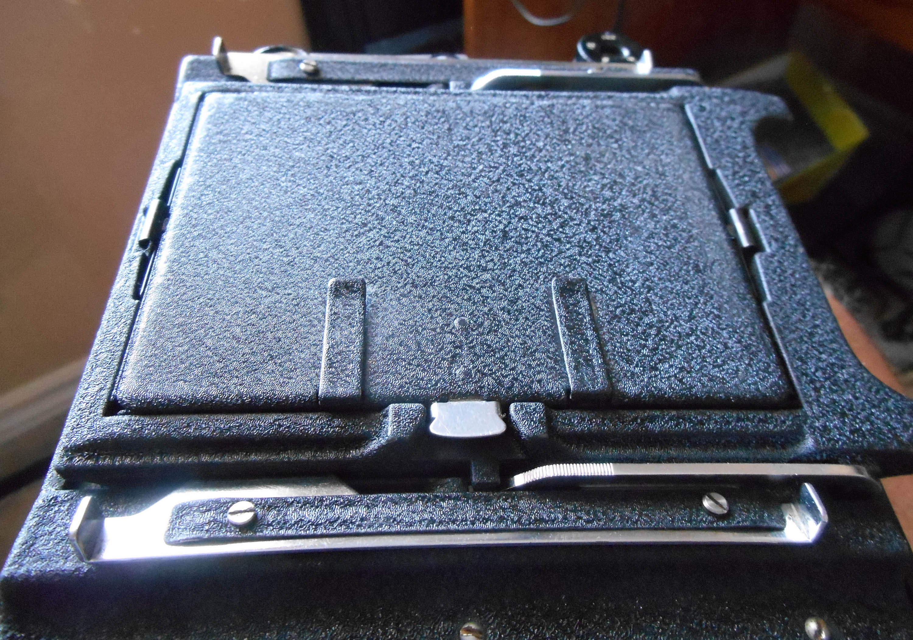

First off I already have a Graflex Speed Graphic 4x5 camera. Im not sure, but I think it has the Graflok back on it for 4x5. See pictures shown here for confirmation.

I can't really help on the 3x4 stuff, but your back is definitly graflok compatible. I'm sure that Graphic made 2x3 backs for the 4x5 cameras, but so have a lot of other companies--I have two Horseman 6x9 roll film backs that fit 4x5 graflok cameras. I assume they will work on Graphics, though i've only used them on Linhof, Sinar, and Arca Swiss cameras.

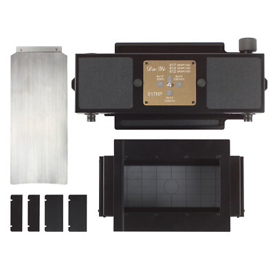

DaYi 6x17 Roll Film Holder for 4x5 View Cameras. I see this as an option for my camera. Now whether you can find one when Im ready to buy is in question. I see a couple kits on Ebay for around a grand Canadian.

OP, for a 6x17 roll holder to work on a 4x5 camera it must be mounted behind the camera's film plane. This done with an, um, extension tube. The added extension has several effects. It reduces the longest focal length that can be used. It increases the shortest focal length that can be used. And vignetting by the camera's own back reduces the range of focal lengths that can be used. If you want to shoot 6x17 get a 5x7 camera that will accept the 6x17 roll holder you select or get a dedicated 6x17 camera.
The DaYi has an extended back further away from the original film plane, as the ground glass attachment shows. They did mention lenses that could be used, but I only want wide to semi normal anyway. They said 90mm wide to 150mm (which) was on the long range as the max.

You have a Graflok back on that camera. There is a description of how to use it on Graflex.org, in short: push the chrome sliders at top and bottom to the further-out position. Then depress the chrome spring bars attached to the focus panel+hood. You can now slide the focus panel sideways a little and remove it from the camera. A roll film holder for 4x5 cameras such as a Graflex RH-8 will now fit into the space where the focus panel was, and you slide the chrome sliders "in" to secure it.

The way to shoot 6x12 in such a camera is to get a 6x12 back like DaYi or Shenhao. A bit primitive but fits the Graflok back attachment. 6x17 extension backs on a 4x5 camera is a kludge, like using an RV to drive around in a crowded Whole Foods parking lot.

6x12 camera backs using 120 film will fit a 4x5 Graflok back (Graflok is aka an International back) a 6x17 roll film back exists but will not fit a 4x5 back unless you first add a truncated pyramid to the Graflok back since THAT image is wider than a 4x5 camera is long. Some 6x17 roll backs work great on 5x7 "international" backs.
