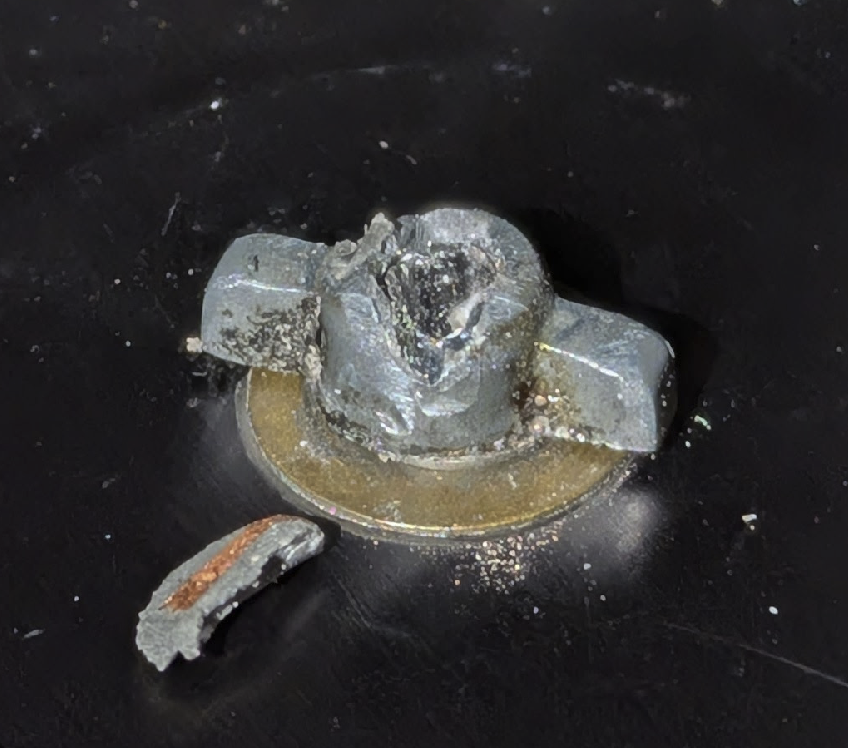

Hello all! It's been nearly 10 years but this post from 2016 was very helpful for me to fix my own Singer-Graflex RH10 roll film holder. Thank you @shutterfinger for your advice and @peter k. for your examples - both your guidance gave me the confidence to tackle this problem.

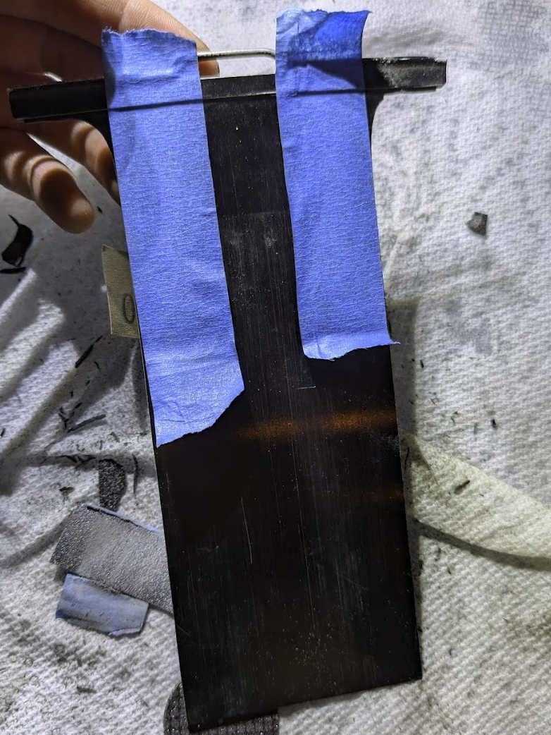

My issue was also a stripped wind key (Picture 1). Disassembly was too daunting so I opted to go with Peter K.'s method of fixing the wind key from the outside.

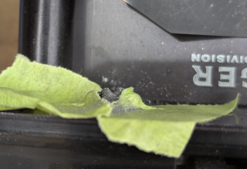

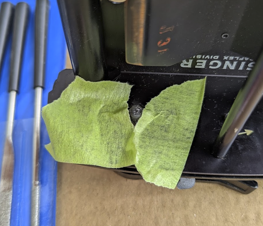

STEP 1 Taped down the "wings" of the key with masking tape to prevent rotation while I worked on it (Picture 2).

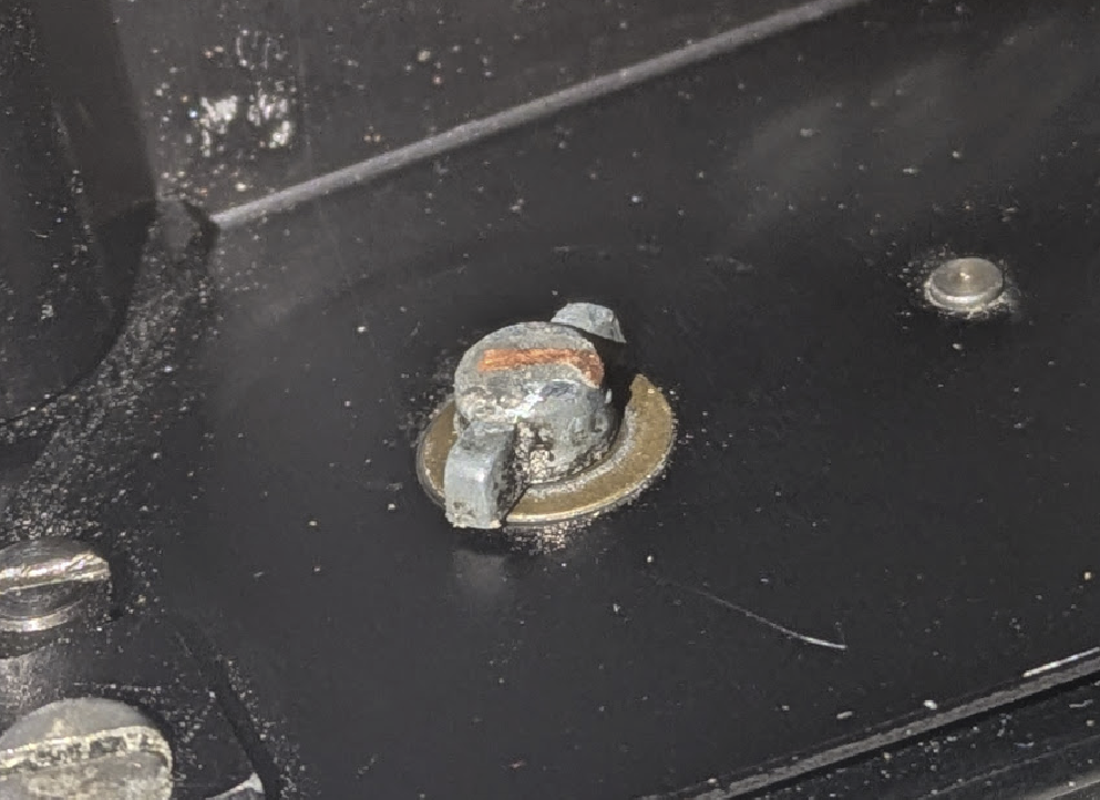

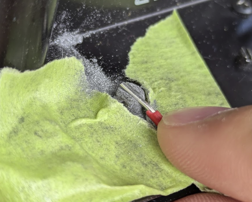

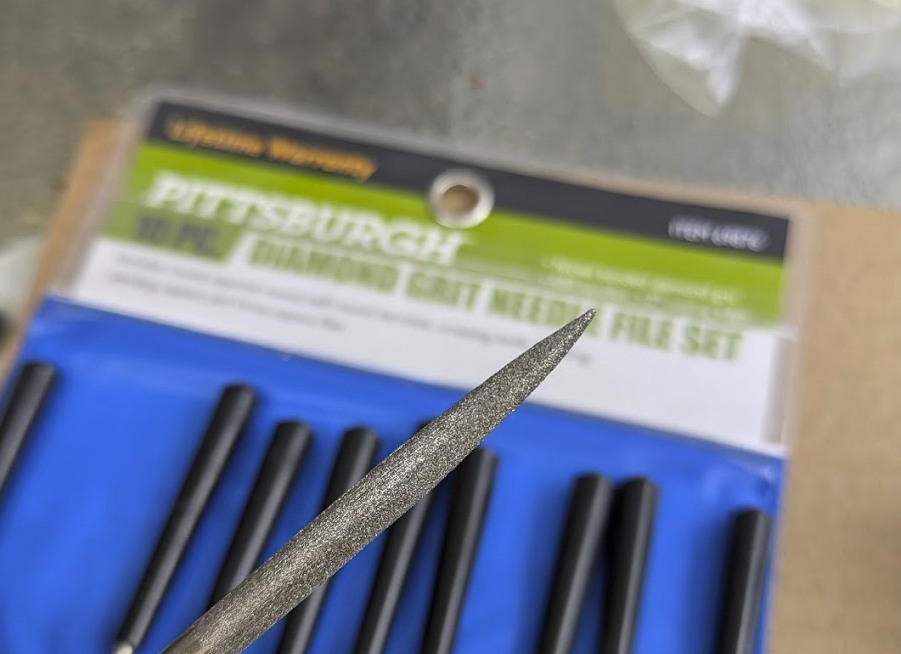

STEP 2 Used diamond grit needle files (a thin one and rounded bottom one) from Harbor Freight to sand a channel down the center of the wind key (Pictures 3, 4).

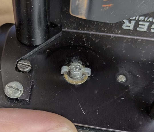

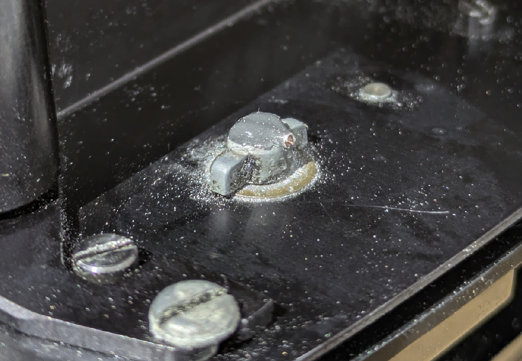

STEP 3 Sanded the channel until I had a sufficient depth to contain some 18G wire I had lying around (Picture 5). I stripped the end of the wire so just bare metal was present.

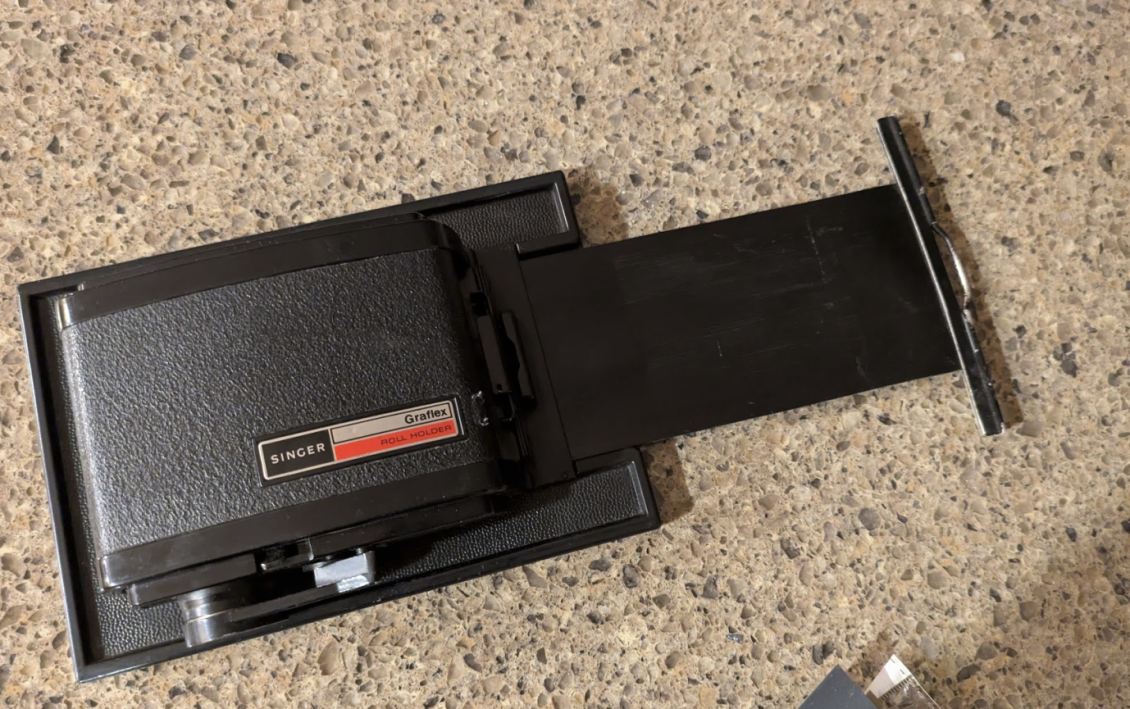

And there you have it! To verify that the fix worked, I put in a dummy roll of 120 film and it went through the adapter without issue!

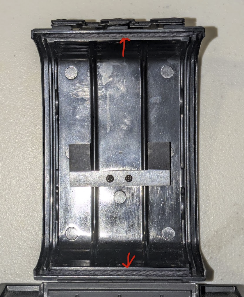

I replaced the light seals with some black yarn, gluing down with G-S Hypo cement (Picture 9). (For those who don't like black yarn, I've had previous success replacing light seals on all my cameras so far without issue.)

I hope someone can use these instructions in the future! I'll post sample photos once I've gotten around to using it with some film. Happy (developing and) fixing!

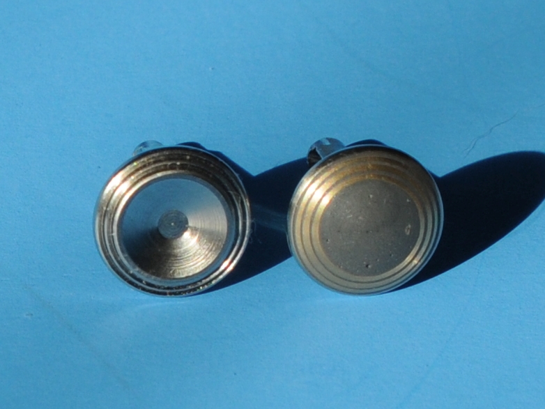

The photo is a Paasche airbrush trigger I filled with JB and then turned it on a Dremel.
