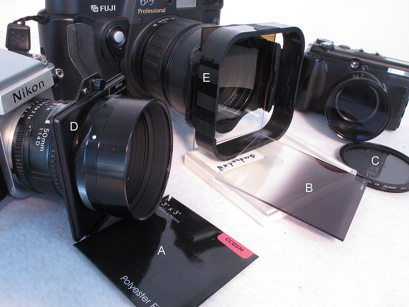

On the rare occasion when I use a 24mm f/2 Nikon lens for a landscape on my 35mm film camera, I may use a Cokin-type graduated neutral density filter (see middle filter in attached image).
Filters and Holders
by Narsuitus, on Flickr
