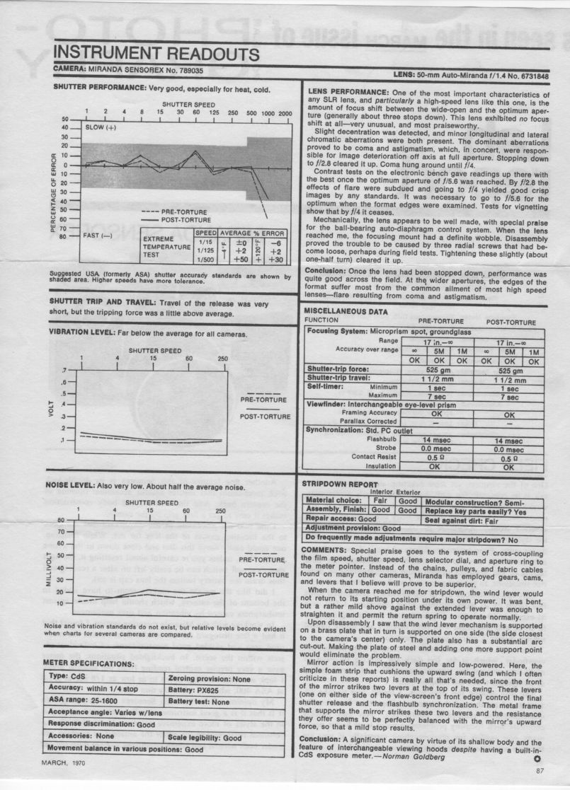

If you can find a service manual, I took one to my repair shop, just wanted a CLA, wouldn't even look at it. Best place to find them is at Shopgoodwill.com. I have not bought one for years, got most of mine years ago, so dont how prices have held up over the year. In terms of use, the EE is a nice camera, easy to use. Only issue with metering is that metering is really very bottom weighted, shooting verticals throws the metering off when in average mode., By the way it has both average and a 3% spot. My printer and scanner is not scanning right now, when I get around to fixing I will post a review by Pop Photo.
