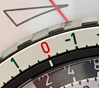

I have tested this meter, comparing grey card and real world readings from a Sekonic L758D, a Nikon DP12 on my F2AS and a Mamiya 645 Pro TL. It’s measuring 1 stop out.
- exposure compensation on main dial is on 0
- set to reflective not incident
- needle sits in the base green line when inactive
So the meter has a calibration screw on the back and the only way if been able to get a more accurate result is to meter on the grey card and then take the meter out of calibration. This means the red needle does not align with the green base line - see below.
Am I going to get weird values in different lighting conditions now I’ve set it out of calibration?
Is there a way of properly calibrating it so everything properly aligns?

This is from the manual - there is no picture to go with it, but (3) means the small green line on the left…
The needle is calibrated when it sits over the little green line on the left of the readout. When I put mine on the green line, by adjusting the trim put on the back, it underexposes by a stop.

That is not calibration. That is to zero the galvanometer. Unlike the modern digital meters, you have to send that in to service for calibraton.
I agree with ic-racer, the various Luna Pro meters, including the earlier Luna Pro not-F, have a screw on the back to set the resting zero setting. This is often mistaken for a overall calibration screw, but it isn't. If you set it off its zero mark, the readings may be off in some unpredictable way. The Lunasix F / Luna Pro SBC is a nulling meter, unlike the earlier models, which should eliminate some sources of error but not all.

The screw on the back is NOT a calibration screw; the meter needs serviced. It may not be serviceable. Gossen will not work on it; they do not support meters that old anymore. It likely has a bad metering cell and they're no longer available unless you can find a shop that has some old ones left. I had two old Gossen Ultra-Pro meters that I tossed in the trash for that reason. You have a Sekonic L-758D, one of the best meters ever made; why bother with old junk like this?
Make your determination as to whether it is serviceable by doing this: Meter a brick wall in full sun with the Sekonic and the Gossen. Then step into a shadow area and measure a gray card laying on the ground in the shade. If the difference between the 2 meters is the same number of stops inaccurate, the meter might be able to be recalibrated as-is. If one of the 2 readings (light and dark) is off unequally between the 2 meters, that is a sure sign of a failed meter cell. I have no idea if compatible replacements are available from places like Digikey, Mouser, or some place on the internet. A bad meter cell will ofter let you calibrate beautifully either in the bright light or a dark area. It's either-or, but not both.
Don't use the back screw to re-calibrate.
Use the other adjustments instead.
This one is particularly handy:
Check that the ASA/DIN dial is properly working and where it should be.

I would advise against throwing zero position out just to get it to match readings of some other meters. There is exposure correction on the dial, use that instead if you're sure you need to make such adjustment. The zero adjustment ought to stay on the green line, it's where meter's cell was calibrated for at the factory.

I picked up a PROFISIX sbc in a parcel of oddments.
Lovely meter, but slightly out.
It appears to have the same dial layout.
I agree with Matt regards using the compensation dial.
Compared it with a fairly new Sekonic and a couple of cameras.
For my meter I set the compensation dial shown in Matt's picture to -1 for reflected light, and -2.6 for incident light.
There does not seem to be any information on line to readjust these meters , so I have a reminder label on the meter showing the compensations required, and happily live with it.
