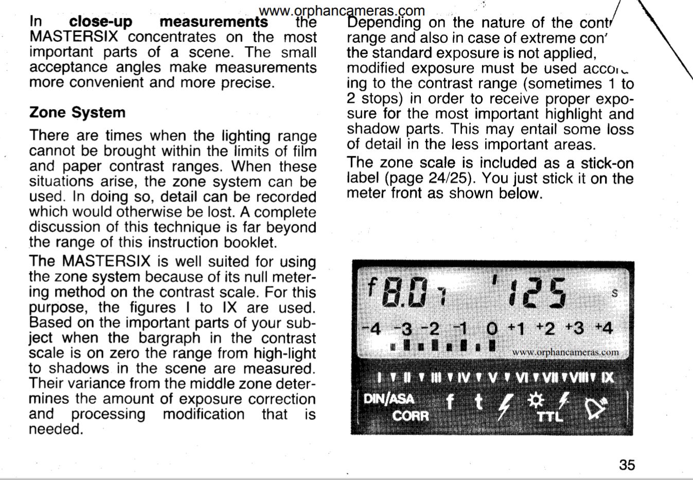

As for "luminance", without getting into semantics, all I care about is its application to ZS, and Mastersix came with Zone System sticker as standard, to be placed bellow display over existing markers. Same was available on SBC variant.

Not at all. You did not get my point.
The remarkable feature of Lunasix F and Profisix is to be able to place the subject luminance deliberately on the nulling scale.
The Mastersix does not yield this feature. I thus consider it a design failure.
Many years ago I bought used, but for too much money, a Mastersix, intended as upgrade to my Profisix, including this feature. This was in the early days of the internet when manuals were not yet online. But I was able to have a short glance at a shop into a printed manual, as you showed, got confused by it and erroneously thought that it would yield this feature.
